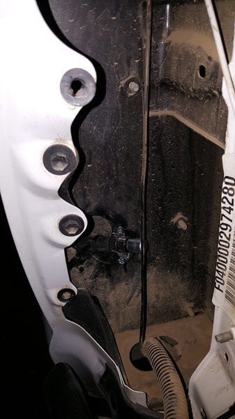

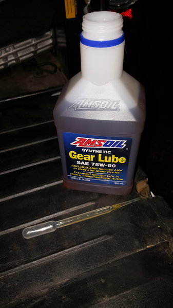

    I put a few droppersfull of lube into the fuel line I used to relocate, to catch any dust that might intrude thru the 2 way breather

    If you had replaced the stock breather with this, with the amount of crap hitting that area underneath. Would have maybe caused it to fail.
    I've done the breather re locate on mine, had the two way breather from toyota but now have swapped it out for a filter similiar to the one you've posted. I re located mine to one of the bin boxes where I already wired up a 12v outlet, So losing a bin wasn't a big deal. Plus its a little cleaner environment than behind the tail light. Especially since I spray that area and the truck with oil every year for salt protection :D
