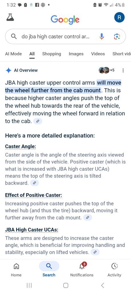

    I know this trend is old but just goingbto time in and say jba are the best control arms on the market and spc are garbage. For all those that say jba moves the wheel tords the cab is wrong they actually work the opposite and move the wheel away from the cab mount.

    Did you actually even read that nonsense? ("This is because higher caster angles push the top of the wheel hub toward the rear of the vehicle, effectively moving the wheel forward in relation to the cab.")
    I hope you will realize your mistake of trusting A.I. bots before you do something really dumb.
    Real human brains here: Adding caster at the UCA does infact move the wheel backward (though the movement is not near as much as the inverse movement is when adding caster at the LCA).
