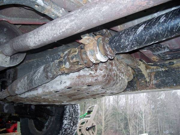

    I'll explain it to you now, but I will get some pictures up for everyone.
    If you follow the driveshaft up fron the rear axle to the u-joint in the middle of the axle, you'll notice a bracket mounted to a crossmember. this suspends the center of the axle. It (the bracket) is held on with 2 bolts. Loosen both bolts enough to leave a gap large enough to accomodate the washers you plan to add. DON'T fully remove both bolts or the axle will drop on your face! Remove ONE bolt, add 3-4 washers between loose bracket and crossmember, put bolt back and tighten. Repeat on other bolt.
    I can't remember if I used 3 or 4 washers, but they totalled about a 1/2". I didn't use anything special, just washers I had in my toolbox, all of the same size and thickness.

    Here you go. The left side of the picture is the rear of the truck.

    I see now! thanks man. But my vibration/grinding feeling, feels like it's in the front axle, did yours?

    Yes it did. I thought it was my alignment. I did this 1st cause I had heard of other people doing it and it was free. Coincidentally, it fixed the problem. I can't guarantee it'll fix your problem, but it's worth a try.
