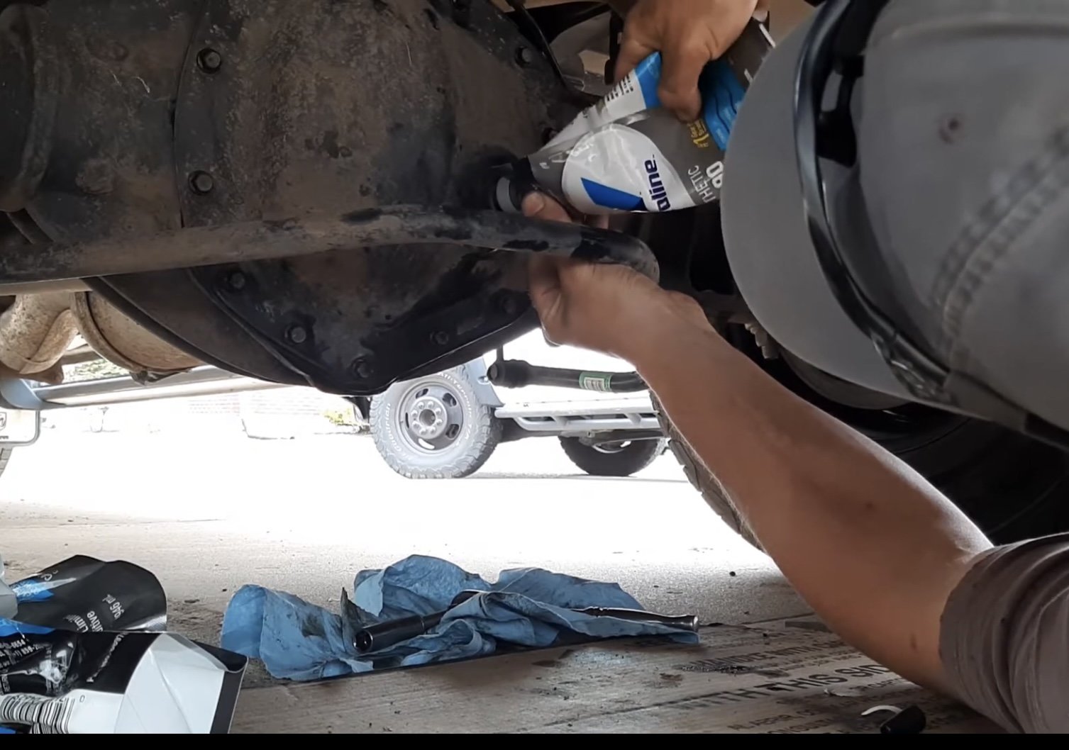

    As a few have said, squeeze bags 100%!! Done it with a pump setup before too but the bags are so easy

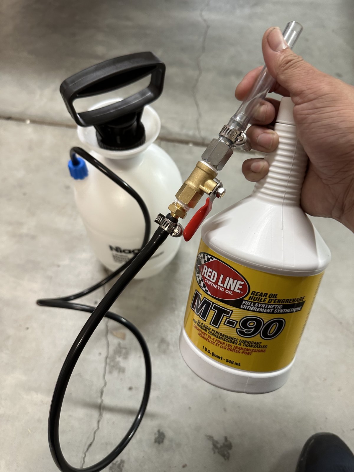

    I’ve posted this a few times in the past but $25 bucks and 10 min of your time can make the process of filling diffs/trans with whatever flavor of kool aid much better. Weed sprayer, ball valve, and NPT hose nipple. Fill with kool aid, pump, and let it fill your diffs for you.

    I saved that picture a while ago. I WILL be assembling one before my next service.
