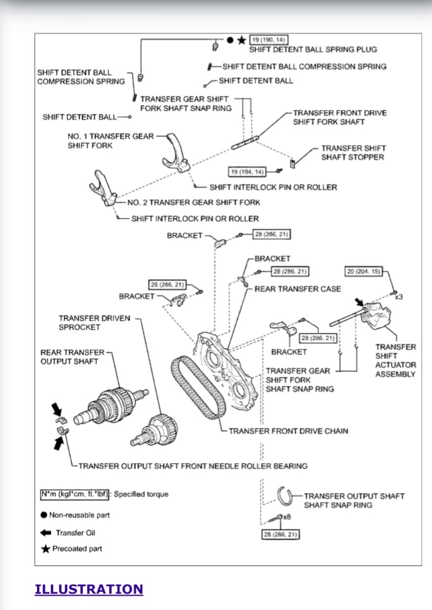

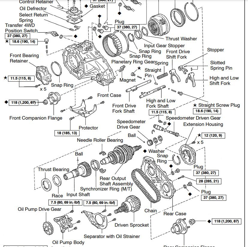

    "I would rather use something closer to spec" ..... GL-5 is the spec
    There are no snychros in the transfer case. Manual trans yes, TC no.
    That may be a to general statement. I know that the 2nd gen TC doesn't have them and the later gen also doesn't have them since they spec GL-5 which likes to eat synchro's... Other years/manufacturers i cant say.

    Is there enough brass to damage the synchro with gl5 I have no idea. Probably not and everyone who gets these done by a dealer ends up with 75w90 in their TC and probably enjoys a lifetime of usage. I think that goes to show how strong and robust these are. If you go too high in viscosity though, I can see these having issues shifting in cold weather.

    I stand corrected. And its what i like about this forum, i learn something new. I wonder if that one synchro rin isn't made of the same copper/brass material in manual transmissions. If you did happen to use GL-4 is should still be just fine. I looked at the owners manual and it doesnt even give a spec for their 75W TC fluid which is stupid. This is probably to scare everyone into using their overpriced 75W. In the video he states that this is indeed GL-5. Its way overpriced no matter what it is. The Ravenol 75W that they say meets the spec is a GL-3.

    There should be a synchro in all transfer cases in vehicles with the ADD. So 2nd gen should have it too. Otherwise there would be no good way to get the driveshaft from sitting still to spinning when you shift on the fly at 60 mph. Surely they spec GL4/5 because there is not enough stress going on in there for the GL5 sulfur to activate and eat the synchro in any harmful capacity. Especially with modern GL5s. Regardless, I run GL4 in the 3rd gen case and I’d do the same in a 2nd gen if I had one.
    The 2nd gen called out "GL4 or GL5" 75W-90 for the t-case up through 2014, for whatever reason in 2015 only, they deleted the GL4 part and then for 2016 of course they started listing the newer 75W fluid which isn't officially a GL rated fluid.
