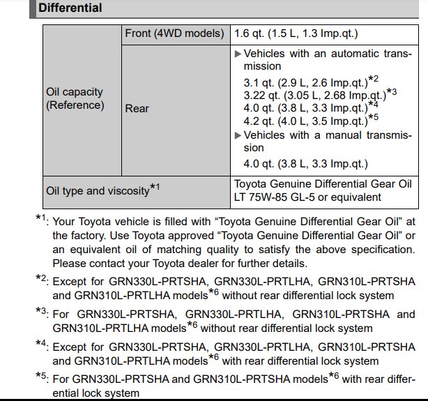

    2020 SR5 4x2 2.7L Auto. Just changed my rear diff today at 36k miles. Easy and fun little DYI.
    Bought 4qts Valvoline 75w90 squeeze bags and got concerned that after 3 qts it seemed it was already right at full.
    Stupid me, went ahead and squeezed the 4th bag in and basically just let it overflow into my drain pan.... THEN I read the owners manual re: capacity - doh! Looks like I only require 3 qts. Live and learn.
