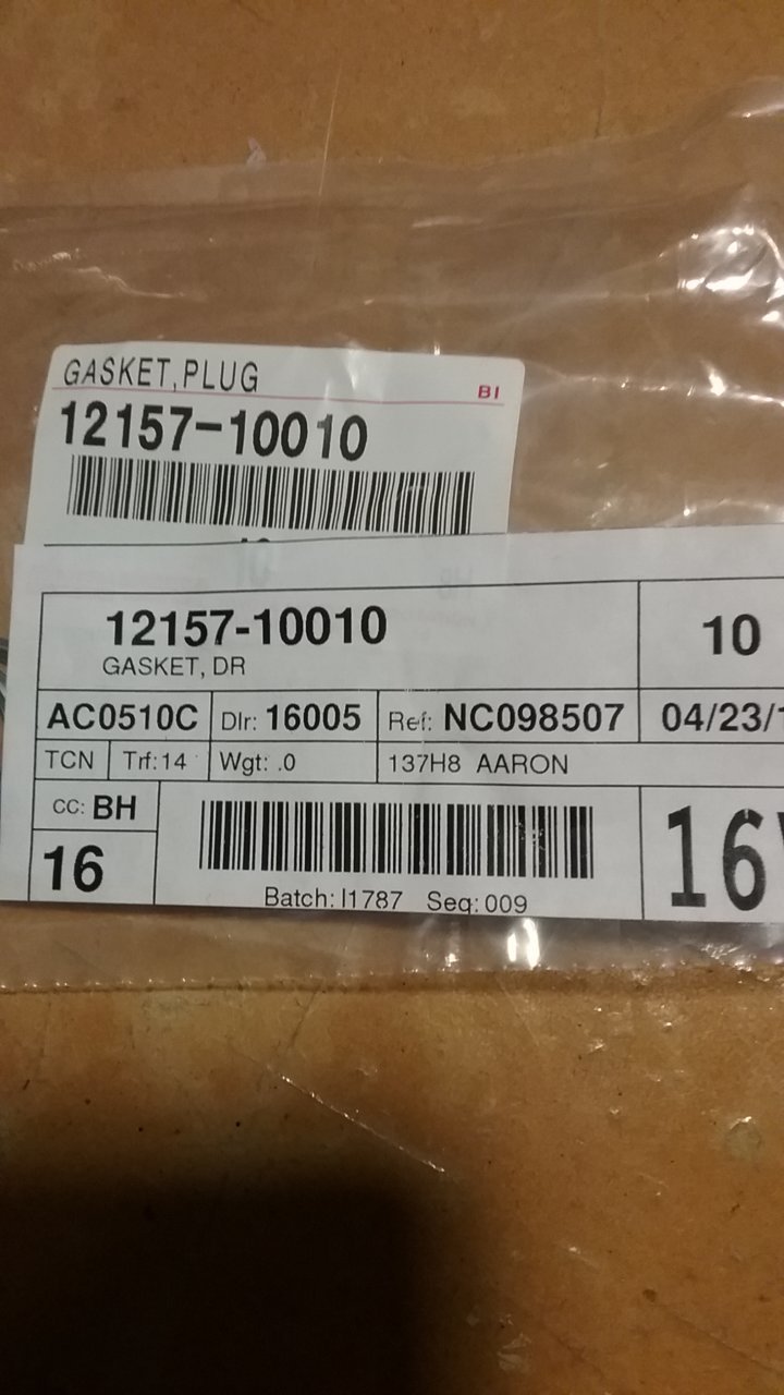

    Here's the gasket part number. Get 2 of them.

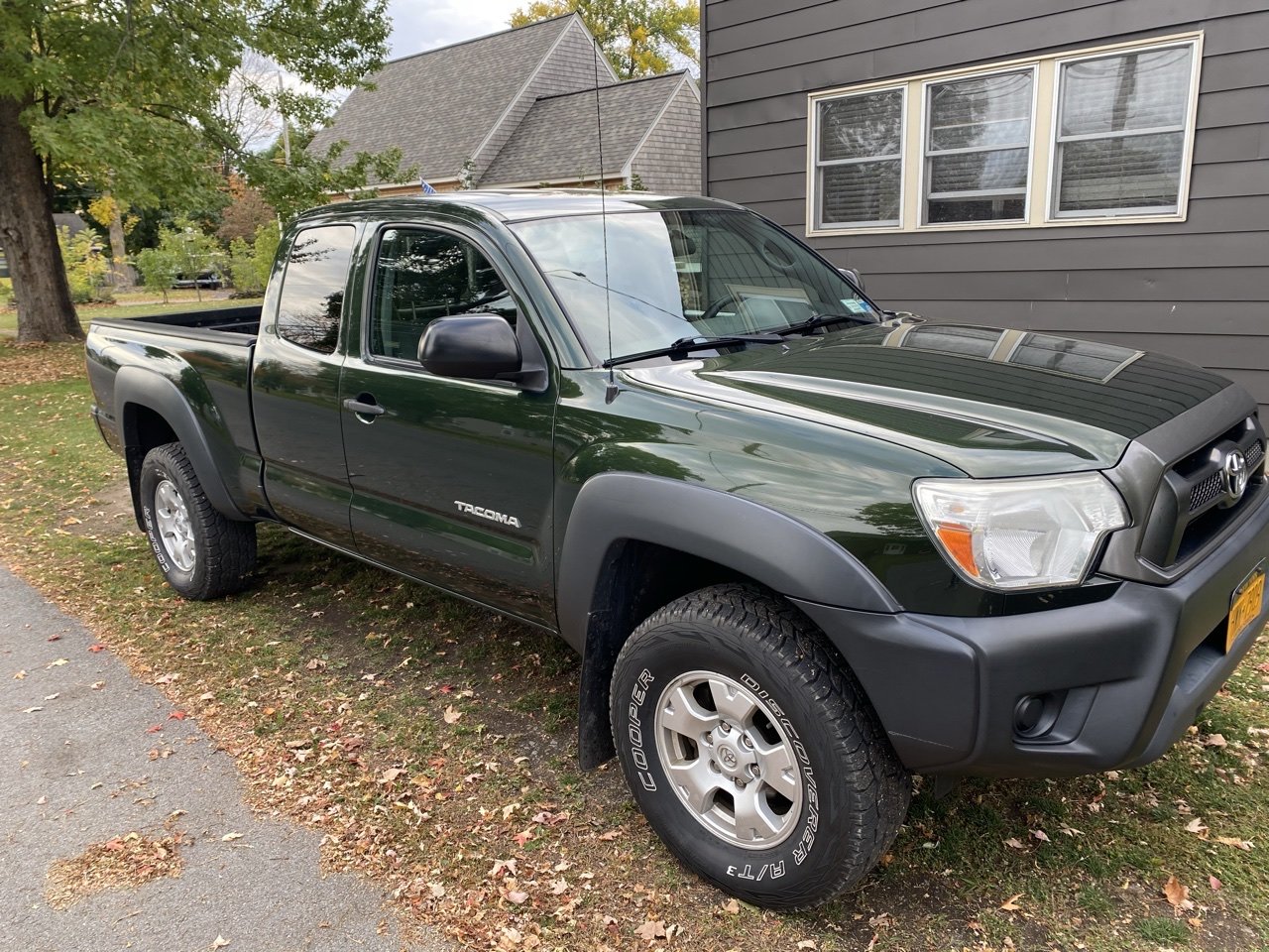

    Great forum, I have much to learn about my new love of a 2012 Tacoma 4.0 ext cab.

    Nice looking truck OP!

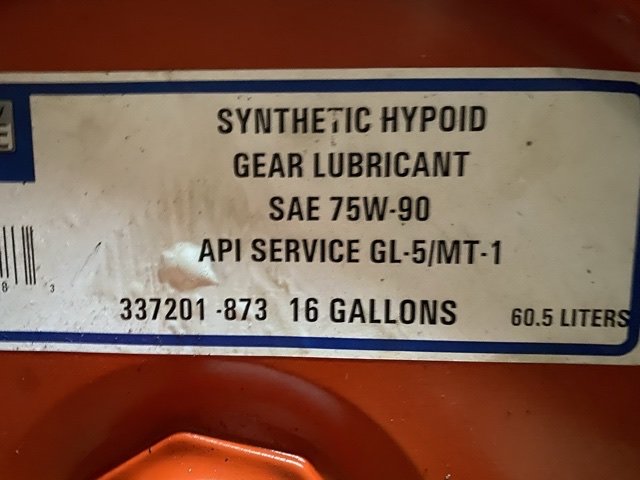

    What about this stuff?

    It meets the spec. Looks bulk, just curious which brand is it?

    I will check again tomorrow but I think it’s Shell or maybe Citgo?
