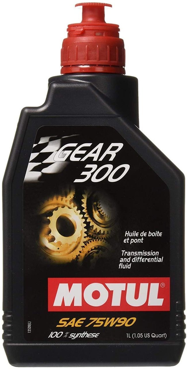

    Call me crazy, but this French gear oil, which is readily available on Amazon, has been treating me well. I find everything runs a little quieter.
