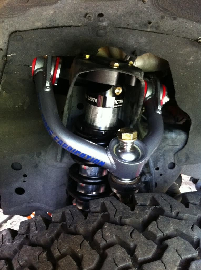

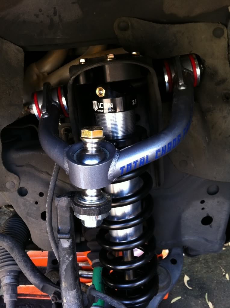

    I have the Longer ext Travel Icons with Total Chaos Upper arms and LOVE IT!!!!!
    I have them about 5 inch lift over stock and they ride amazing.
    The pics below are at the 2 inch lift or so, How they come stock which is about where my old 5100 billys were at the top notch groove the 2.5 inch lift over stock.
