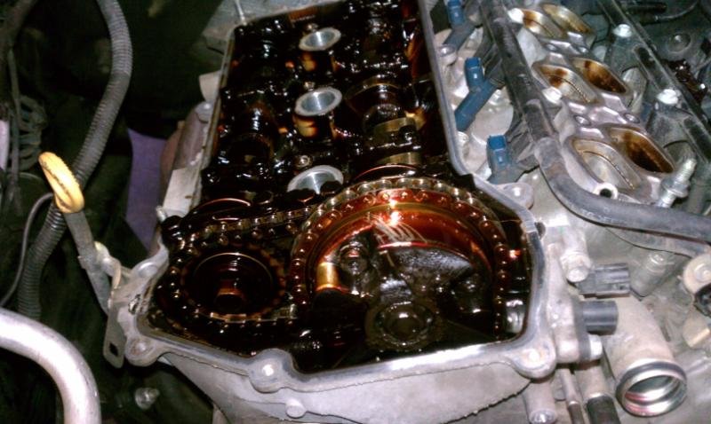

    Hi. Does anyone know the diference between these two VVT-i? or camshaf gears. Both pictures are from 1GR-FE engines of Tacoma trucks.
    It is possible to swap them?
    Thanks for the help

    Can I replace the one that has the star like shape with the one that has the flat surfaces or do I need to replace the ECU to do this?

    You can't just swap them. The bigger gears are the vvt-I actuators which are controlled by oil pressure. So the smaller gears don't have the oil passages needed. It would also be a major clusterfuck for your ECM. Definitely not recommended. Maybe they sell aftermarket cam gears with a modded ECM that deletes the vvt-i, but I wouldn't touch it.

    i think hes talking about the two main sprockets off the intake cams. the two sprockets that are connected by a single chain to the crank.

    The part that is different is the front metal piece attached to the camshaft sprocket. As you can see, in the bottom picture is like a star with 3 spikes and the top picture is completely different.
    The reason I want to replace them is because i have a check engine light on with P340 code on it. I have replace the camshaft position sensor, replace the timing chain, run a direct wire from the sensor to the ECU, replaced the ECU and the light still coming on. So the last thing to do is replace the gears according to the manual.

    as long as they dont hit anything give it a try, the star ones look more like a proper cam position sensor plate... tops ones i dont even know how the hell they would properly tell the ECU the cam position.

    Going to revive this thread to add in the accuracy of of information. That first picture is of one of my engines. Lol.
    The difference between the 1GR VVT-I actuators of year models 2003-2004, and 2005-2015, for the SINGLE VVT-I 1GR (NOT the dual VVT-I 1GR) is their pick-up design. Visually obvious in the two pictures.
    The first picture is what the intake cam gears look like, on the '05 Tacoma to '15 Tacoma. The sensor which reads it is different from the sensor on the '03 - '04 4Runner 1GR, which is in the second picture, the the tri-point pick-up. Ninja star.
    Mechanically, the cam gear sensors will swap perfectly between timing covers. Proper sensor must follow the proper intake cam gear.
    Therefore, if you swap in an engine which has the style different from what your vehicle came with, then you MUST SWAP the INTAKE cam gears over.
    I have done it. They are interchangeable.

    Hi I'm having this exact same problem right now and it's driving me crazy! I have an 06 tacoma and put in an 04 4runner engine thinking it was the same thing. This is were I'm at with my problem.. did swapping the intake cam gear work for u?

    Yes it did.

    Here are some pictures of what I went through.
