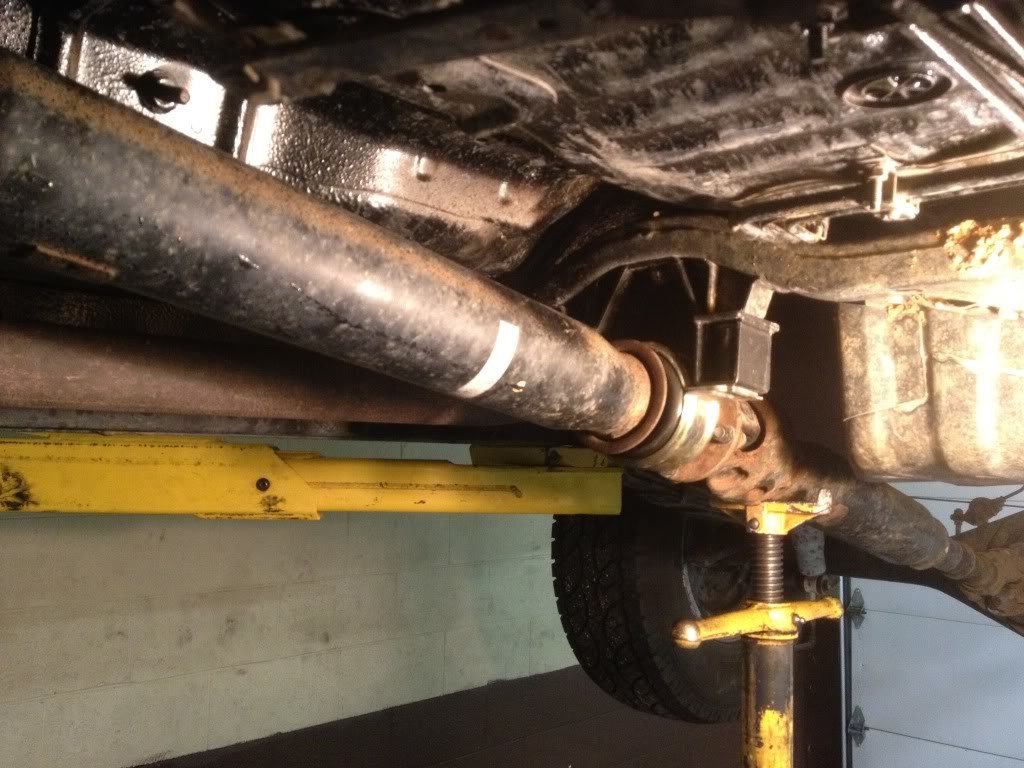

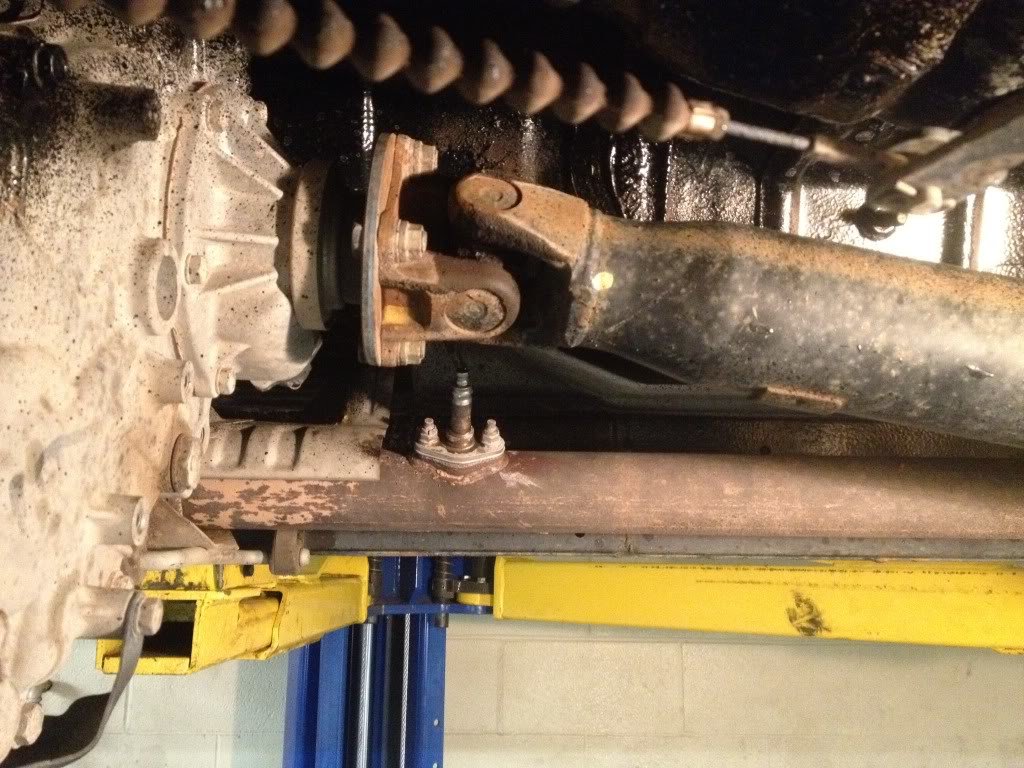

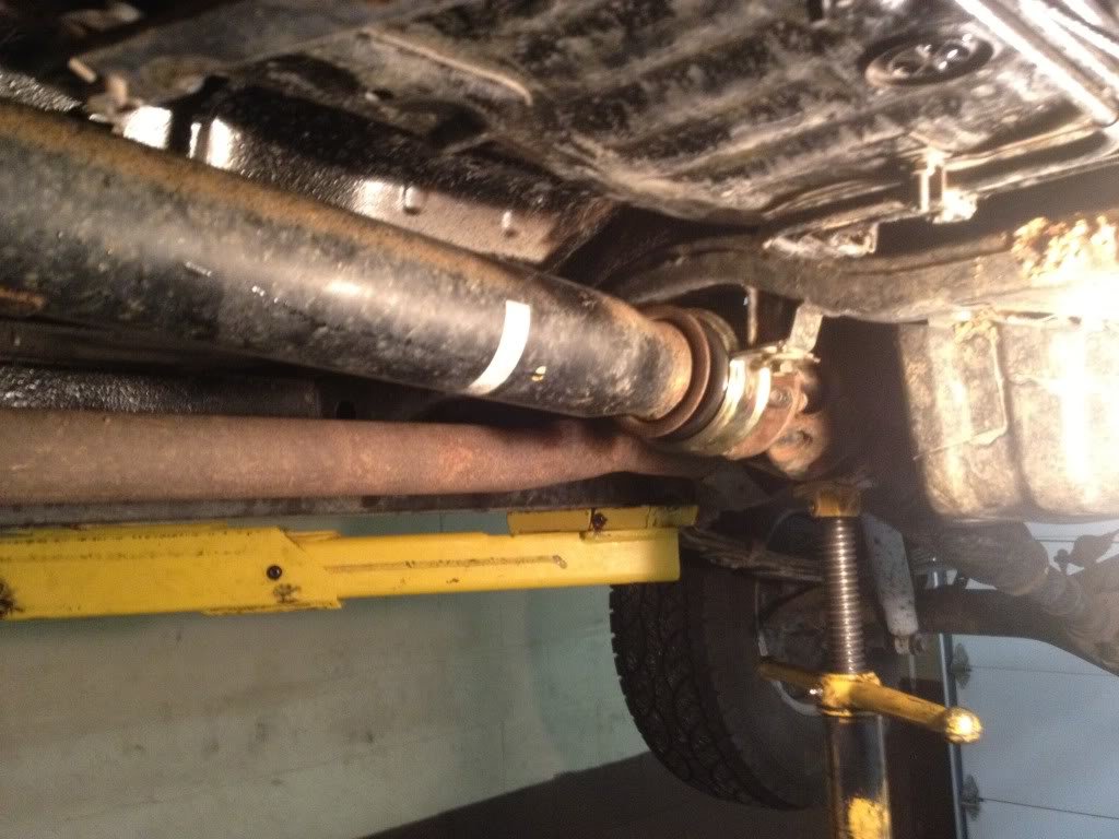

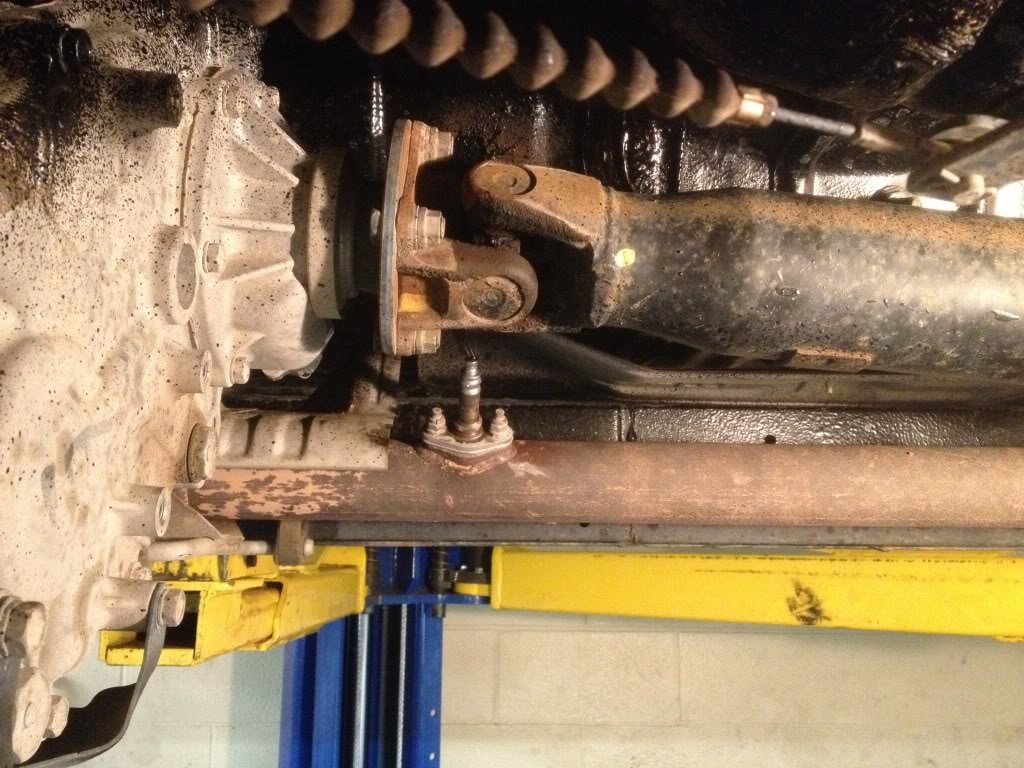

    I decided as one of my few last ditch efforts, was to install a carrier bearing drop bracket (i had a 3 inch lift installed, and diff drop done) (vibration was there before the lift)
    So i bought a Carrier Bearing drop bracket from Brian at Street Tacos.
    It worked. It reduced the vibrations, but the problem was it made it over a larger MPH spectrum, and I had the dreaded launch shudder.
    So i took it off:
    Now what? I took off the bracket (only had it on for 3 days), and the launch shudder is gone, but the vibe is still there.

    It looks like you got the wrong CB drop bracket.
    He makes one < 4" of lift:
    And another for 5+" of lift:
    The one shown on your truck definitely looks like the larger one.
