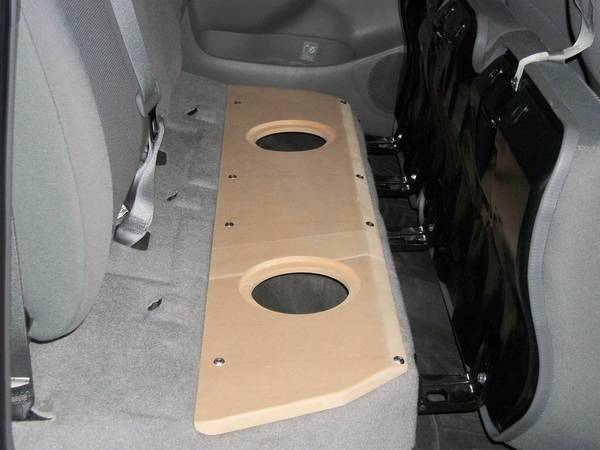

    Lol. Been thinking about this for awhile.
    Anyhow. As a heads up. There is something I did differently.
    After looking at the space for a prolonged time, I decided to not cut the metal flange on top. What I did instead was slightly bend the metal in the back part. The way it is built is that the baffle will slide in from the back to beneath the flange and will use the holes in the flange to secure the baffle. The seal will still work with the fiberglass and sound deadening interior of the enclosure to create the seal, as the baffle still rests against it. Everything has been fit and all seems perfect.
    Once it is all painted and most likely carpeted, I will post the pics.
    Just wanted to give some details about what I did. Apart from that change, everything else is pretty much what is seen in the pictures Italyn posted.

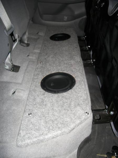

    Ok. Here are some teaser pics. I will post more pics when I make a build thread. Leather is on way and I still need to pain the rear doors black, so it is unfinished. Anyhow, here is what it is:
    Pioneer 3200BT
    6x9 Front Type S Alpine
    6.5 Rear Type S Alpine
    Dual 8" Alpine Type R Subs
    300W Alpine Amp powering speakers for 75 RMS each
    1000W Alpine Amp powering subwoofers for 500 RMS each
    All new wiring in 4 Gauge and 12 Gauge
    I started by soundeadening the floor with FatMat (still need to do doors and roof, since I did not have time), then did a layer of foam (still need to do doors and roof, since I did not have time), then did new carpeting. Need to fix some imperfections in the Sub Area, but I will do that later. Subs are places 1" MDF and the space is sealed, though not with fiberglass, as I wanted to see how it sounded before I fiberglassed it, and indeed the seal worked perfectly, as it sounds awesome.
    I need to check the Amp placement. The foam added a thickness far beyond what I calculated and the amps are a bit too tight below the seat.
    Anyhow, this is just a teaser for the build. Thanks to all who helped me in this endeavor.
