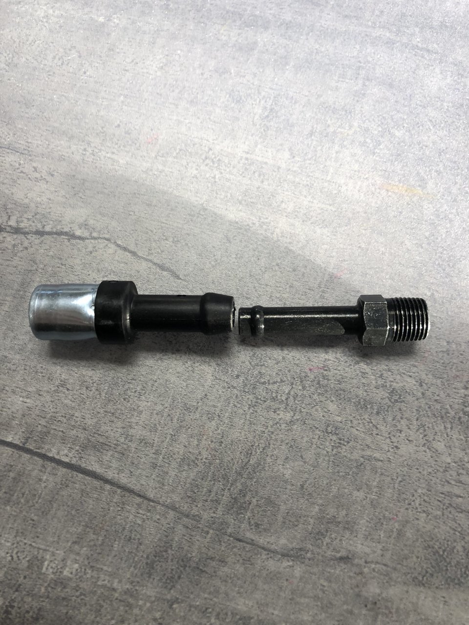

    2017 tacoma TRD off-road

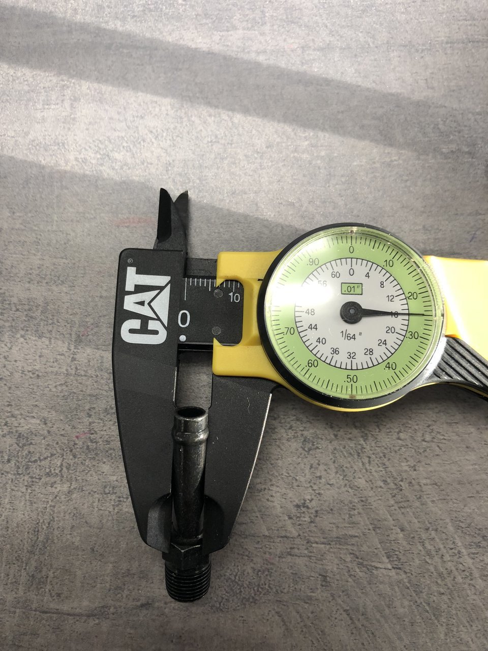

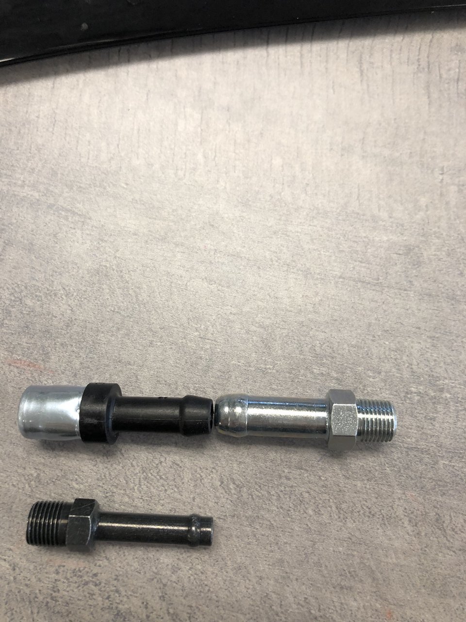

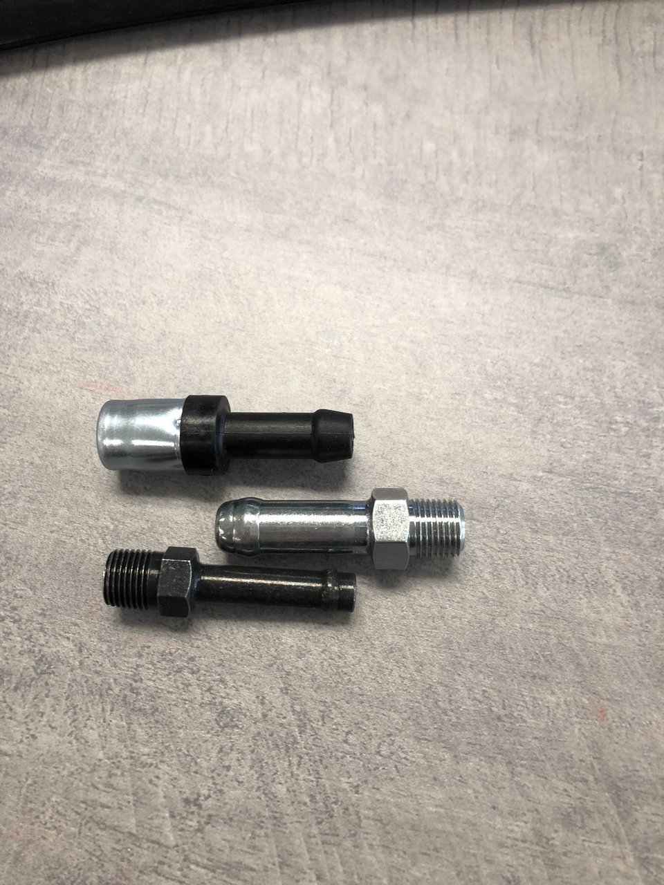

    gonna try this second one says its bought with the breather often

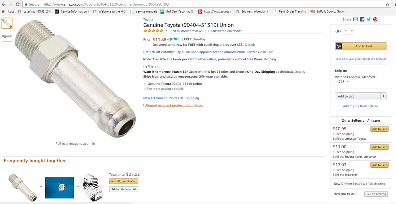

    I bought the silver one off Amazon, it is correct.

    thank you i hope so! i didnt take the stock breather out but just loosened it half way and it looked thicker then the black adapter i got too. so hopefully the silver one is a lil bigger on the thread side too

    You got the same black one from Amazon? and thread sizes were correct? i know the nipple is smaller then the breather for sure

    Yes- the breather at the other end will fit very tight on a 1/4” tube though, use a bit of oil or grease on it.

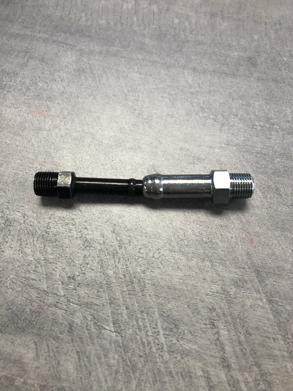

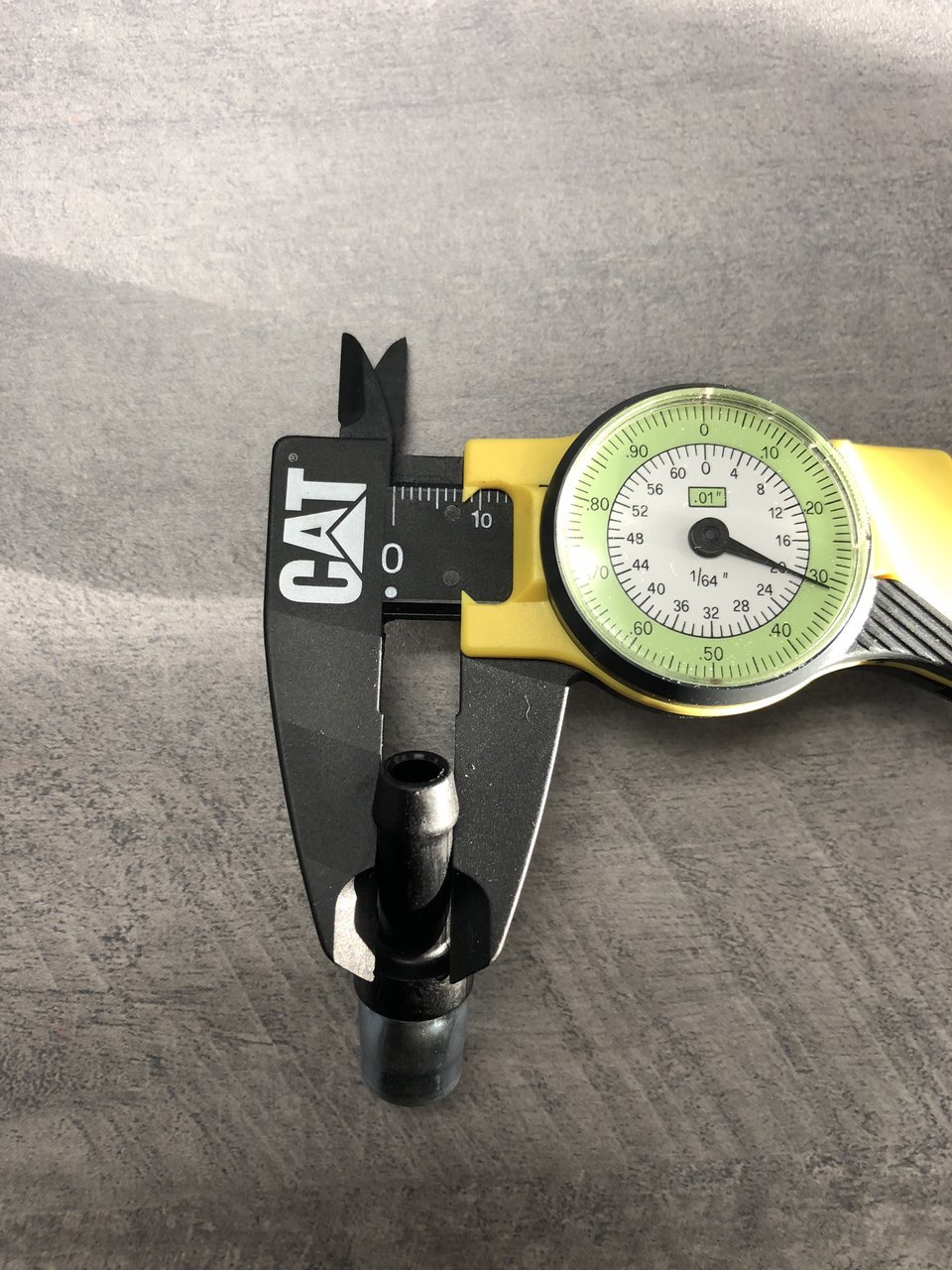

    Got the new fitting today, thread size looks to be the same but the nipple is deff bigger looks closer in size to the breather. Will try to install it tonight or tomorrow
    9C9EC32A-4E4A-4C29-8DC8-C4377B1BE083.jpgE9DBB93E-4D9F-4B98-A91D-A3D057303C11.jpgF5E4542E-0A12-4457-8818-031DE811E597.jpg
