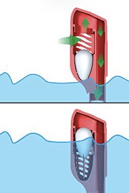

    In case you’re just a visual learner like myself pretend these are the valves :54D2A6FC-CEAD-4C71-85A7-C66B4236845A.jpg

    that diagram is an awful one if your trying to explain check valve function but I get the intent. Does anyone actually know if the oem is a check valve? No one seems to know for sure if this mod is even necessary.
