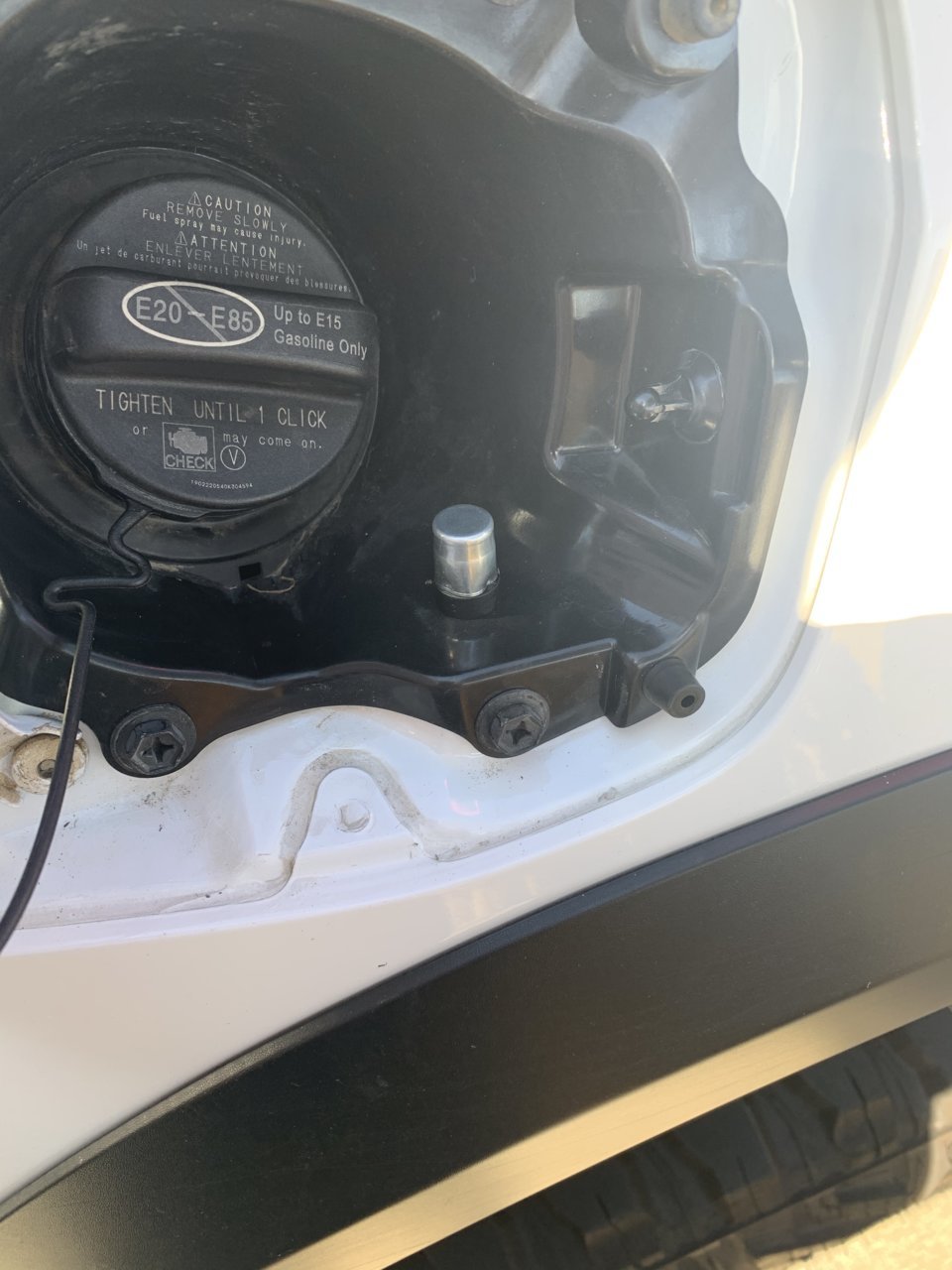

    Just did mine.. relocated the valve in the gas filler compartment. 6 ft 3/8” hose

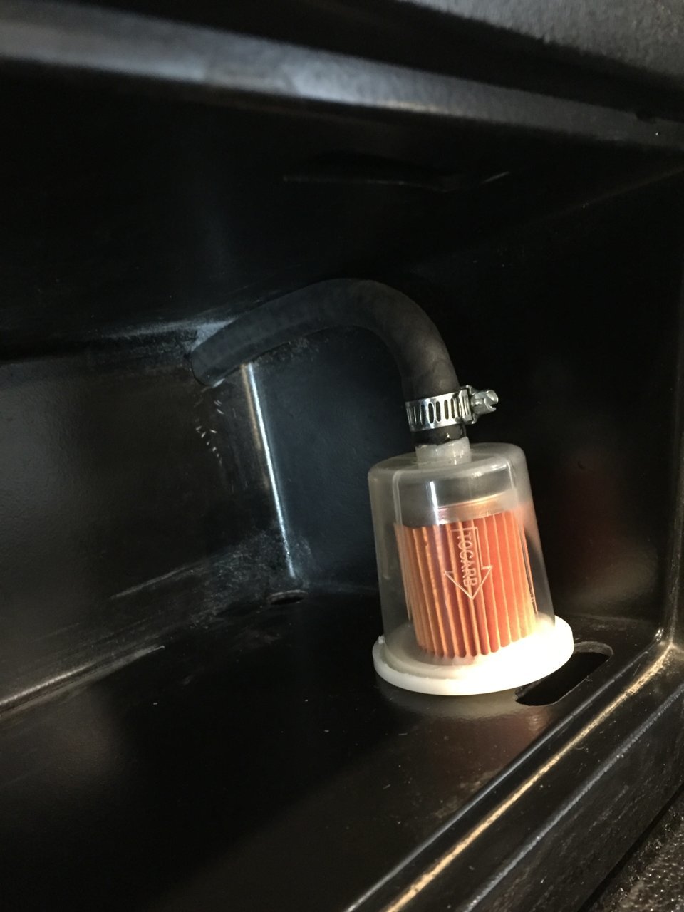

    Its my understanding the replacement valve (90930-03136) is 2 way, not a check valve. If you have concerns you may substitute it for a fuel filter.

    Not to dig up an old thread but did you have to remove the inner fender liner to feed the line to the gas filler compartment or is it accessible from underneath the truck? Think of doing it this way. Thx

    I was just told the black bezel around the filler can be removed and makes for the easiest way to put it in that location. I haven't tried but I'll report back this weekend.

    Right i forgot the details of the install. I couldnt get the black part off, the screws are seized up. I didnt have the tools or the workspace to deal with that and i didnt want to strip them. I was doing this is my apartment complex parking lot.
