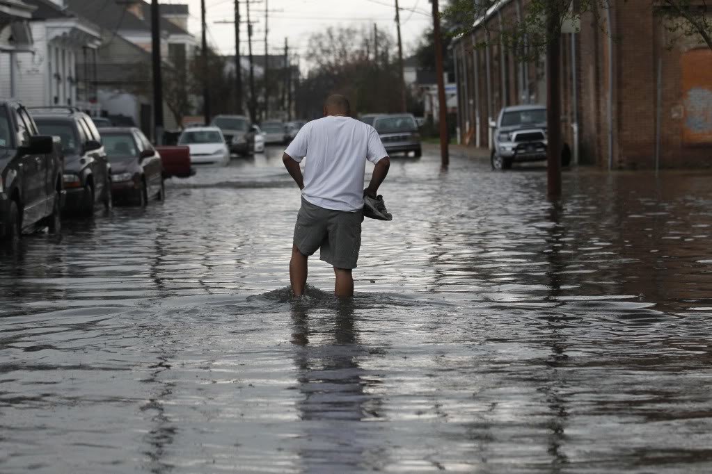

    I've been meaning to do this mod since New Orleans has frequent flooding, but never think to do it when its dry. Think its now time, since this was a couple blocks from my house (my Tacoma is on the right in the background)

    08 RC Prerunner SR5
    If water gets this high, you will have many other issues...............
