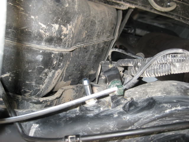

    Just following up. When I did this mod, the hex part seated all the way down to my diff.
    Is this how is supposed to be?
    How many wraps of teflon did yall use?
    I thought I used enough. Mine went in fairly easy / smoothly and the wrench didn't start feeling pressure till that lip started hitting the diff.

    I think I would want it to feel snug before it bottomed out... I wrapped the teflon tape three times. My tape is the 3/4" wide kind and so you can see the excess over the hex in this photo:

    My union was coated black and I put like 6 wraps on it. I had the excess around the hex part but mine bottomed out. Hmmm... should I re-do it?

    Just for you my friend... a recap of my thread on the mod:
    My 2010 went through some 3 foot muddy water in Baja last May and my differential was contaminated... had the oil changed. The breather mod puts a two way breather up high, so it is out of the water and allows air back into the differential so muddy water doesn't get sucked in through the axle seals.
    The two parts from Toyota cost about $12 together:
    Buy 6 feet of 3/8 x 5/8 pressure tube from Lowes (if you like the yellow)... cheap.
    Remove the breather (on the left side of the differential) with a 14 mm or 9/16 or adjustable wrench.
    Screw in the 'union' with a couple wraps of teflon tape on the threads...
    Attach the tube to the union and secure with a hose clamp... leave plenty of slack so the hose doesn't get pulled when the axle moves.
    Some run their tube into the fuel filler bay, I ran mine into the side storge compartment, after drilling a 5/8" hole.
    The new two way breather next to the one way breather off the differential...
    In place...

    Wow... It should be snug with no tape... but 6 layers and it still bottomed out? I wonder why yours was different (black)? Perhaps tell others what part # you ordered so they can avoid it and get the union that was recommended here (the silver/ metal one)?

    If you look at the OP, I ordered those exact same parts and they look exactly the same. His is black and not silver (90404-51026). And it looks like his bottomed out.
    One thing I did differently then you guys... I used CLEAR reinforced tubing from Home Depot. I don't know about ya'll but I would want to know if there is condensation build up in the hose or any type of debris.

    I see what happened, you bought a different union than what the rest of us bought.
