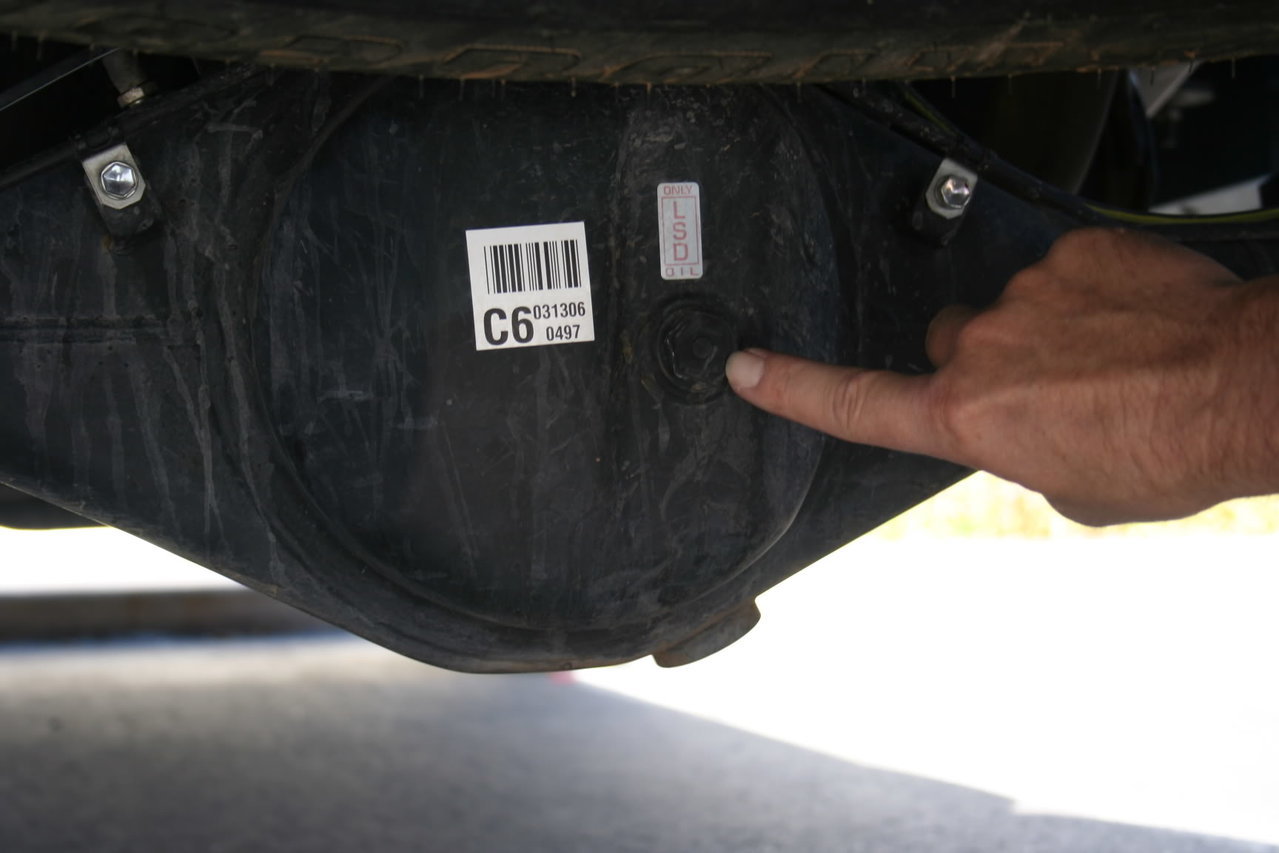

    If you have a Limited Slip Differential, YES you will need to use the LSD additive. However, many people have suggested using a basic Dyno oil and LSD additive with an LSD, because using a synthetic w/ LSD additive can cause noises from the diff.
    So in other words, if you have an LSD. Use Dyno oil instead of the synthetic oil.
    However if you have a non-LSD diff, you can use Dyno or synthetic oil.
    Get underneath your truck to look at the back cover of the diff and see if it has a sticker that says LSD. If it doesn't have that sticker, than you don't have an LSD.
    That link that MTgirl put up has a lot of good info, read through that thread.
    If you have any other questions, let us know.
    This is off a 2nd Gen Diff cover, but will look similar on a 1st Gen diff cover.
