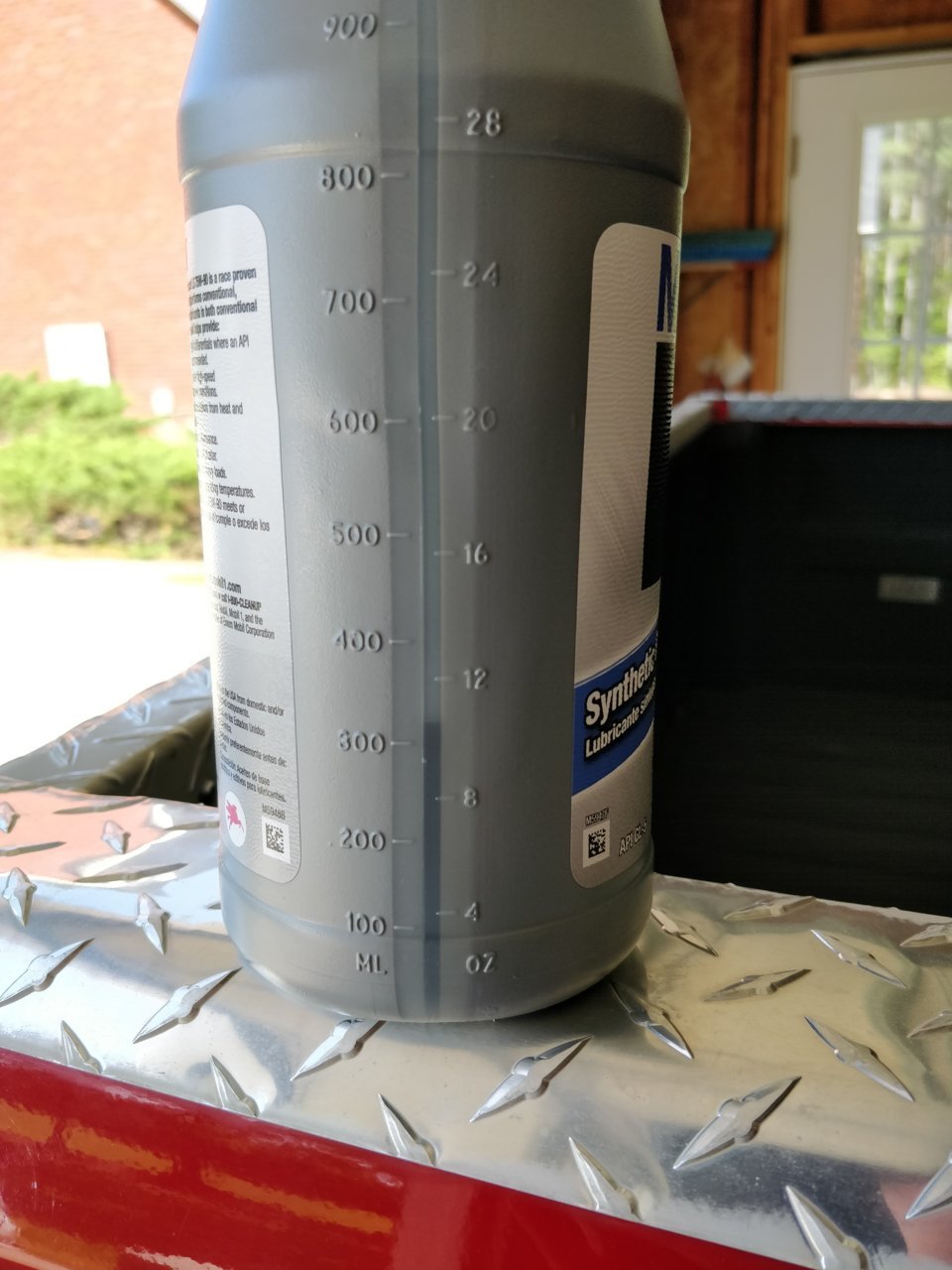

    Okay so I drained the differential, the rear one, waited a long time, and then filled it up
    I realize that it consumed all three bottles of mobile one without ever leaking out the fill hole... So I went to get another one just to be safe, I was seriously expecting it to only need a little bit more only to realize that I had basically just about filled it up with the entire bottle. So basically my differential holding almost four bottles of fluid...
    What?
    Should I keep going? Or should this be good? I just don't understand why it seems to not be full.

    Okay so thankfully after laying the bottle sit for a while, it looks like it's got about 1/4 left.
    But still, is this okay? I really don't want to mess anything up Lol

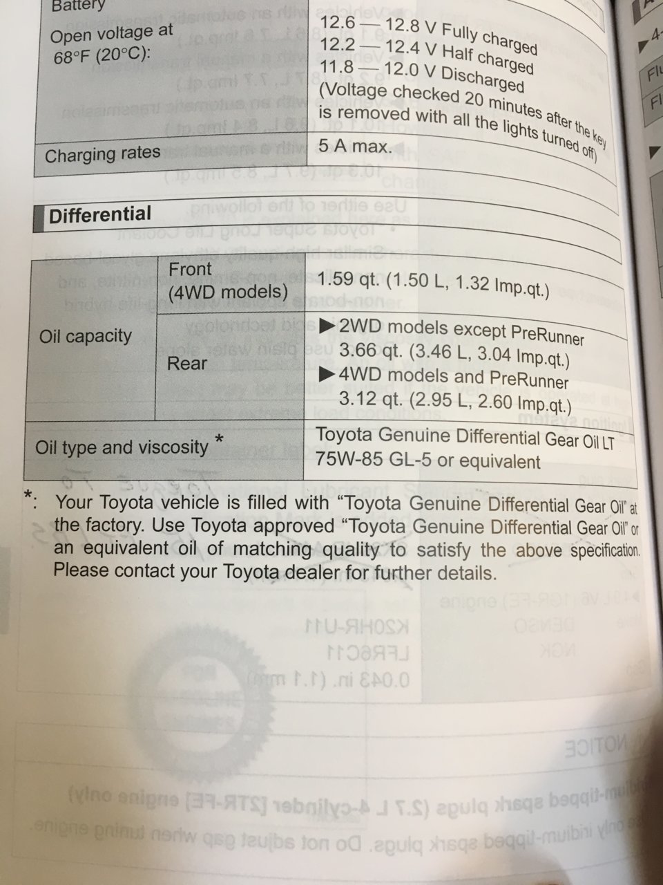

    Rear differential carrier assembly (for 2WD):
    3.26 to 3.36 liters
    (3.45 to 3.55 US qts, 2.87 to 2.95 lmp. qts)
    Rear differential carrier assembly (for Pre, 4WD):
    2.75 to 2.85 liters
    (2.91 to 3.01 US qts, 2.42 to 2.50 lmp. qts)
    I've filled probably hundreds of tacoma diffs without actually checking how much I've used. If it comes out the port its good.

    The rear diff takes a lot of fluid. I was shocked at how much mine took before it started dripping. Just keep filling it. As long as the drain plug is in and it is on a flat surface, there is nowhere else for it to go really.
    The Haynes service manual states 3 quarts even, but mine took a little bit more than that.

    7F74369C-41C7-41CA-B4B9-B26C79938FD7.jpg 2013 mannual data.
