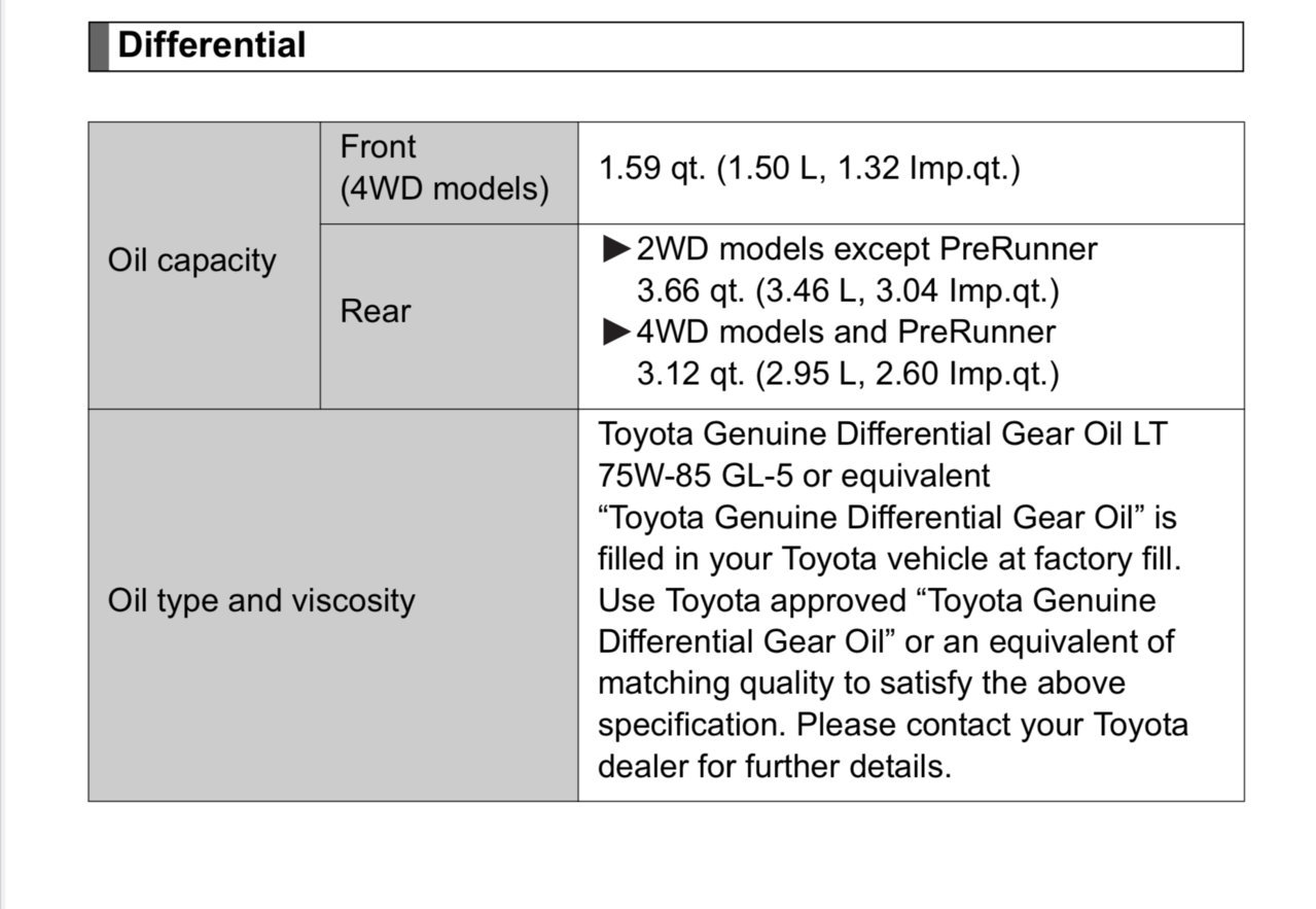

    I got this from the 2011 manual
    Classic_JM[OP] likes this.

    I used 75w-90 myself. No one had 75w-85 at the time I needed it.
    And I needed it QUICK, My axle seal was leaking and had to be fixed ASAP.
