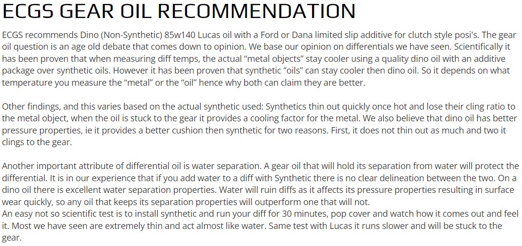

    WOW... there are some really bold statements in the first two paragraphs:
    Scientifically it has been proven that when measuring diff temps, the actual “metal objects” stay cooler using a quality dino oil with an additive package over synthetic oils.
    OK... what additives and I'd be interested to see the equipment used to measure the "oil" and the "metal"
    Synthetics thin out quickly once hot and lose their cling ratio to the metal object, when the oil is stuck to the gear it provides a cooling factor for the metal.
    Is this a flat out claim that synthetics (some) loose viscosity once hot?
    I may read more of that but was intrigued after the first two paragraphs.

    Yeah....I read the 1st paragraph. Didn't go farther, too many caveats set up to support their conclusion.

    Or you could ask Toyota themselves instead of listening to a bunch of claims from random "experts" on the internet LOL. Shoot them an email and let us know what they say!
    I'd be curious to know what Toyota has to say about syn vs dino for gear oil, especially since they spec that oddball 75W-85 gear oil

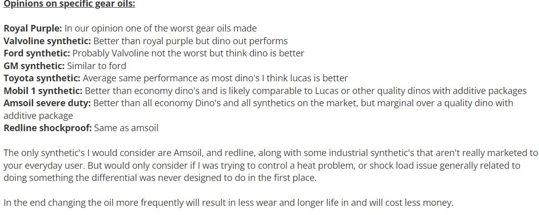

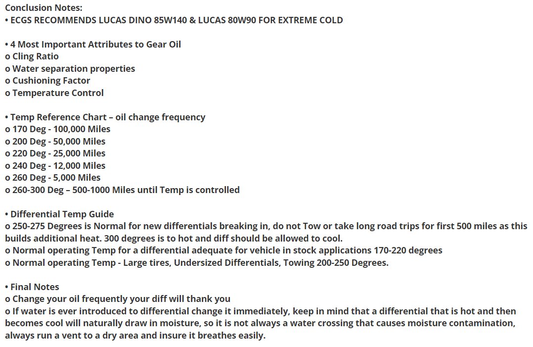

    I'm no expert, but ECGS is all about gears so I figure they know a thing or two. I've been using synthetic cause it seems like the cool thing to do but maybe time to switch back.
  20. Jan 5, 2022 at 10:41 AM
    #20
    Captainskidmark
    Captainskidmark Well-Known Member
    Nov 29, 2014
    #143284
    515
    Northern Illinois
    2015 4X4 TRD SPORT DCLB ~ Black
    ECGS 4.56 gears with Detroit True Trac in the rear. Camburg Ball Joint UCAs Dirt King LCA Dobinson IMS rear shocks Dobinson IMS w/ 352 coils DAKAR EL096 HD LEAFS AR172 17"x8" BAJA RIMS (5 wheel/tire rotation) GX470 Front Brake Upgrade SS extended brake lines Front and Rear (Toytec) 285/70/17 BFG A/T Toyota Roof Rack over Cab A.R.E. Z series CAP with Rhino Rack rooftop rails , -RED/WHITE LED BED LIGHTING -12V AUX POWER AND USB MAGNAFLOW CAT BACK RAAMmat Sound Abatement Pioneer AVH-2440NEX w/ Android Auto + Morel Speakers 120 VAC Block Heater Pelfreybilt Front/Mid Skids ATH Bed Braces ATH FRONT BUMPER - FULL LOOP BAJA DESIGNS FOGS HERETIC 20" LIGHT BAR ATH REAR BUMPER - STANDARD RIGID FLUSH MOUNT REVERSE LIGHTS Weathertech floor mats Rear Diff Breather Mod Wheeler's Super Bumps + Ubolt Flip Kit ABS Kill Switch Mod Northstar AGM Battery Pedal Commander Desert Does It Seat Spacers
    From East Coast Gear Supply's website.....
    **oops, sorry...just now seeing the number of posts referring to ECGS**
