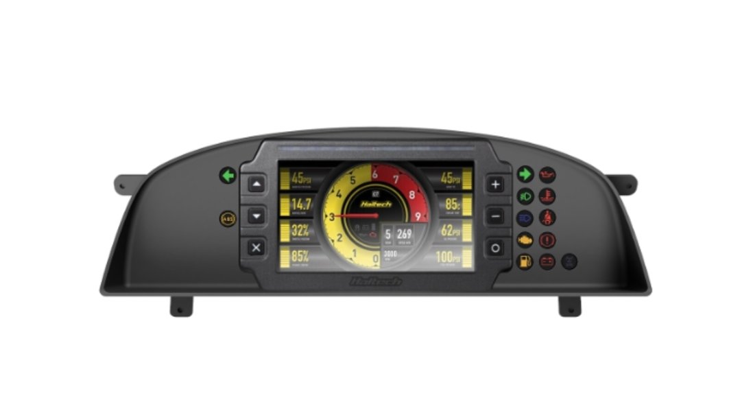

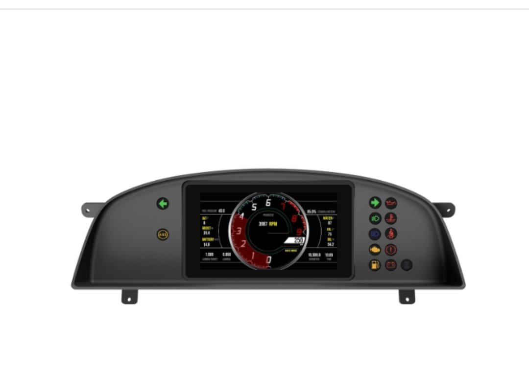

    Hey guys I've been doing some research around the interwebs...
    I want to replace my old cluster with something of the 21st century. Something where I can customize which gauge I want to see.
    I have a scanguage which is nice but I'd prefer having all those readings in my dash board behind the driving wheel. Have less wires all over the place.
    So far I've found two plug and play digital dashboards that I like, but I don't really know that much about them
    Hal-Tech IC-7 Analog Buttons (Top)
    Powertune Digital Dash Touch Screen (Bottom)
    As you can see both come with a customized dashboard that exactly fits the same spot the old OEM dash board was in they also come with led light indicators. All plug and play. (Unless you want to tweak stuff around I believe only Hal-Tech let's you do that)
    What do you guys think?

    I can tell you now you won't be satisfied with either of those over the OBDII connection, it updates too slow. If you had a Haltech ECU like I do then I'd understand wanting to use the IC7. Hook you computer or phone up to the stock ECU and watch how slow gauges update and you'll see what I mean.

    I don't see ANYTHING compatible with Gen 1 Tacomas on the Powertune OR the Hal-Tech websites; am I missing something?

    That's true.
    But now i may be going for Hal-Tech as another member suggested to purchase the ECU since I am planning on installing a Magnuson SC.
    Unless the other Digital dash is compatible with Hal-Tech ECU.

    The powertune dash is compatible with the Haltech ECU as well, most aftermarket digi dashes support Haltech CAN protocol. If you need any Haltech info lemme know or hit up my thread...

    I just called Hal-Tech
    It's confirmed that they have two dashboard models.
    1. Connects directly to the Hal-Tech ECU
    2. The second one connects directly to the OBD II connection.
    The direct connection dashboard is recommended for those who will have the supercharger installed in the future since the Hal-Tech is needed.
