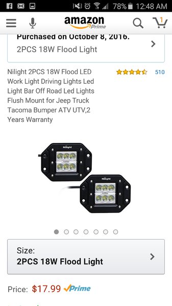

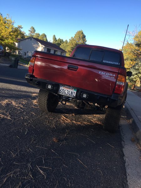

    These are what I just installed and I love em. Cheap and bright as hell. Just need to buy a wiring harness and you're good to go. I just used a plasma cutter to cut out the hole, made it way easier.
