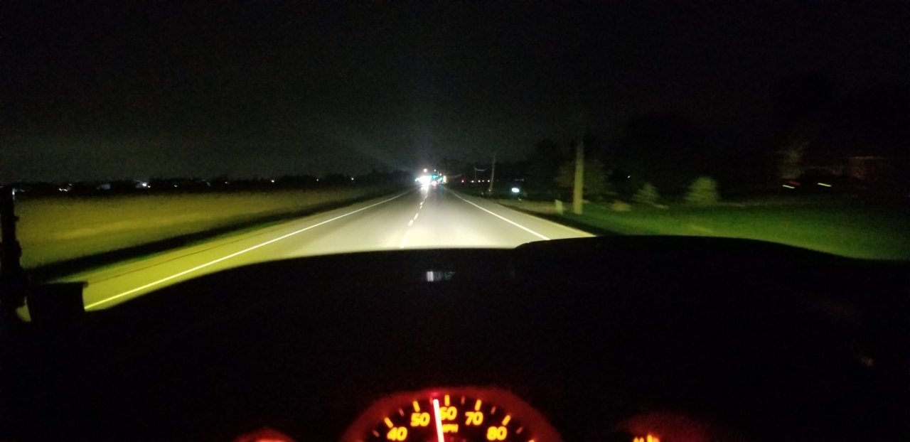

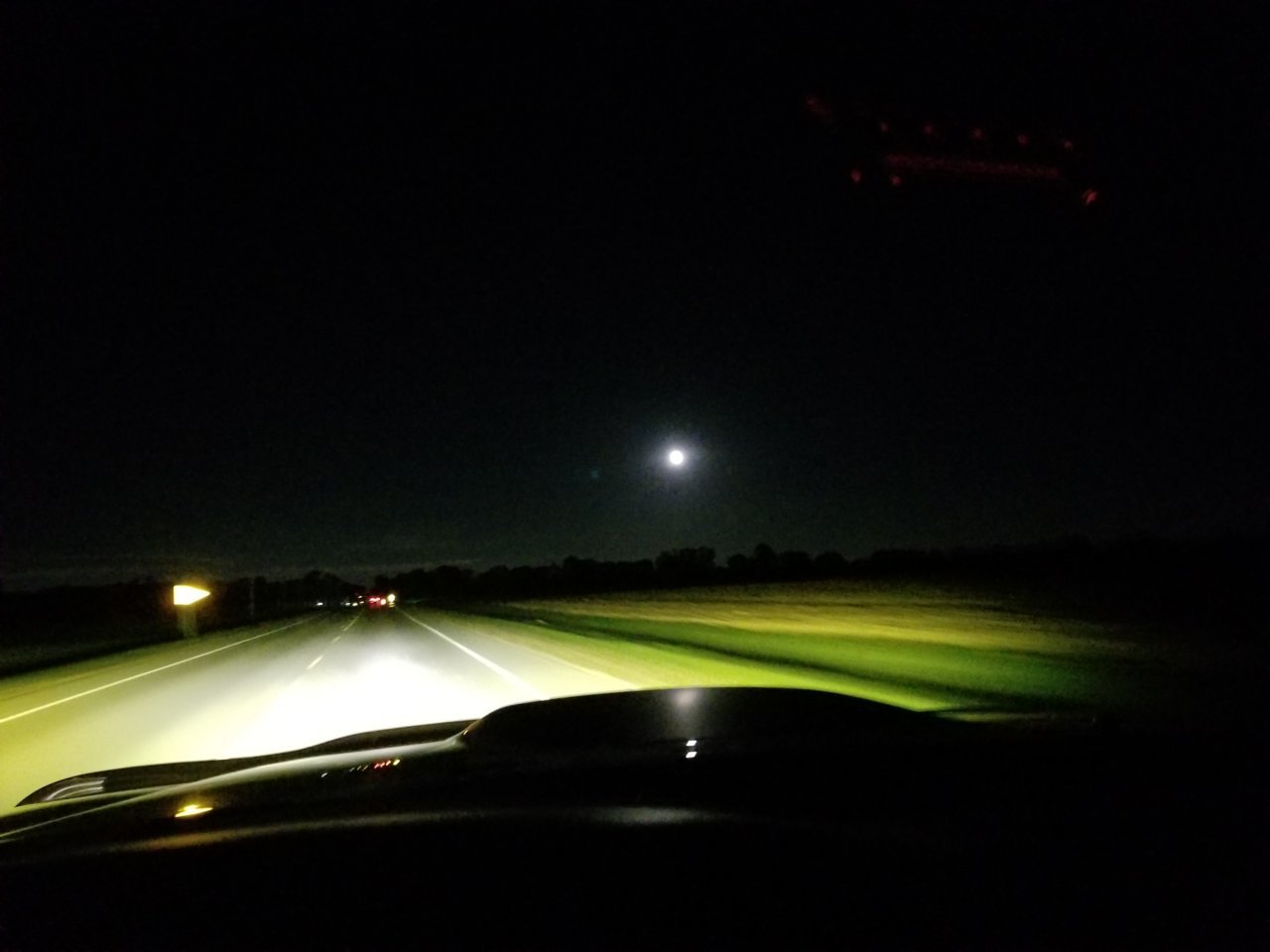

    I have the SS3 Sports on my Tacoma. They are plenty bright for my night time driving. I may upgrade to Pros soon though.
    First pic is fogs only, second pics is fogs and headlights. Not much difference! lol

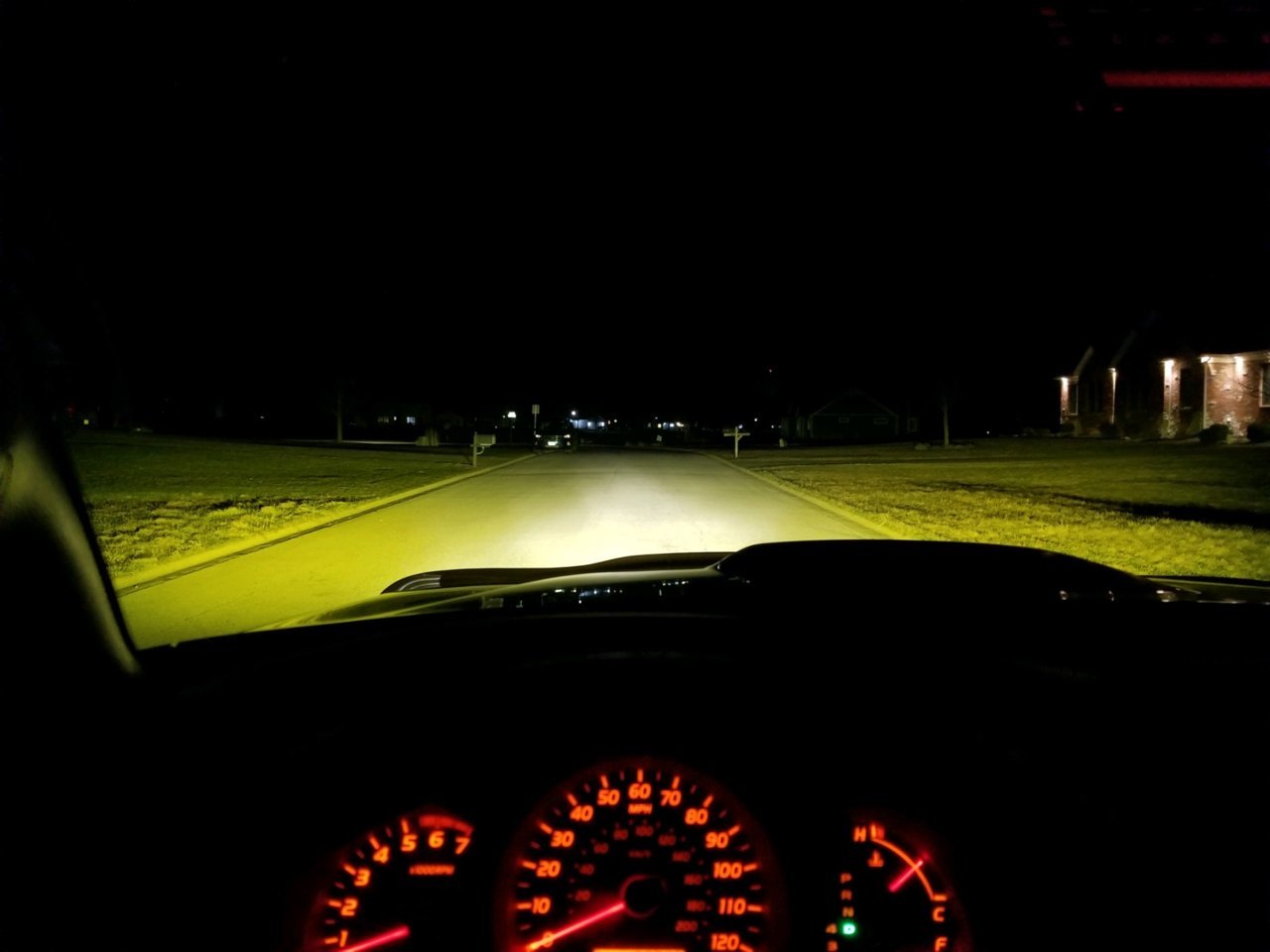

    Rexing front and rear dash camera, some LEDs, Weathertech HP floor liners/vent shades/bug deflector/underseat storage bin, OEM Ford bed mat, Diode Dynamics SS3 Pros in selective yellow, Diode Dynamics 18" light bar in amber and universal Carhartt seat covers. Bak Revolver X4S tonneau cover. Android Auto USB plug upgrade! H11 to H9. Sound deadened/insulated floors and rear wall. VLED license plate reverse light. Yokohama GO15s. Rokblokz mud flaps. "Custom" 3in Flowmaster Super 50 Series cat back with a 3in Speedys Snap resonator. J&L catch can. AMP Powersteps
    Hopefully this helps a little. Here are some pics of pros (not the best of pics). I would definitely go with pros if snow is an issue. To me even if the sports could in some cases melt snow I would rather have the peace of mind and get the pros. If this helps my father's F350, my moms Subaru Ascent, and my Tacoma all have yellow pros (father has clear lenses on now) and WE ALL LOVE THEM. Once they saw the output they asked me if they offered them for there cars. I would get the yellows so if you ever wanted to change from white to yellow or vice versa you get a nice white color and a nice yellow color and not the greenish hue that you get with an original white unit and a yellow lens. Even the green hue isn't bad looking but it's not the crisp yellow. I love the light output when going down country backroads late at night and I never get flashed.

    To me this seems entirely counterproductive as that is a LOT of foreground light with very little throw.
    Maybe it’s foggy a lot but for clear days this has to be working against you not for you.
