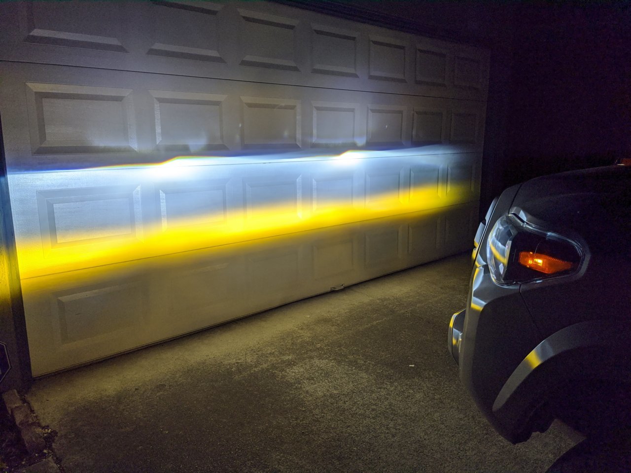

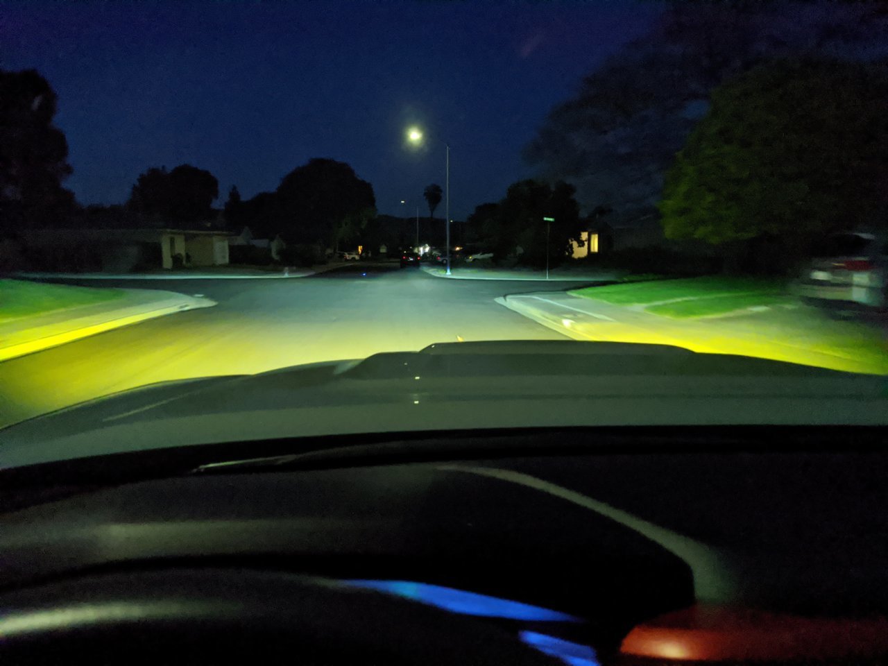

    I have the sport version. Here's couple pics of how I pointed it when I first got it, will probably lower it more eventually, haven't done it since I haven't gone out at night with the pandemic. Note: the picture was taken with cellphone higher up than eye level

    Are those stock headlights?
  15. May 22, 2020 at 7:11 PM
    phoryu2nv
    phoryu2nv Well-Known Member
    Feb 25, 2019
    #284438
    80
    '19 Cement TRD Sport 4x4 DCSB 6spd
    No, I have retrofit rx350 projectors done by @no vtec 4me
    no vtec 4me likes this.
