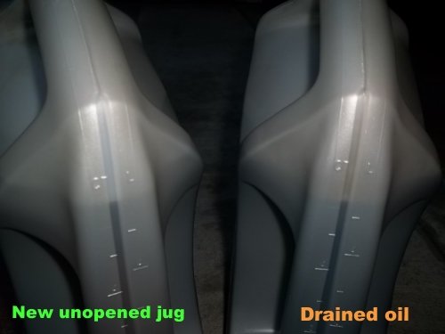

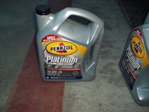

    I'm going to revive this thread for a bit and want to confirm some questions here.
    Today I did my first oil change at 5,000 miles. So I did the usual drain oil, muscle out the filter and fill. Oil was allowed to drain for 5 minutes. Filter was bought from toyota and a 5 qt jug of Pennzoil Platinum 0w20 from Walmart was used for oil. After pouring in the 5 qts, I measured the dip stick, and like many have posted, it was almost impossible to read (the fact that the oil was almost as clear as water didn't help either) and it read a lot higher than expected. Started the engine for about a minute, shut it off, and measured again, this time the dip stick was just a mess to read, so I waited 3 minutes or so and measured it once more. This time, the majority of the oil was reading at 3/4 of the way to the high mark. Hmmm.
    Still skeptical as to whether or not I was doing the oil change correctly, I poured the contents from my oil drain pan into the empty Penzoil jug and compared it to another unopened 5 qt. 0w20 Pennzoil jug that I bought with the exact same dimensions.
    b5ea5c30-283f-41e4-99fa-36ba21c550ed_zps_ca83bf4219c413bfcd5a0698696691ba6c8af6c8.jpg
    fc8bf1fb-e5d7-44be-be02-b13fcc7c6a1c_zps_43bea7ceafb5f68df3b63ec086aedd1def559e91.jpg
    As you can see, the oil drained (right) is lower than the oil in the unopened jug (left). I'd estimate that the drained oil is 1/8 qt less. Combined with the oil filter that was still half full and some residual in the oil drain pan, I'd say a drain and refill of the 2.7 requires approximately 5 qts. The dipstick, as unreadable as it is, would be accurate in this case. Now, I am not sure how accurate those 5 qt jugs are, but one thing is certain, the 2.7 does not require almost 6 qts per oil change as the manual states.

    Mine is barely past the lower mark with only 5 qts.
    I add 5.5 and it comes in just below the top.

    Fill the new filter with oil before installing. Then pour 5 qts in the engine(2.7). It's magically correct every time and no dry holing the valvetrain when starting it up after the change waiting for the pump to get oil up there. The stick is most readable after the truck has sat overnight. If the stick had a nice crosshatch section like the older ones did, it would be much easier to read the thing at any time. But nooooo, they have to make do a bunch of snaky bends and shit instead of a nice solid stick with a straight drop into pan.
