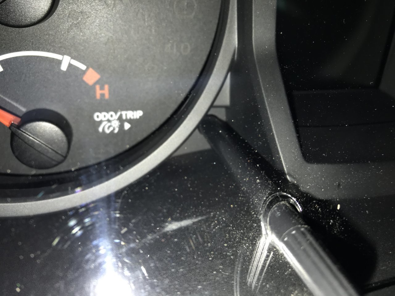

    Hey guys. I have a 2019 Tacoma TRD Pro and I noticed when cleaning the interior this past weekend I am getting dust/dirt in behind the clear plastic lens of my instrument cluster. It looks like it is getting in around the trip odometer/brightness dial. Anyone have any ideas how to clean this? I am still under factory warranty do you think this is something Toyota would cover seeing these trucks are meant to go off-road and play in the dust/dirt? I would think Toyota would have a better seal around this dial for this reason alone. Thanks!

    When you get it clean... Install an O ring over trip meter/brightness stalk helps seal out dirt.

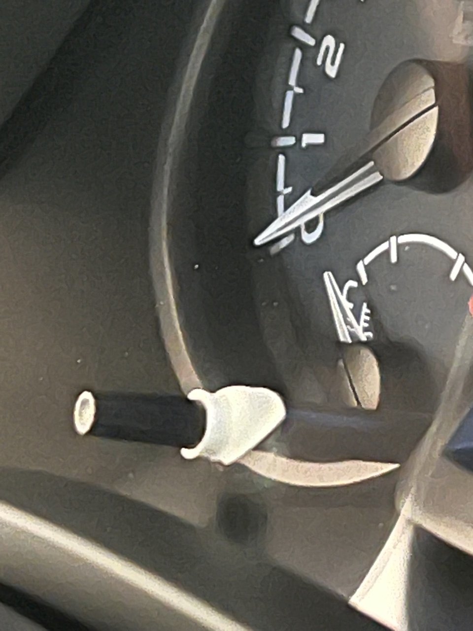

    So I read this thread months ago and remembered the O ring idea. Went to Home Depot, got a couple sizes. They fit but do nothing because of the angle as you mention. I am looking for a solution. Need one soon! Just got the truck.

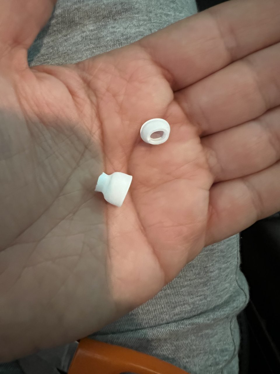

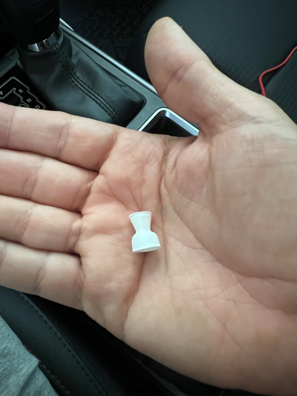

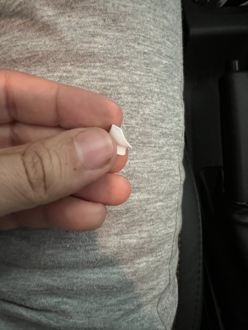

    PROBLEM SOLVED!! This is totally unorthodox but it WORKS. I took a spare Apple AirPods PRO ear fitment (which you can buy on eBay under $2), cut it in a couple spots including to accommodate for glass angle, wrapped it over the stem, and it works brilliantly and perfectly and also allows you to still use the odometer stem without it moving out of place. Am I a genius or a weirdo folks? You decide. 88A816E1-38CE-49F3-B1C5-A5290EB06778.jpgFABF0922-DF02-4177-A9B5-DCDF8FB5B1FE.jpg 2CD67F46-5A1F-42F9-A6A8-49851D788312.jpg30BF4B6B-7804-4365-8DC5-D796C7AC25BA.jpg 70F26F82-CB4C-4C40-B5A1-A569D633E176.jpg
