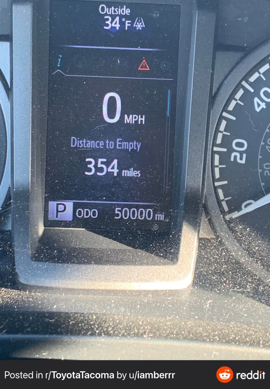

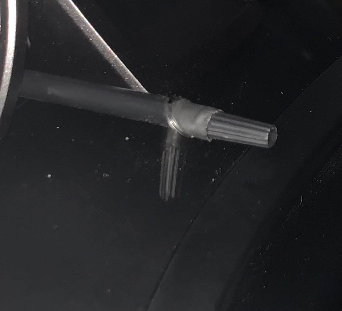

    Not from apple but I’m sure a similar solution could be fashioned out of a black silicone ear fitment from somewhere else.
    Dust behind the cluster is supremely annoying to me. I thought you guys would be more excited about this. Guess I’m butt hurt (awww poor baby). Anyway, I’m super jazzed about never having dust enter my brand new instrument cluster. Now I just need to reorder the protech screen protector and not fuck it up this time.

    Which looks more “terrible”A5FC59F3-C465-461C-B891-24390FAA218E.jpgDB324B30-EEFC-4E0C-8A71-2B3A7DA207D3.jpg

    I tried a few different options and haven't found anything to fit and work would be awesome if someone could 3d print something think to slide in the hole and cover the outside

    Im sticking with my ear odo condom which works perfeclfy but nobody here likes lol. I just got some spares off eBay for a couple bucks.

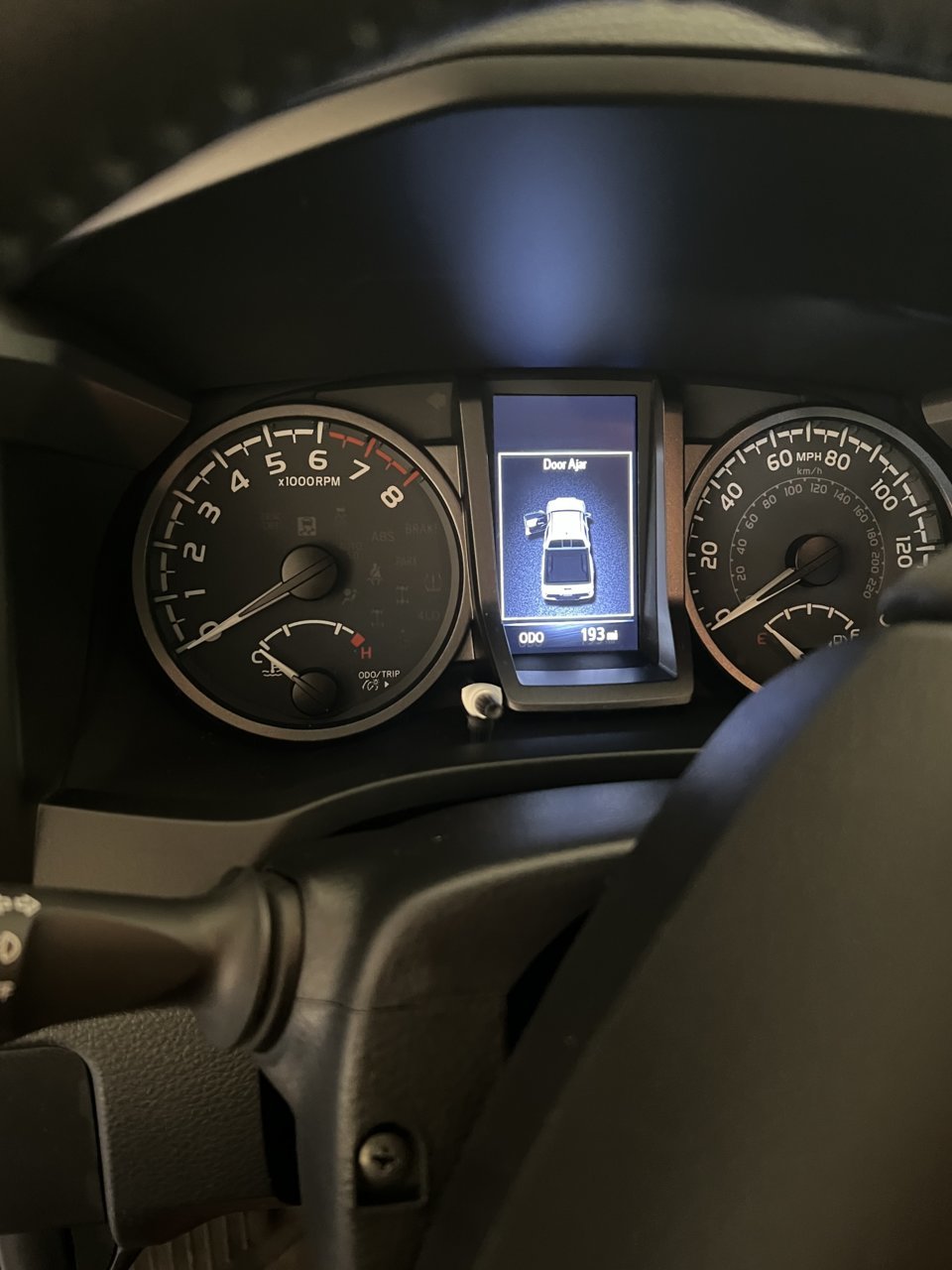

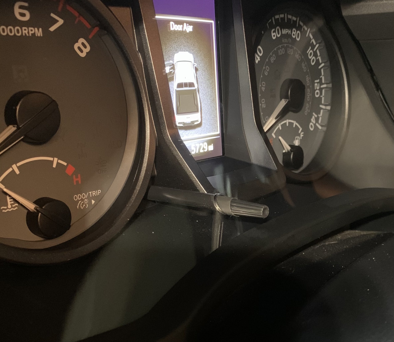

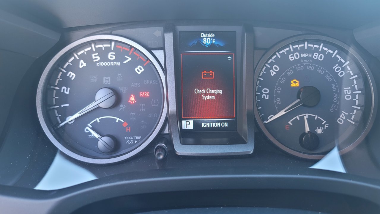

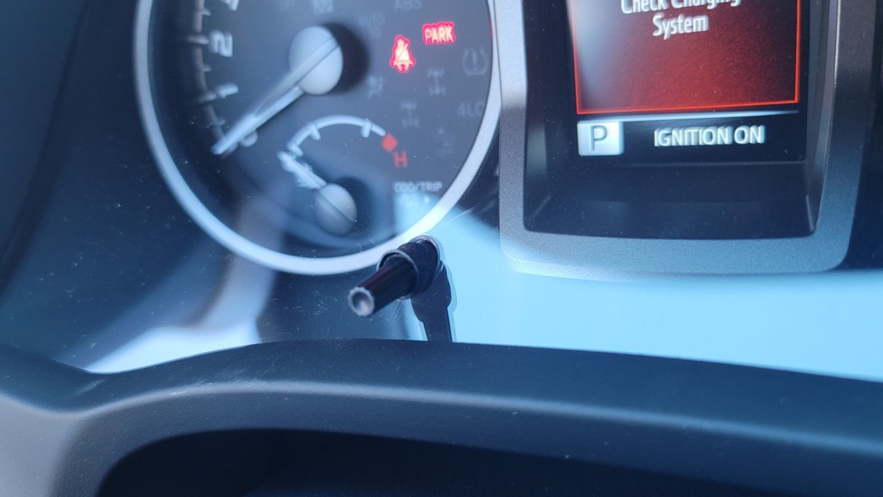

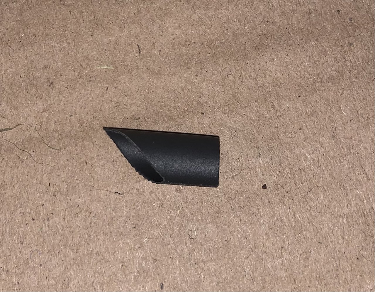

    Not quite as clean as the black eartip method. But, 3/8" shrink wrap tubing seems to do the trick, too.
    Jammed it over the odometer stick, using an empty ballpoint pen casing.
    979B6D5E-034C-40FD-A682-E04A7F67FF30.jpg 6DFAB190-7540-46AC-B54A-53076246CE65.jpg

    man I love collaborating with people on the internet to solve dumb but annoying problems

    Nice now that looks good like tacorancher said his idea and you improved it. I tried so many different sized grommets and a headphone tip is what fits better than everything i tried amazing. Guess its on to Amazon to get an assortment pack

    I didn't even know it was a problem before I saw this thread.
    My OCD couldn't handle the crumpled tubing look. So, did it again...few drops of WD-40 into a new piece of cut shrink wrap tubing, used fingers only to jam it over the stick, and voila.
    Now, I can sleep peacefully tonight.
