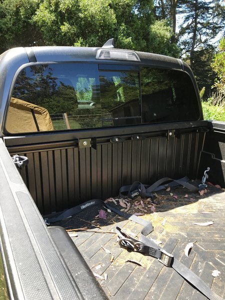

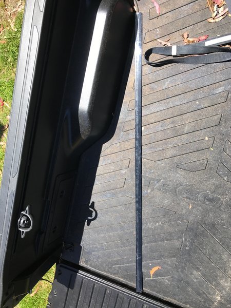

    Get the new CCR rack http://ccrsport.com/protrack-motorcycle-transport-kit-mid-size/
    installed on my taco using existing bolt holes on stock bed piece. just need longer bolts and a shim.. I had the shim made at a plastic place for 4$.
    This is from another thread :To make it fit factory, add a 57" piece of 1.25" x .25" under it and replace the stock Toyota torx screws with 6 x 40mm stainless buttonhead allens. Even the tie downs are trick.
    so the plastic piece you want made is 57" piece of 1.25" x .25 ill post a couple pictures.

    @moderman, did you have to offset the holes (from the center scribe) you drilled through the protrack?
