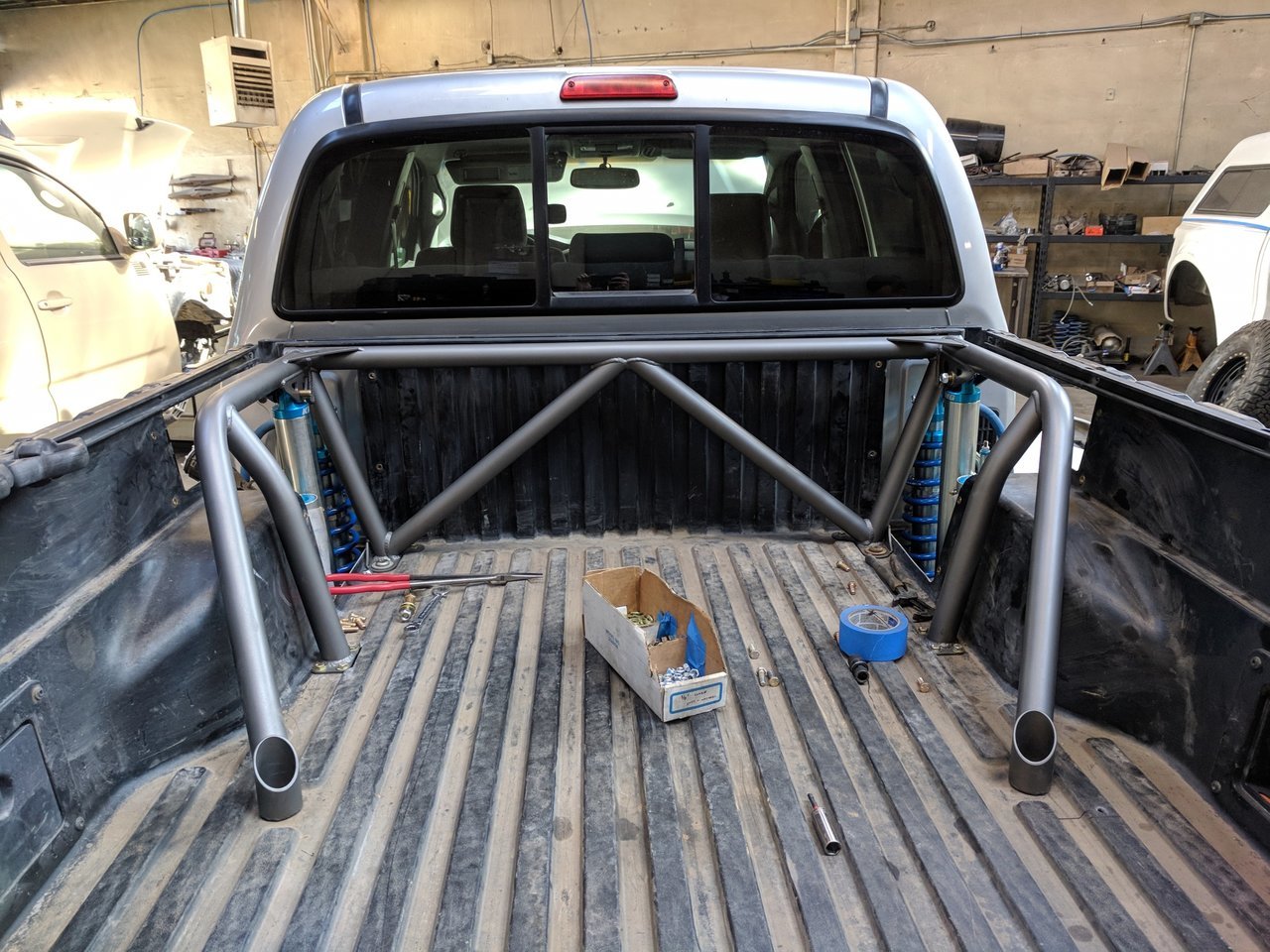

    $4k for trailing arms, upper link, track bar, all axle mounts, axle truss, all frame mounts, all heims, bushings, hardware. It does require a fab shop to install + build a bedcage. Things you need to supply are shocks, wheel spacers, and bedsides. Also factory gas filler needs to be moved.
    The silver taco is almost done. Front kit is on with bypasses and engine crossover. We got the bumper all tacked together and it should be all welded up tuesday. Then its paint time and assembly.IMAG0134.jpg IMAG0139.jpg IMAG0135.jpg

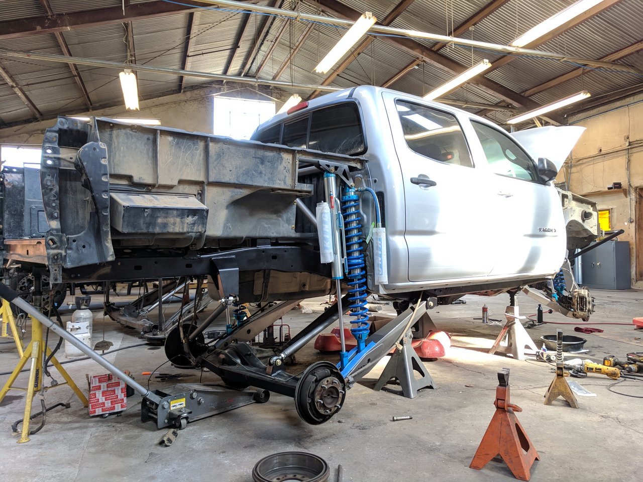

    Well that took longer then expected. Everything was painted and we started assembling but the bedsides ended up ~3weeks late. Then we decided to move the factory spare holder around to fit a 35 under the bed and that led to a new rear bumper haha. Anywho, the silver taco just left the shop today. Hes going to wrap the truck, and we'll get some more pics. The tan taco is all torn down at powdercoat and we will be assembling it next week.

    Amazing work! Why is the upper link at the axle towards the passenger side and not centered?

    It' a panhard bar. The way that type of link system (3 link) works is that you need a link or "panhard bar" to prevent side to side movement.

    Negative, the upper link.

    Stock gas tank and drive line carrier bearing are in the way in the middle, nowhere to put it.

    Nice Work. From the pics, it looks like the frame is not plated from the cab back? Is there a particular reason why this wasn't done?

    Time, money, and theres no real load in the back on the silver taco anymore. All the suspension loads are now right behind the cab. Only thing thats really loading the frame in the back is the weight of the bed, spare tire, and panhard. We'll see how long it holds up. Its a buddy's truck so any issues we can look into and fix as needed. If he drives hard like normal he'll be needing a cage more then just frame boxing haha
