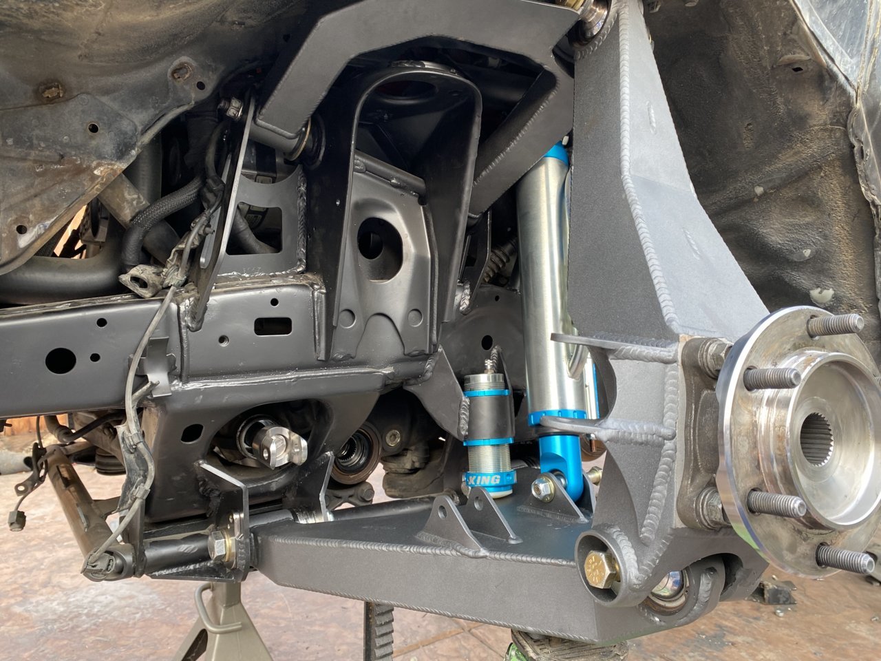

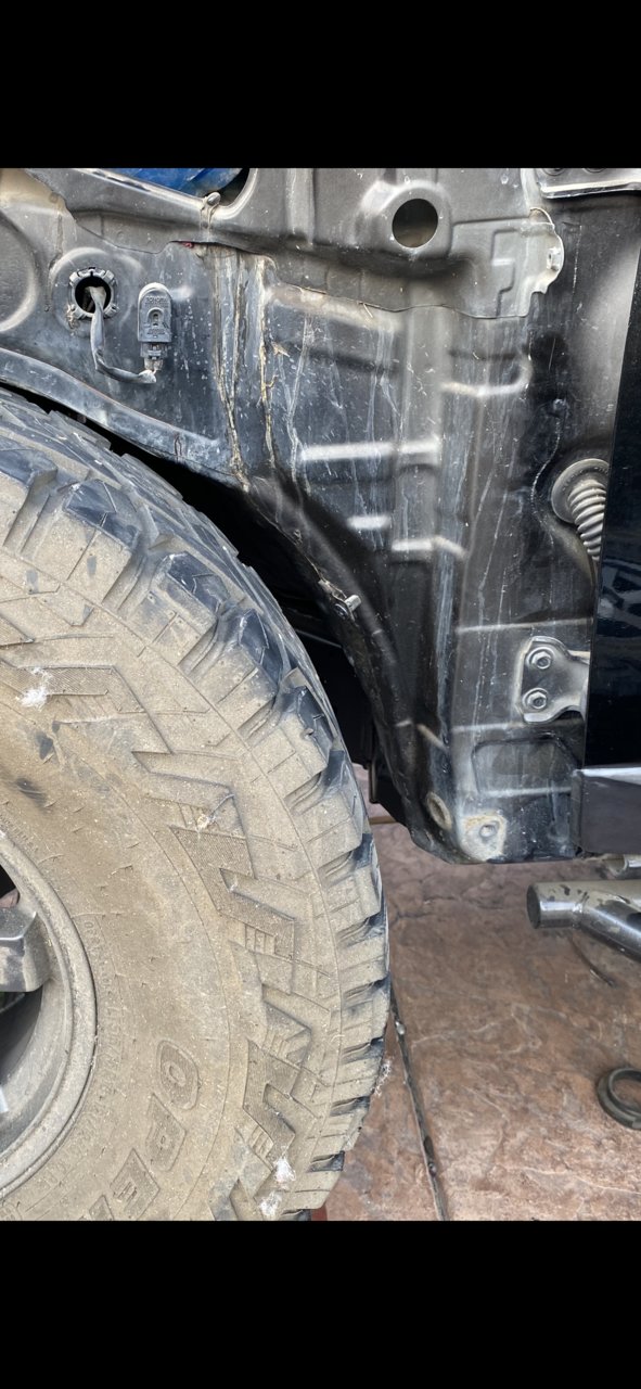

    I’m getting 14.75-15” before the upper arm lays flat against the inner fender. If I clearance the inner fender and cut the rubber washer off the bypass shock, I could get around 15.5” of travel vertical before I run out of shock. That’s with my 8” setupA54B4A9D-1B71-4400-A869-0B1D4CD7AFA3.jpg15141458-5663-4C4B-A5B8-166A3B129DD2.jpg

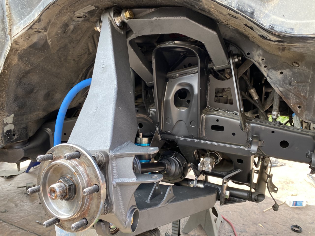

    To help with the firewall clearance, I coupled my long travel kit with the lower control arm mounts that allow more adjustments forwards. Looks like my clearance is decentA0F82680-025D-4802-8359-4051427C36F1.jpg Mother Nature has been ashing on us for months now, So don’t mind the mess.
