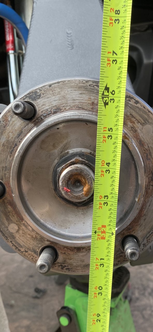

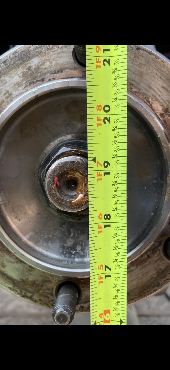

    Curious, where did you take your measurements for those numbers off of the kit? Impressive for a bolt in 4WD kit.

    Hubs. Only took a couple of pictures, but here’s my first set before I adjusted my bumpstops. It’s because this kit has vertical uniballs top and bottom. Most of the other off the shelf long travel kits Have a horizontal upper uniball that is the limiting factor for their kits. I also have axles that allow quite a bit more angle before the outer cv binds.2F5FEA73-1BD7-4669-ADC2-3148ED76AE3B.jpg

    Nice! Yeah the vertical uniballs upper and lower definitely are the right move. Solid travel #’s for a bolt in kit with 4WD.
