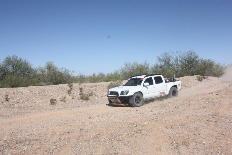

    Sup with that chevys front wheel...doesn't look right.

    It has to do with the tire being centered in the wheel well. Steve usually pushes 2wd race kits forward in the wheel well for multiple reasons but to pull clean 4wd travel he centered the tire to keep the CV joints and axles in line with the factory. I took the truck out yesterday and put it to the test. The truck f$&king mobs even with the stock rear suspension:D

    Yes? If youre reffering to why brians taco needed an alignment, it was due to blowing through stock cam tabs. but its all bueno now thanks to carlos.
    Price is going to be $4200 for boxed upper arms (with delrin bushings), boxed lower arms (with delrin or poly bushings), boxed uprights for stock hubs and brakes, 1 in unis for pivots, full heimed tierod, ss rack adapter clevis', brakelines, limit straps, hardware, and upper shock mount plates for the stock shock bucket.
    Delrin in the lower arm will hold up longer and doesnt need lube. BUUUUT it limits the alignment some. Because its hard (not a soft rubber) the alignment tabs should be kept inline on each side. So on pass side dont turn the front cam all the way out and back cam all the way in. They should both be out, or in, or wherever...just matched.
    At ride height the truck is right at 72" wms (with cam bolts centered, and including rotors). With the lower arm completely horizontal the kit is at 74" wms.
    No one makes heavy enough springs for the duramax. It has 19.5x 800 springs with some preload, but its still sitting 2-3in low. So right no hes sitting at where the camber curve starts kicking in. He going to beams instead of custom springs now.
    Yep what joel said. that and the 2wd is about 1.5per side wider then the 4wd due to the lift spindle. Because of the lift spindle the tire doesnt tuck as high with stock buckets (4wd stuffs up higher), and the tire sits out farther so it clears the firewall. I CAN push this 4wd kit forward an inch to clear the firewall, but then youd start hitting the front of the inner fender hard by an extra inch.

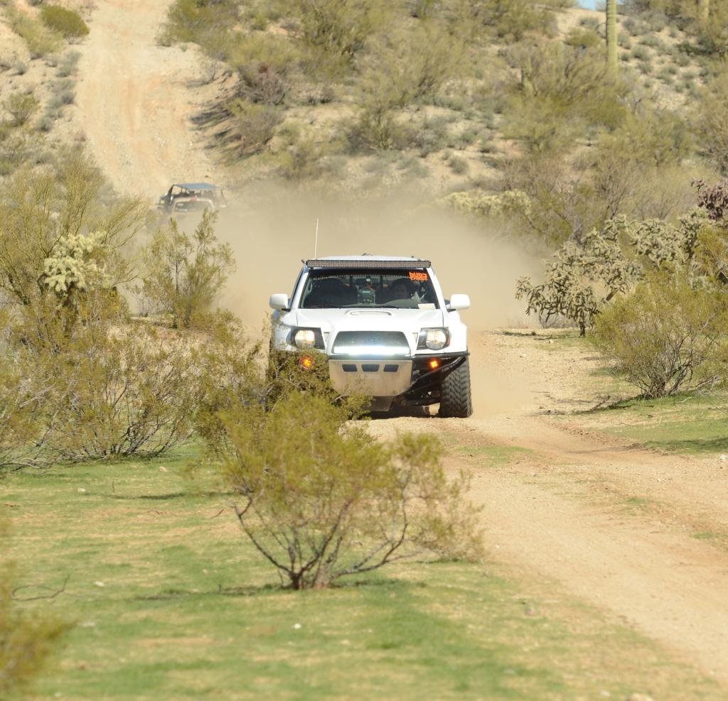

    again, not trying to :stirthepot: but full bump, 35" toyos... the BFG photo was just a better shot of full bump. these measure over 35s
    23cb475d-a1f2-4d66-bf52-6881a3041b39_zps_52237192cf7b13f63745c496bd7d6cc2e9de61d6.jpg
    truck was cycled both during the initial Burg install and when we did bypasses, no need for air bumps. I am not able to use 100% of my steering while at full bump but i would say that I can utilize maybe 70% without any contact but lets be honest, if you're at full bump/full lock out in the dez you probably already have bigger problems than your tires rubbing...
    My front end is very similar. Custom spindles, double sheered and heimed steering, 4x4, etc etc. Any reason for using only bushings as opposed to heims and uniballs in the uppers and lowers?
