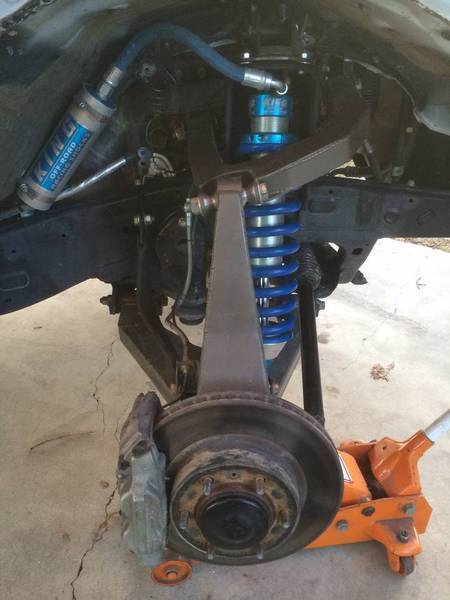

    Is there any room for improvement if switching to an engine cage or is this kit basically at full potential with stock coil bucket?
  15. Jun 11, 2014 at 10:36 PM
    #155
    jjhitchen
    jjhitchen Relentless
    Sep 4, 2012
    #86272
    1,002
    Joel
    Arroyo Grande, CA
    2012 4x4 V6
    100% stock Tacoma
    To my knowledge, the kit is limited on up travel by the inner fender. With an engine cage and removed inner fender the kit would then be at full potential and yeild 16" of functioning 4wd. With the inner fender I am bumped and strapped at 14".
    The uppers and lowers are designed to bolt onto the stock mounting locations so keeping the stock bucket would probably be ideal. But if you are going to engine cage you could probably make new mounts and cut out the coil bucket.
    I will say, the 14" of travel my 4wd kit pulls now really pushes my rear lt to its limits. I want links and this kit rocks.
