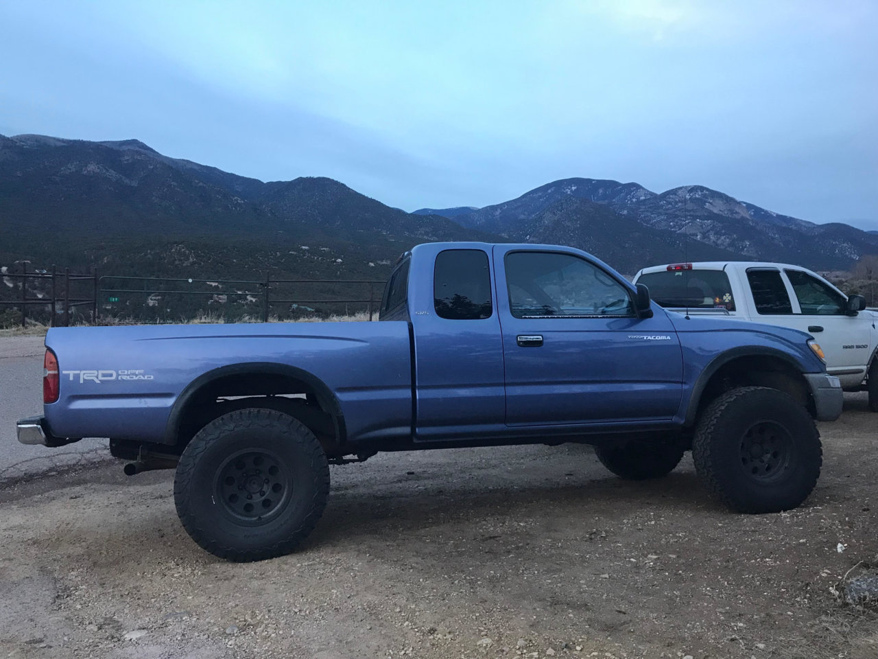

    2000 3.4 Ext Cab 4x4 5-speed
    Adventure build
    Dirtbag Build
    Documenting the adventure-mobile of 2 people and our dog Eska
    Shameless plug for Eska’s Instagram
    Currently (201k miles):
    As of May 2019
    Calling it the Dirtbag build because we have lived out of it before and we probably will again.
    Specs
    -2000 SR5 TRD Ext Cab
    -Rear Diff Lock
    -Manual Transmission
    -4x4
    -5VZ-FE 3.4L V6
    Exterior Mods
    -Craigslist special high-rise camping shell
    -Custom-built Sleeping Platform
    -Custom Roof-Rack from Rack Attack
    -Thule Roof Box
    -Stickers!
    -Plasti derped some chrome
    Armor
    -Skid Row Skids
    -Line-X Bedliner
    -4xinnovations front & rear plate bumpers
    -4xinnovations sliders
    Front
    -Sway-Away 2.0 adjustable coilovers P.O
    -ADS 2.5 coilovers with 650lb coils and remote reservoirs
    -Camburg Uniball UCA’s P.O
    -Swaybar delete
    -Engine splash guards from Gear Tech Customs
    -Durobump bumpstops
    Rear
    -Custom 9.5in travel ADS piggyback reservoir shocks
    -Custom Alcan Leaf Pack 2.5in lift and 300lbs over stock capacity
    -Bilstein 5100's
    -Deaver 3 Leaf aal P.O
    -Bamf BPV Relocation Bracket
    Wheels & Tires
    -33/10.5/15 BFG KO2’s
    -American Racing Mojave wheels P.O
    Interior
    -Custom-built dog platform
    -Kicker Speakers
    -Grey wire mod
    Accessories
    -Rigid Ditch Lights w/ Rago brackets
    -Hella Sharptones Horns
    -60in Hi-lift Jack
    -Cali Raised light bar
    -Rigid SRM reverse lights
    -Rigid fog lights
    -Xbull recovery tracks
    Maintenance I’ve Done
    -Spark plugs and wires
    -New radiator and silicone coolant hoses
    -Sealed cracked airbox
    -Replaced driver door handle & tailgate handle
    -LBJ’s
    -Outer Tie Rod Ends
    -CV from CVJ Axles
    -Synthetic Fluids
    -Replaced front Timbren bumpstops w/ oem bumps and shimmed to stop rubbing
    -Replaced window trim
    -PCV valve
    -Extended rear diff breather
    -LED dome light
    -Marlin Crawler shifter bushings
    -Front diff bushing from Durobumps
    -Cleared up hazy headlights
    -Extended rear brake line from Wheelers
    -Valve Cover Gaskets
    -Roll pin mod
    -Painted hood
    -NorthStar battery
    -Rebuilt UCA's
    -Brembo rotors & Akebono pads
    Upcoming
    -Rebuild Topper (paint, insulate)
    -Paint roof
    Future
    -Stronger rear leaf springs
    -Softopper
    -New gears (probably 4.56)
    -Roof rack for topper

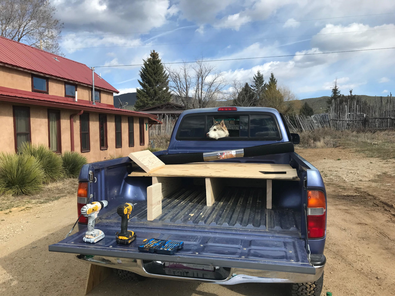

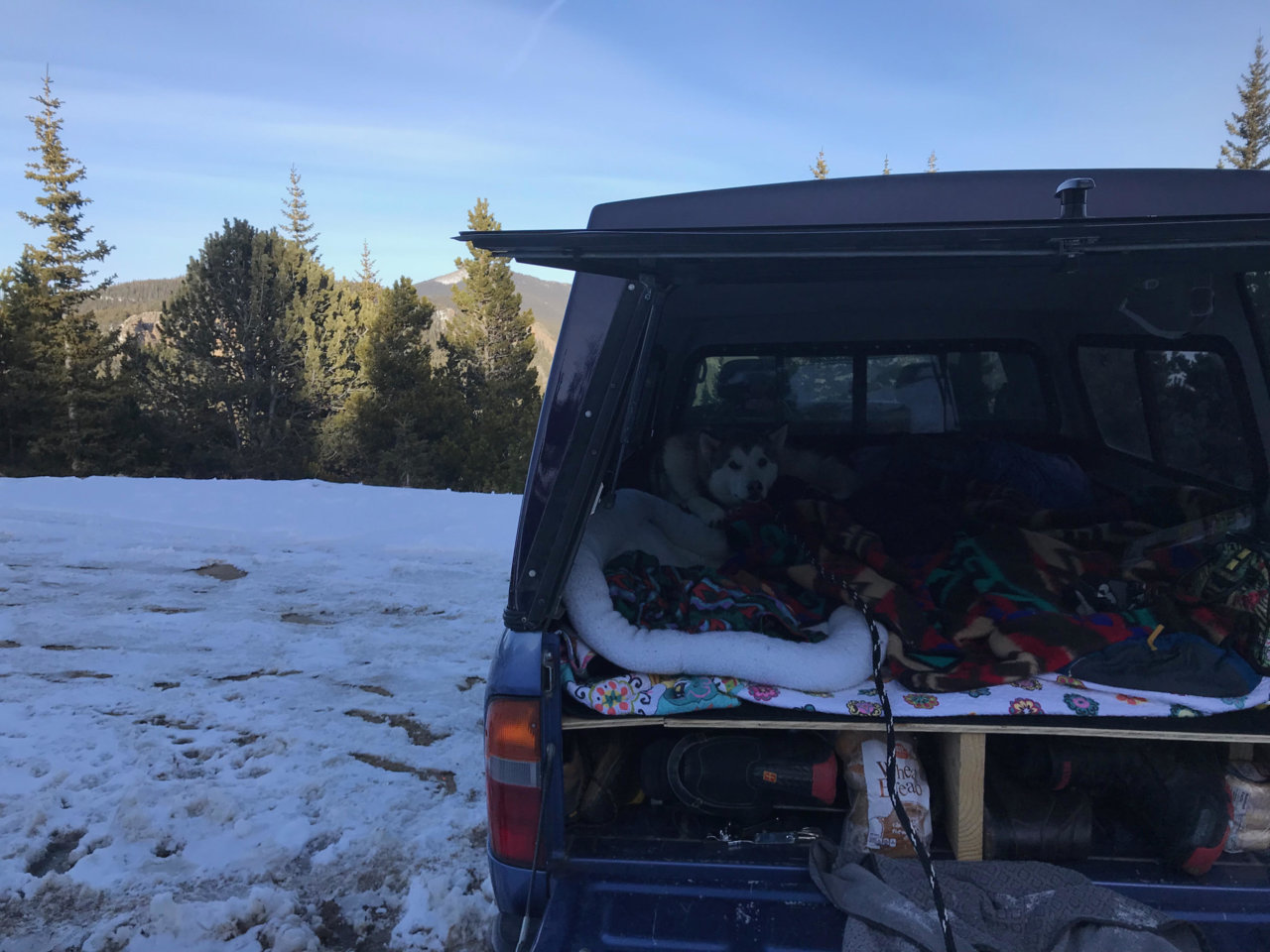

    We had decided that after our season was over we were going to live out of the bed of the Tacoma while we used up our ski resort comp passes and took the long way back to Wisconsin.
    That required 3 things, catch up on maintenance, build a sleeping platform and get a topper. All before moving out of our house on April 1st.
    I replaced the spark plugs and wires, sealed the cracked airbox to clear a too lean code and installed a new air filter, replaced the radiator and coolant hoses to stop a leak and swapped all the fluids over to synthetic. Then we got new tires and built a platform for Eska so she’d be comfy riding in the back seat.
    Getting a topper proved a lot more difficult. We looked for a long time and didn’t find one until a couple days after we had already moved out of our house.
    After the trip started we very quickly got tired of 2 things, the blown speakers and moving our snowboard gear to the cab when we slept. To remedy problem one we stopped at the local best buy and picked up some kicker speakers. Nothing like the looks you get ripping apart your door panel in the parking lot. Then for problem 2 we got a custom roof rack with Thule box installed by Rack-Attack.
    Then while offroading to find a camp spot we started hearing clunking in the rear. Turned out our shock had snapped and was clanging around. We were able to find a store to order up a pair of Bilstein 5100’s.
    The only thing funnier than parking lot maintenance is doing repairs in the Toyota parking lot right in front of the service department with an old wrench and a block of wood. I needed a new radiator cap (ours wasn’t sealing) so we went to the nearest Toyota dealership to snag a replacement. While there I swapped out the shocks in the parking lot in front of the service entrance while getting strange looks from people bringing in their sparkly brand new Toyotas for oil changes. After installing the shocks our setup was pretty dialed in. We traveled around Colorado snowboarding and sleeping in the mountains.

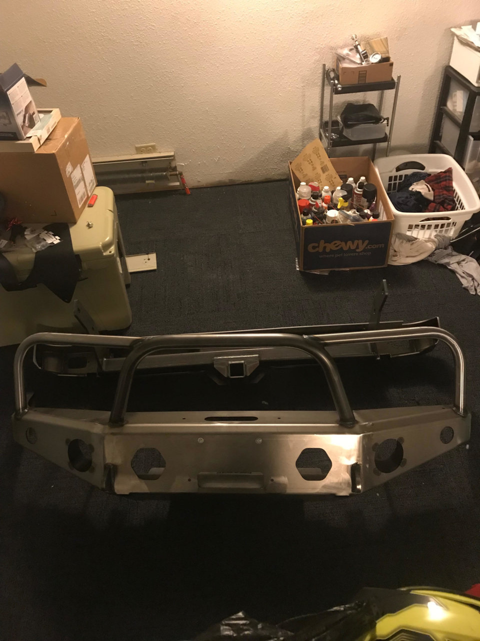

    Adventure build
    Test fit and ready for paint.

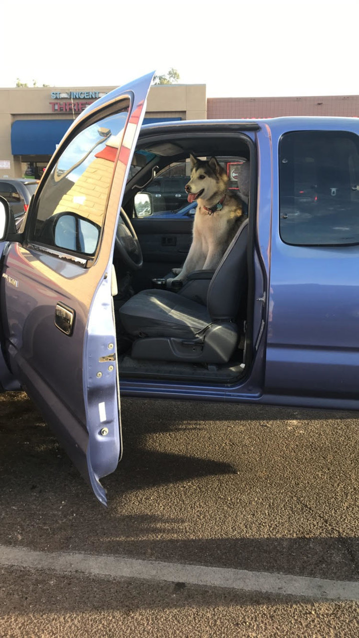

    Eska climbed in while i was working on the truck. She can't wait for the next road trip.

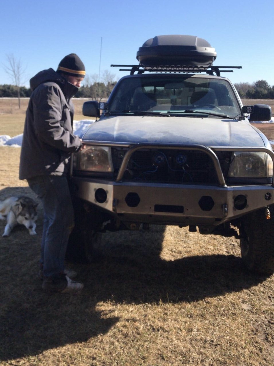

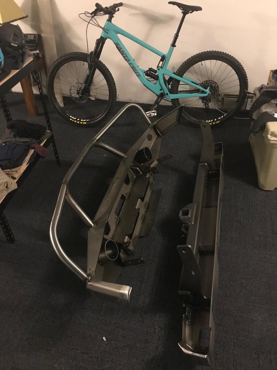

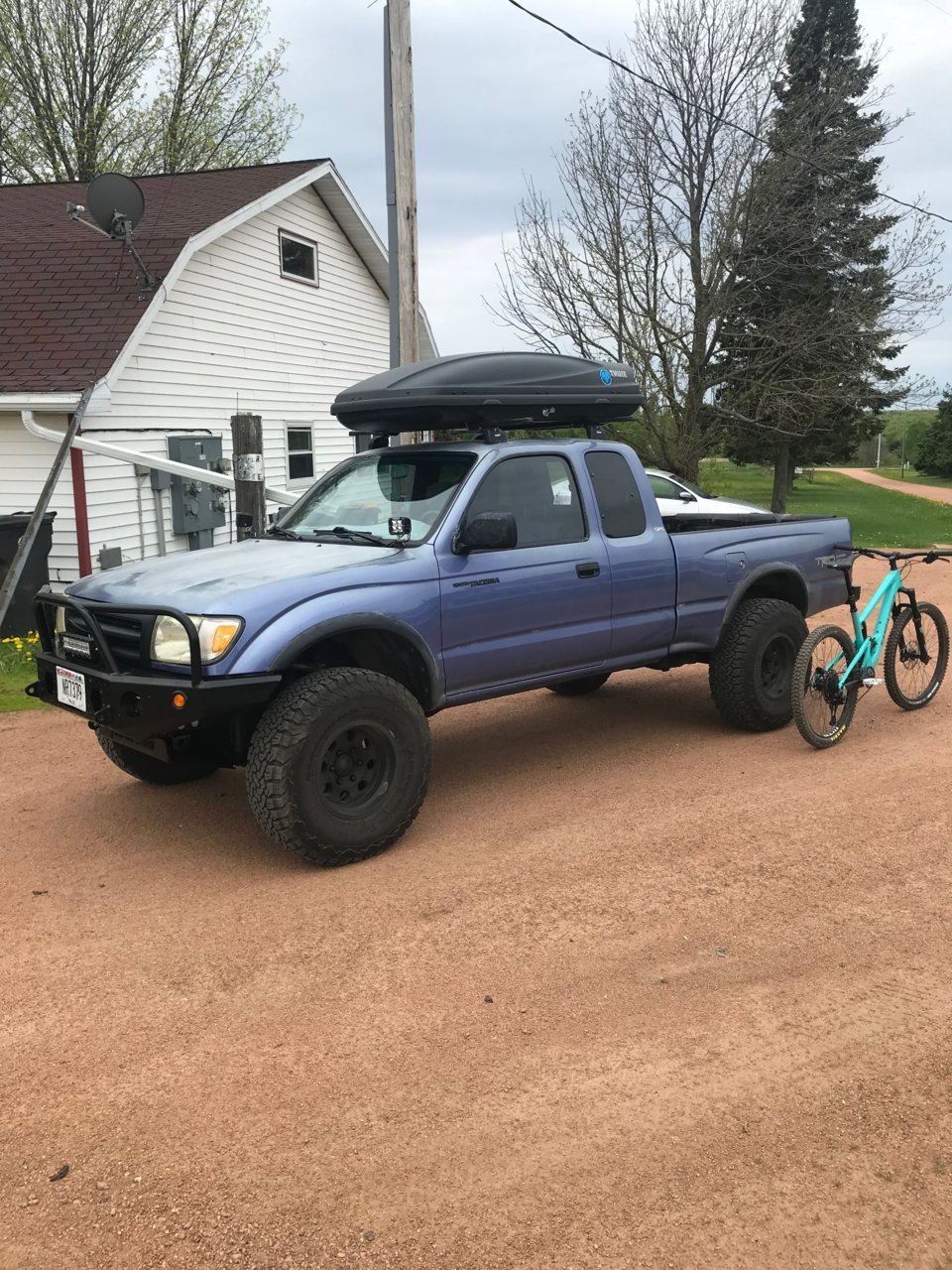

    Well I finally installed the 4xinnovations bumpers. They are awesome, I would highly recommend.

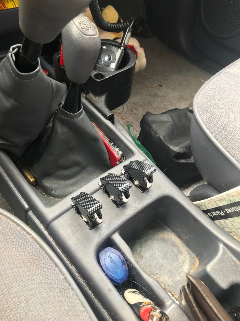

    In the meantime though i wired up some switches.
