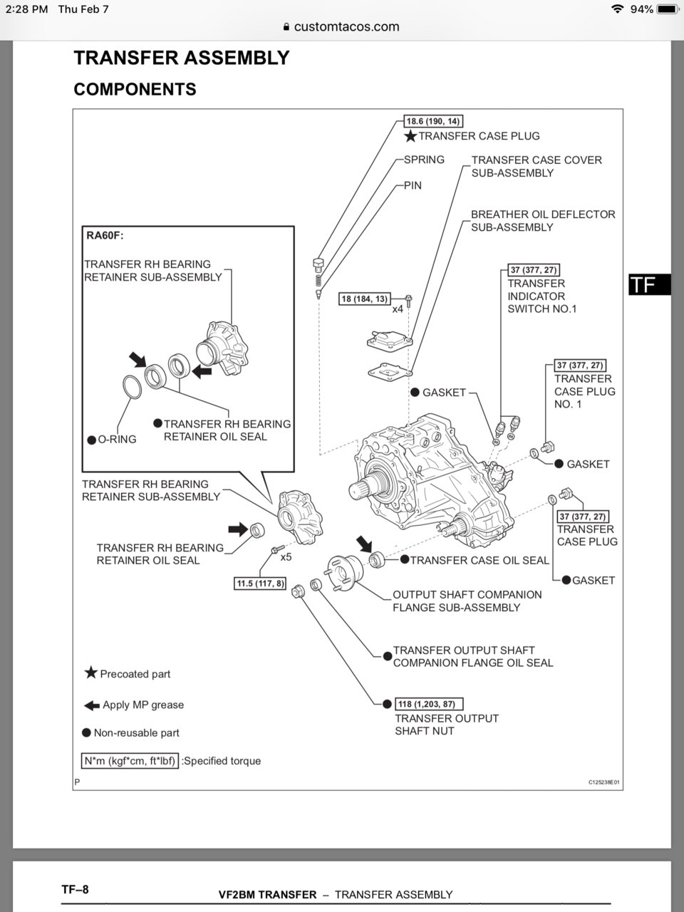

    Yes, but It’s hard for me to imagine all that sand you said you had got past the seal.

    Yeah, both the T-case and trans should have a breather. They run up into the engine bay, on the drivers side

    Yeah what he said. I highly doubt sand traveled all that way from the breather into the t case.

    Are we sure the sand wasn’t already in the bucket when the TC was drained. I just had to ask.

    Not a bad question by any means. Although I think he said it was on the drain plug too.
    Either way, I'm not buying the fact that sand got in the t-case. I just don't see how that's possible under even extreme circumstances.

    Not saying it is sand but there was definitely a muddy substance on both drain and fill plugs. From what I could see inside from the drain hole there was also a muddy substance inside the t-case. Its definitely not metal shavings either.

    Could it be bearing seal material?

    Does the residue burn or melt? Maybe it's plastic? It could be brass or other ferrous or non-ferrous metal too. Maybe you can dump some of that "sand" in some clean clear solvent and see what it is after it settles and separates
