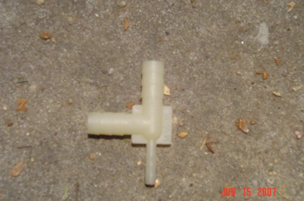

    This is a 1/4" x 1/4" x 1/8” “T” You can pick these up at any Automotive store for under $1.00

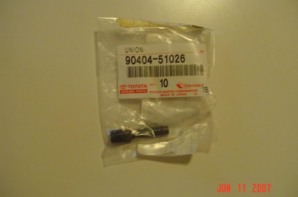

    Here is a picture of the Toyota Camry “Union” part number # 90404-51026

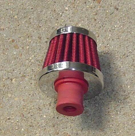

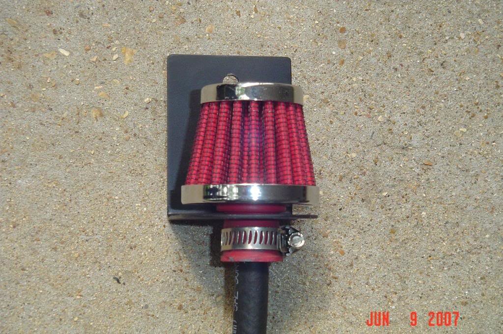

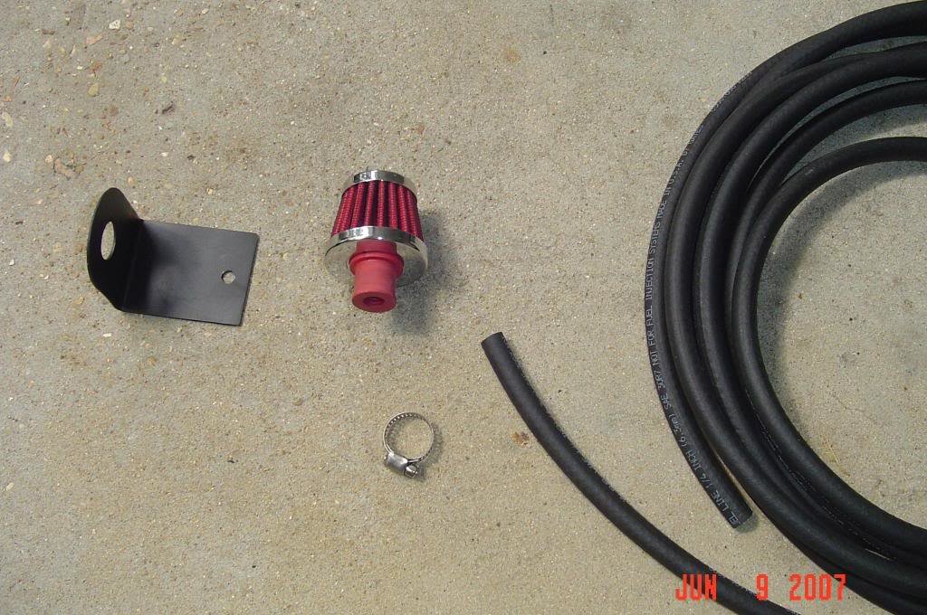

    I found a nice small air breather from AutoZone, $9.95 It’s made by “Spectre” Part number 3992, they come in different colors, Silver, Blue, Red, Yellow,etc. The following are pictures of the small colored Filters, they are very similar to a K&N filter. I used a little oil on mine to keep it water proof too.
    I went ahead and did the leg work for everyone for the small colored breathers.
    Here is the following part numbers for the colored filters
    Specter Part number # 3992 Red Breather
    Specter Part number # 3994 Yellow Breather
    Specter Part number # 3995 Silver Breather
    Specter Part number # 3996 Blue Breather
    Specter Part number # 3998 White Breather
    Here is the web site : Spectre Performance - Official Site
    You can also find them in your local automotive store too.
    I decided to stay with the TRD theme, (Red). I also purchased 20 feet of ¼ fuel line for running the hose to the engine bay. I shopped around a bit for it, Pep Boys wanted $1.85 a foot, I found it at O’Reillys for .85 cents a foot.

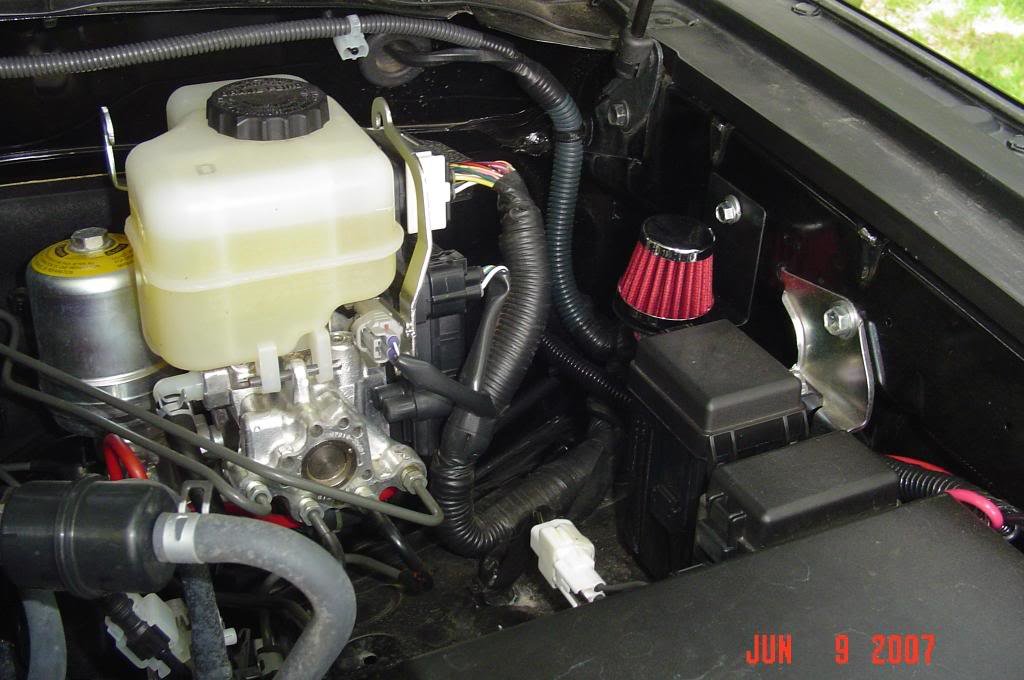

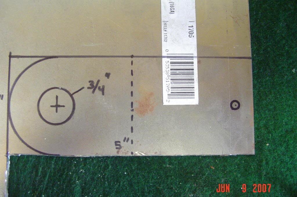

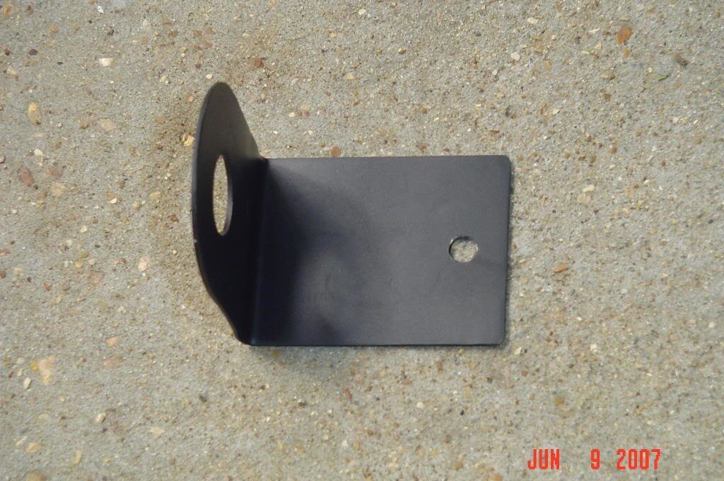

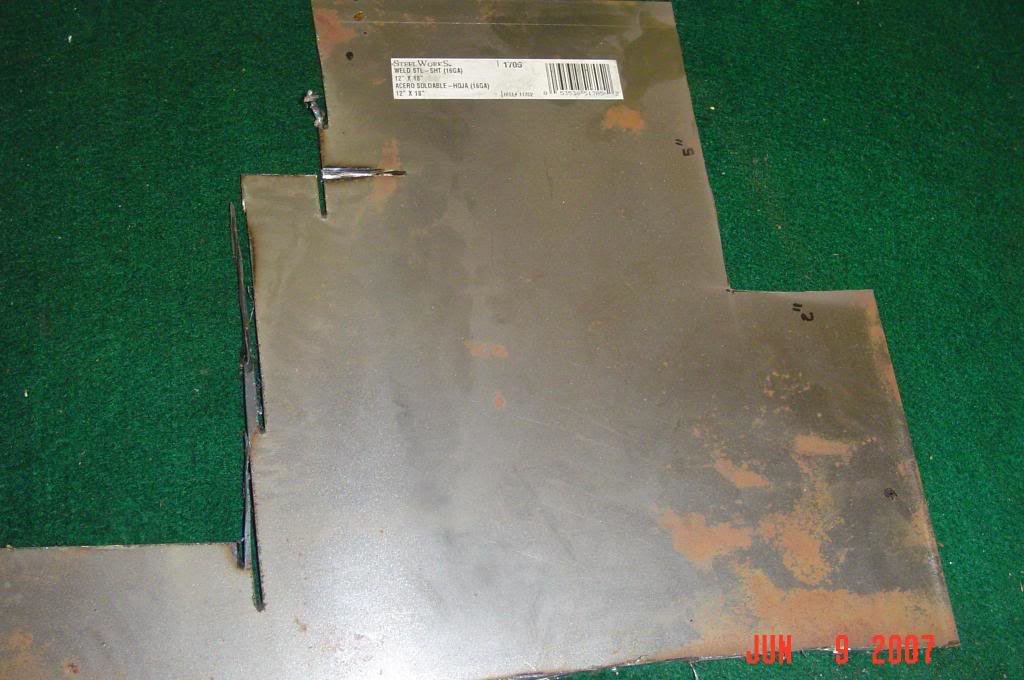

    I had some 16ga steel left some from my CB mount MOD and Fuse box MOD, so I used this material for making my breather bracket. You can purchase this at Lowe’s or Home Depot for under $10.00 I decided along the drivers side close to the firewall for the breather location.
    I measured a 2” wide, 5” long would be just right for the bracket. I also decided to make one end round. I used my dremmel tool with cut-off wheel to cut the shape out; you can use a handheld grinder, etc. I then drilled out a ¾ inch hole for the filter. I then bent the bracket 2.5 inches back from the top of the bracket. My wife had the camera so, I couldn’t take any pics of the bracket at this stage.
    I then sprayed the bracket with gray primer, then a coat of flat black.
    I bought a self tapping metal screw with lock washer for attachment to the firewall.

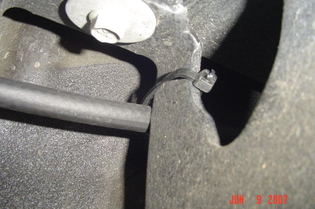

    I attached the breather to the bracket, then the hose to the breather, then ran the hose along the bottom under the vehicle.
    I attached the hose with tie wraps along the frame.
    In this pic you can see I left a good portion of the hose and then cut it off, tie wrapping it to the cross bar. Please don not cut the hose off to short, you want to leave enough room for your rear axel to be able to articulate without pulling out the hose from the Union.

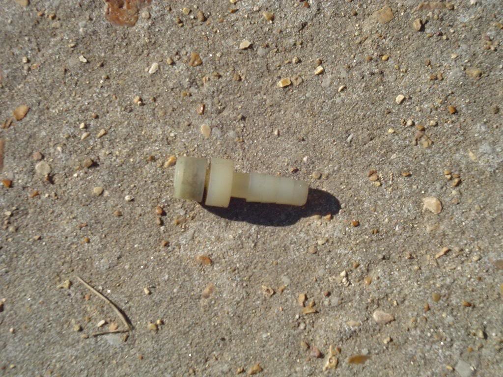

    The new Union installed.

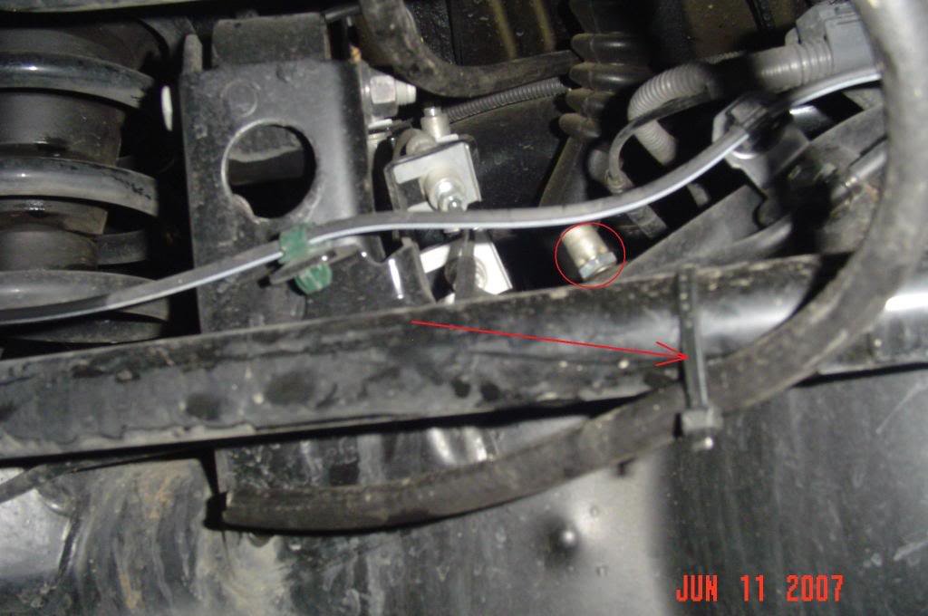

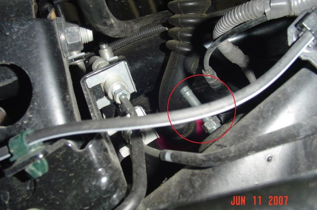

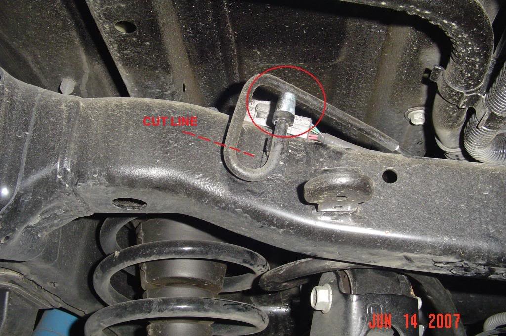

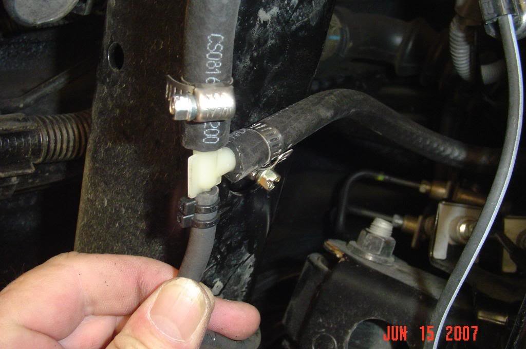

    This is a pic of the existing E-Locker location, This is what we are going to remove and install the “T” to. You need to cut about 3-4 inches from the locker hose breather end off. See the "CUT Line in the above pic. Then push the "T" into the small locker hose. I then used (2) small ties wraps for securing it, hose clamps are to small.

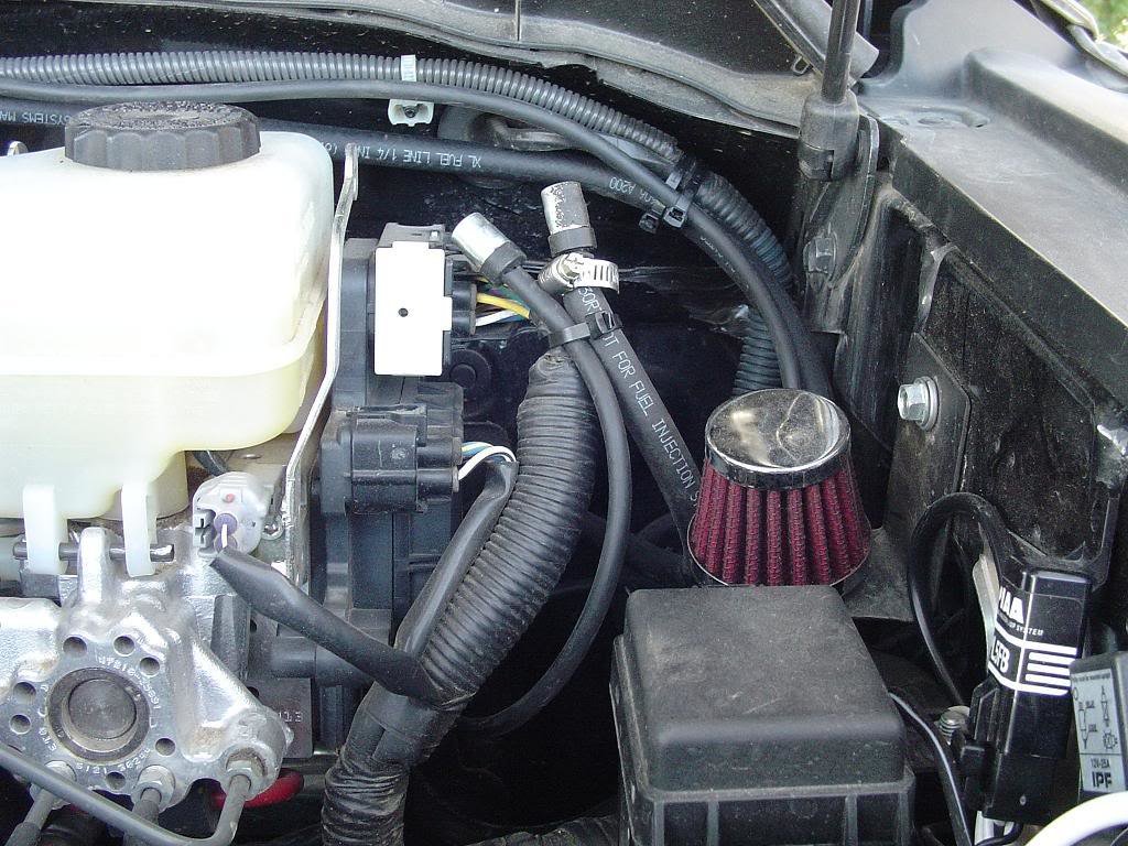

    The newly installed "T" run from the Rear Differential Hose & E-Locker then into the Main hose which runs all the way to the engine bay.
    Finished Rear Differential & E-Locker Breather location in the engine bay.

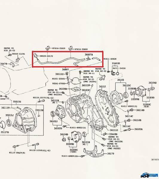

    Auto Transmission & Transfer case breather location & information for relocation of breathers.
    A new member Jim (007FJ) took the time to wade through hundreds of pages of the Repair manual to find the Transmission Breather and Transfer case breather locations. I new they were there, but never took the time to go find them since they were located higher up inside under the vehicle. With that being said, I too will be relocating these too just like the rear differential and E-Locker breathers. If your running in deep water it pays to take the time and relocate all your breathers up high to prevent damage to the drive train. Thanks again Jim and to the others that have helped to make us all water tight out the on the trails.
    Here are the following Schematics of the locations of the AT Transmission & Transfer Case breathers.
    Auto Transmission Breather Location (MT doesn't have this Breather)
    Here is the MT (Manual Transmission Breather Location)
    Transfer Case Breather Location
    These will need to be relocated up high also either in the engine bay, rear jack storage area or somewhere up high out of the way of any water getting to them.

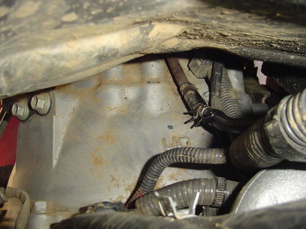

    If you open the hood and along the passenger side towards the rear of the the top of the engine, you need to reach down inside and feel. You will find (2) breathers right on top, a plastic one (this is the Automatic Transmission Breather) and a small silver cap one like the E-Locker breather. Both of these need to be removed and placed higher inside the engine bay.
    I reached down between the firewall and the rear of the engine and squeezed the hose clamp holding the Plastic AT breather on, I slid it downwards out of the way. I then twisted and pulled on the plastic breather, it pulled off pretty easily.
    The AT Transmission Breather after removal

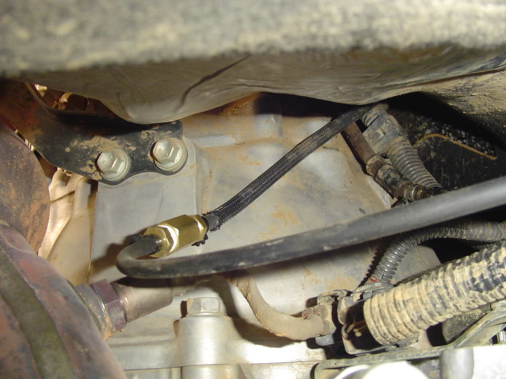

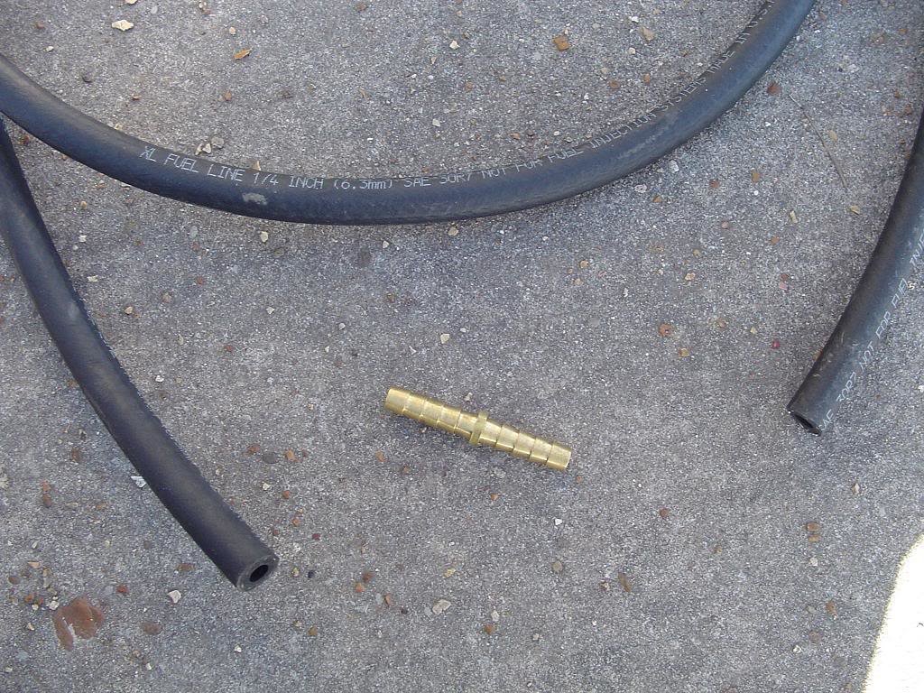

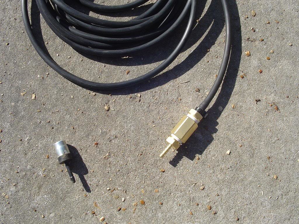

    I then took some ¼” hose with a ¼” brass coupling and attached it to one end of the hose, securing with a tie wrap. I then sprayed WD 40 on the other exposed end of the brass fitting to allow an easy transition on to the hose. It slid on nicely, I then used another tie wrap to secure that end on to the hose.
    New Hose & Coupling to run the breather up into the engine bay higher.
    Newly installed Coupling coming from the the Transmission.

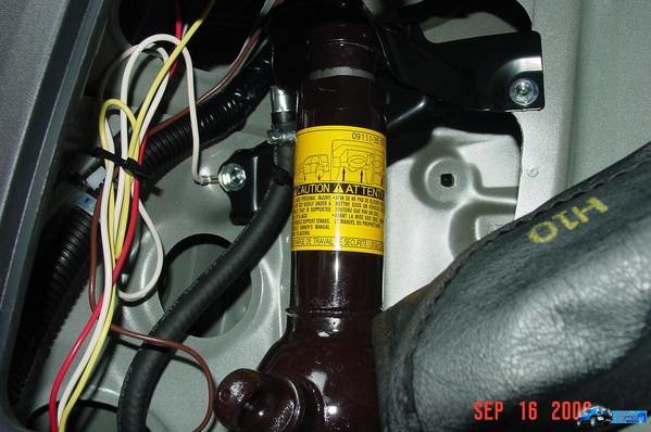

    I then reached down between the firewall and the rear of the engine and grasped hold of the Transfer Case Breather, it is the metal one like the locker. This one is very easy to remove, just pull firmly and it will slide right off. I then put together another brass 1/8” coupling and installed it on one end of the 1/8” hose. I secured it with another tie wrap. I reached down and slid this one on to the remaining hose. I again secured it with another tie wrap to keep it from coming off.
    New 1/8" Hose and Coupling to run the breather up into the engine bay higher.
    Newly Installed Coupling coming from the Transfer Case.
    The finshed run of both hoses located higher in the engine bay. I will at a latter date replace the stock valves with a Filter like the Rear Differential and E-Locker.

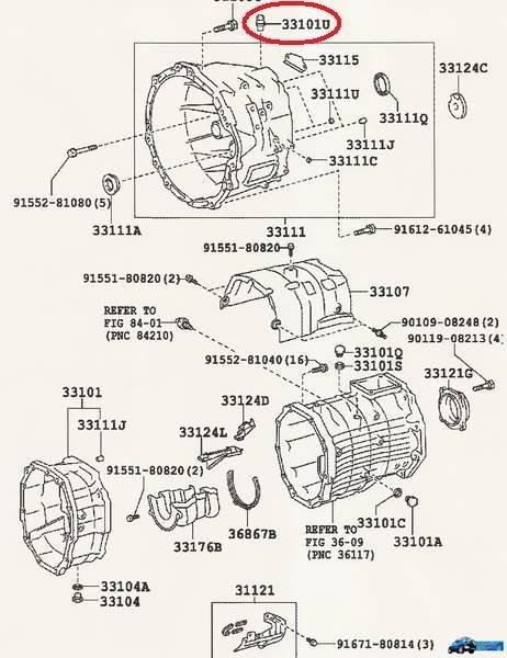

    Well I found the T-Case and M/T Breathers thanks to your diagram Shadow-Warrior. thanks, I've been looking for this info for a while. Now that i found them i have a question for anyone who can help. The T-Case breather runs on top of the tranny up to the back of the engine and has a decent foot of slack laying up against the rear of the engine. However, the Manual Transmission Breather is another story.
    Does any one know if it is pressed in and requires removal of the tranny? Also, what does it look like under the silver cap? Could I pull the cap off and just hook a hose to the union tube underneath it (if the shape of it underneath the silver cap will suffice)? Or does it simply unscrew. i felt it and it seems circular with no edges for a wrench or pliers...
    I made a video so all could get a good look and put in their 2 cents (and hey, it may help someone to locate it easier i guess, hope im not crowding your thread just seemed like the logical place to put it...)

    Great video and better questions - I do think that they are screwed in.
    Have you checked the Factory Service Manual?

    thanks for looking into it. i too was trying to find replacement procedures for it. i found that they use the 33101U on most M/T even in their cars. the replacement for it is actually a different part number but i can find no procedures for removal.
    I just hate to try and remove and ruin something. a nice easy fix would be if you could just pop that silver cap off and hose clamp a line to it. not sure what one looks like with the silver cap off. i'm tempted to sacrifice the one i have in my fuel door for the time being...
    this is the replacement part # i believe. its for a 99 rav4 but ive seen the same part for certain toyota cars so i think it is a pretty universal component for their M/Ts. they make it sound like it is replaced with a different part. 90930-03148
    33101U PLUG, BREATHER(FOR MANUAL TRANSMISSION) 90930-03148
