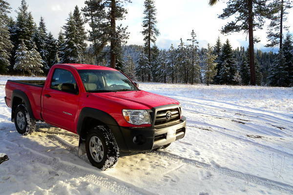

    ABS was fine on my new snow tires. Was goin down the freeway in 2wd at 50-60 mph in 3-4" of snow and no sliding or spinning! Went 50 in 4wd to pass trucks and lines, not worth getting risky and i want more time and conditions to test em still.
    Conditions were no gravel on road yet, 28 degrees or so, 3 inches of snow, with packed ruts from previous traffic. 3500' or so snow level.
    1-2" at camp, went elk hunting. Sadly no success this year.
