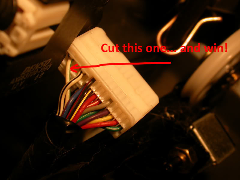

    I got bored today after work & decided to verify that what worked on the 2000 model year Tacoma with the 3.4L 5VZ-FE also works on the 2000 4Runner with the 3.4L 5VZ-FE in it.
    As described above, here is the caged heatsink & the grey connector:
    Disconnect it & DRL is disabled without disabling anything else. The headlight/foglight controllers on the steering column work as you'd expect as well as the high-beam indicator. Hopefully lifetimeledlights.com will still honor their warranty, this was my 4th pair with the low beams fried.

    I finally did this - cut the white wire with the green stripe on my 01. Thanks for the info.

    Im still a bit nervous to even jsut cut the damn wire.. but I really want to so I could get retrofits

    Why are you nervous? Just cut it with some slack so if you don't like you can splice it back together

    It's not like you're messing with your brake lines or anything, it's just a little wire for unnecessary lights. Worst case, it's easy to put back together. Just clip it!

    Hate to revive such an old thread but was wondering how you got the pin removed from the harness? I have been messing with mine for an hour and the thing won't budge at all.

    First, on the wire side of the connector you have to flip part of the plastic up. It's snapped closed.
    Then the terminal is also held in by a small plastic tab/hook, so you have to stick a small screwdriver or pick in the other end next to the contact to release it. If you do it right you just give a slight pull to the wire when you have the screwdriver in there and the wire should slide out.
