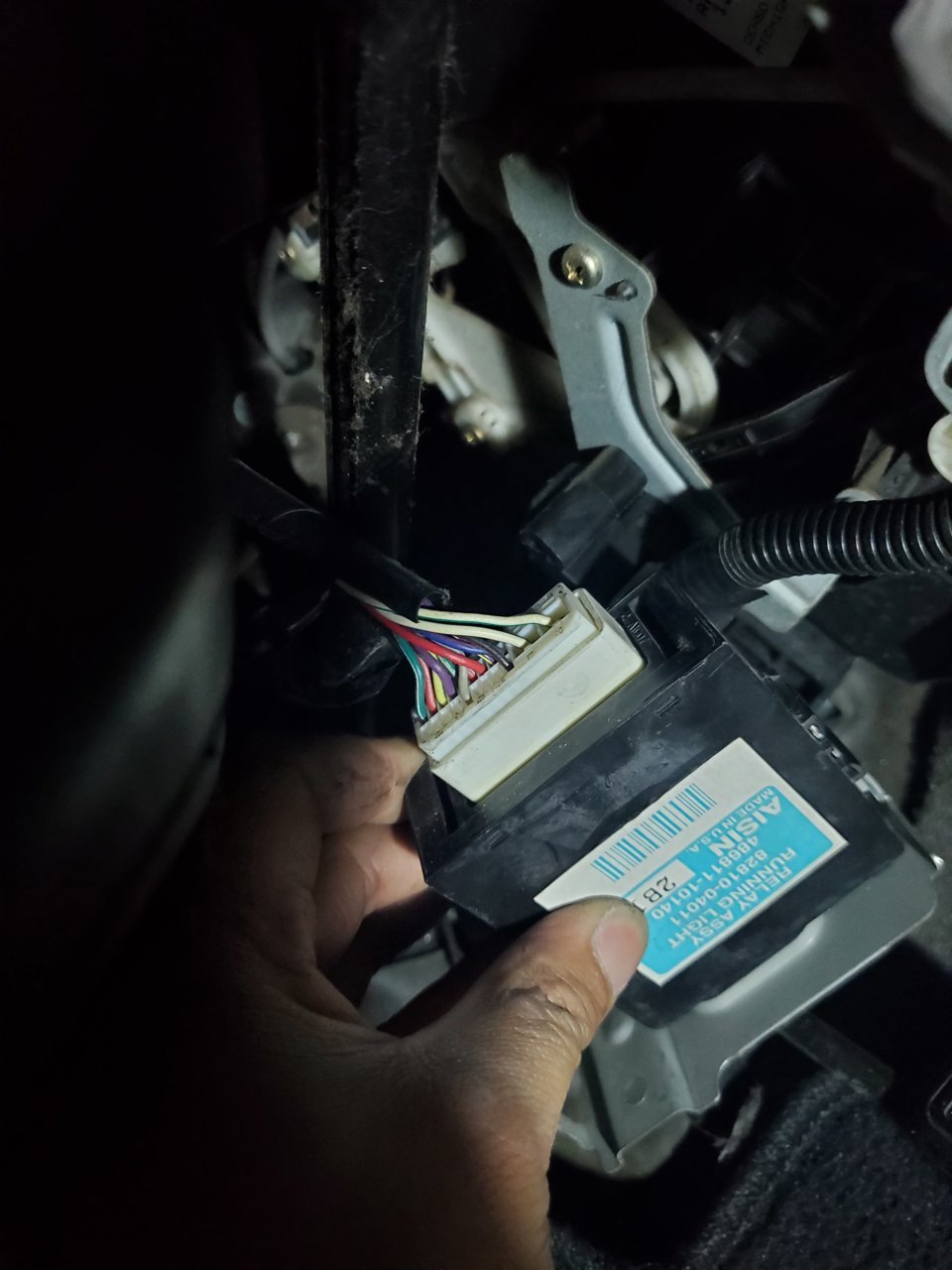

    I used a small flat head screwdriver, the ones you use to tighten the little screws holding the temples to the glasses. The screwdriver needs to enter the end with no wires. What you see is the back of the connector so you need to insert it at the other side and that’s where the little clip holding the wire is. I’ll take another picture for everyone to see.
    Don’t cut the wire, I’ll share pictures how to remove the terminal with the little flat head screwdriver.
