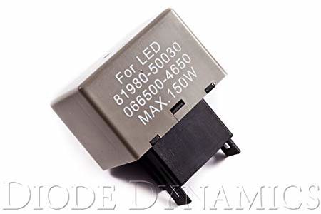

    By the way is this the flasher you are referring to "2005-2013 Toyota Tacoma LED Turn Signal Flasher, LM 449 (CF18)"Flasher.jpg by Diode Dynamics?
    https://www.amazon.com/SmartTap-CF1...sher&qid=1553612851&s=gateway&sr=8-1-fkmrnull
  7. Mar 26, 2019 at 8:29 AM
    Muddinfun
    Muddinfun Well-Known Member
    Apr 17, 2017
    #216500
    7,489
    Yes, that's it.

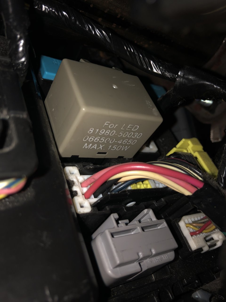

    The grey plastic jumper block (part number 82671-30360) Plugs into the back of the fusebox here. I don't know what you're trying to do, but take that DTRL 3 way harness and give it to the dog for a chew toy.

    So, ??? That last pic is showing the smarttap flasher and the jumper block that you have? If so, that's not the 82671-30360 jumper block.

    This is what the jumper block looks like. Top right of the pic.[​IMG]

    Here's where you are getting confused. 81980-50030 is NOT a jumper block. That is the part number for a OEM Toyota FLASHER without DTRL.
    82671-30360 IS the correct gray plastic jumper block for your truck. The grey plastic jumper block and the smarttap flasher will work on your truck.
    14489 likes this.
  19. Nov 1, 2020 at 2:40 PM
    #19
    Muddinfun
    Apr 17, 2017
    #216500
    7,489
    The reason that Toyota flasher and the smarttap flasher look the same is because they ARE essentially the same. Just 1 works with LEDs and the other does not.
    14489 likes this.
  20. Nov 1, 2020 at 3:01 PM
    #20
    Muddinfun
    Apr 17, 2017
    #216500
    7,489
    With the DTRL 3 way harness and DTRL flasher, the front and rear turn signals are separate so you don't end up with rear DTRL. When you eliminate all that crap and plug the Smarttap flasher directly into the fuse box, you only have rear turn signals. That grey plastic jumper block simply connects the rear and front turn signal terminals together. Forget about that "DTRL module" term. I don't know where you got that. There is only a flasher with DTRL and a flasher without DTRL. Does all that make sense?
