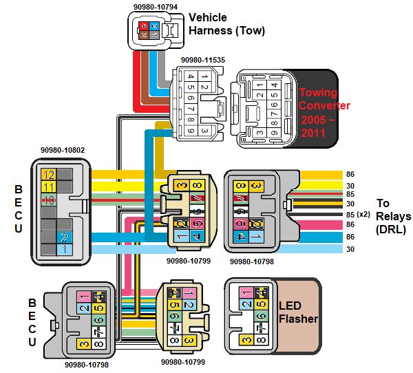

    That is what the harness does, adds a trio of mini relays for DRL, and the 2005+ towing converter module returns the towing lights. The Towing converter would pass the strobe/wig wag feature to the trailer too.

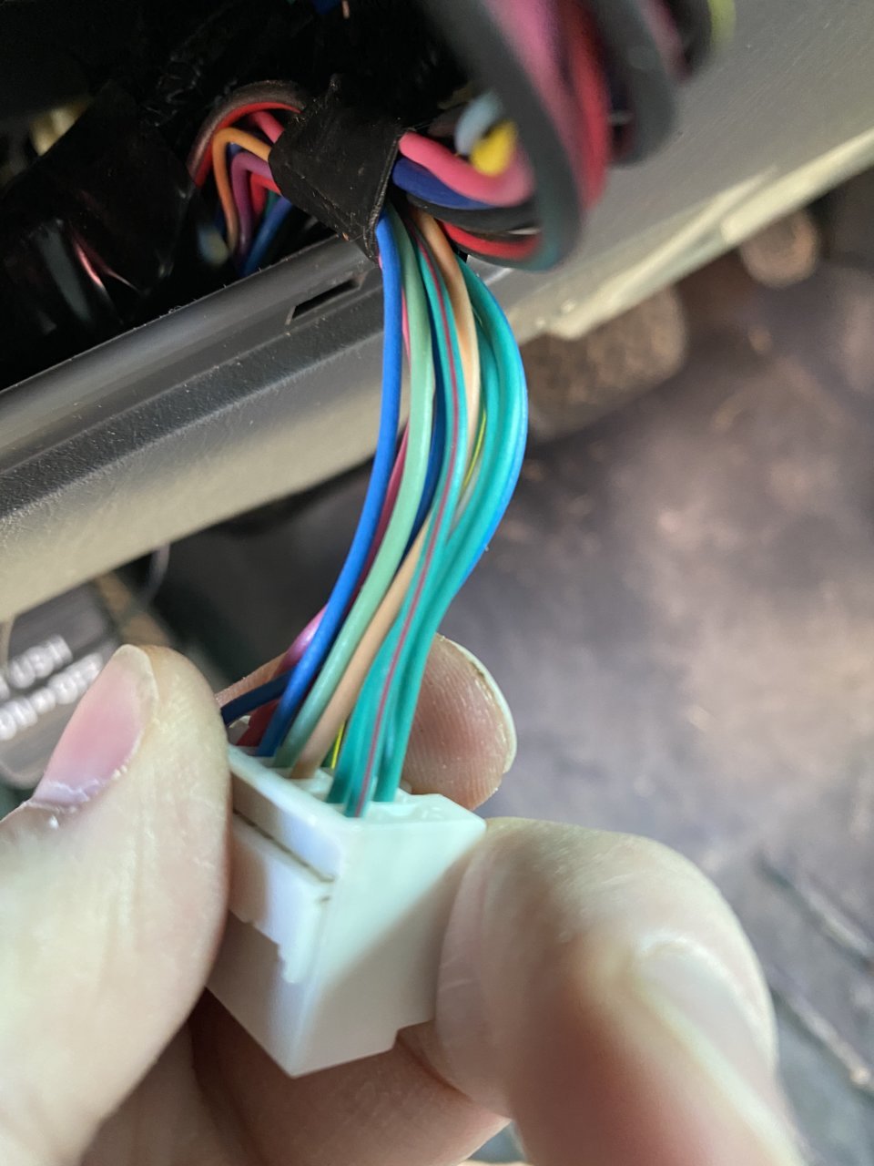

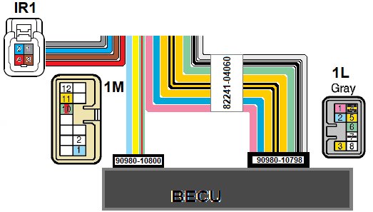

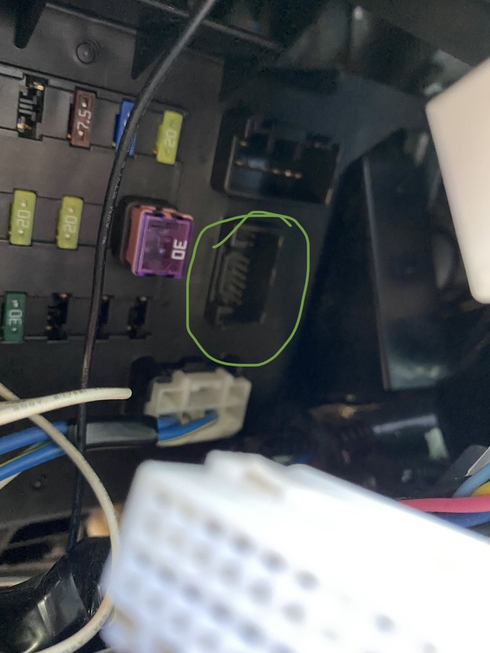

    Just for the people who don’t understand, I’m a cop and work side jobs where I end up parked in a dark corner throughout the night, I’d like to turn off the DRL, that’s my reasoning. truck is a 14, I don’t intend to ever sell it, so I’m in the “cut the wire” camp. I cannot for the life of me get my bear paws behind the fuse panel, however I found a green wire with a red tracer plugged into the front of the panel. I tried to de-pin it, but I don’t have a small enough screw driver to get in there and pop it loose. Can anyone tell me if this is the proper wire that I need to cut? First picture shows the wire in its home, closest one to you, second is the receiver for the plug circled in green. It’s the middle plug on the panel, closest to the steering wheel.

    Nooope. The one you seek is on the opposite side.
    Redfish89[QUOTED] likes this.
  11. Jan 17, 2021 at 10:39 AM
    #31
    caribe makaira
    caribe makaira Well-Known Member
    Feb 13, 2011
    #51121
    11,793
    Caribbean, Puerto Rico
    05 PreRunner TRD Offroad AutoTrans
    Hood Struts, My version Fogs always ON, Map & Overhead Light Mod,

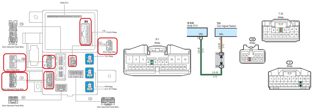

    Pin #10
    It's on 1M to T20.

    Redfish89
    Redfish89 Active Member
    Sep 9, 2018
    #265764
    32
    Andrew
    2014 Tacoma, spruce mica
    Dang it, was afraid of that. Thank you.
  13. Jan 17, 2021 at 11:16 AM
    #33
    caribe makaira
    Feb 13, 2011
    #51121
    11,793
    All on back side of BECU...:playball:

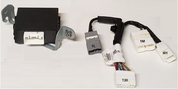

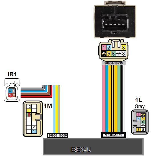

    The OEM harness the Tacoma has would have to be removed from the its connection on the Body ECU. The side where the LED flasher would go is the same as the harness removed. The connector to the original flasher/drl would not be used. The wires would be reused. The location of the 2nd Gen towing converter could be secured in same location as the original flasher/drl. You need a connector to mate the LED flasher and a connector to the towing converter. An additional mating set (same kind as for the LED flasher) for the required DRL duplication relay trio.
  20. Jan 22, 2021 at 9:55 AM
    #40
    caribe makaira
    Feb 13, 2011
    #51121
    11,793

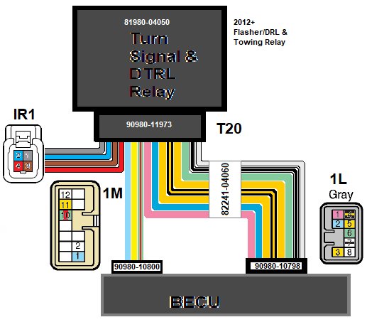

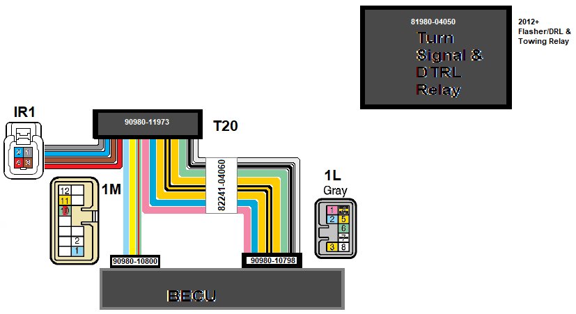

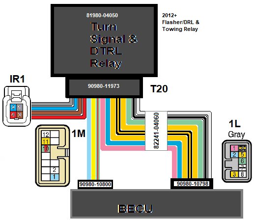

    This what your Taco has:
    Remove the connections to the vehicle and remove the "T" harness. (82241-04060) and remove the Turn/DRL relay.
    De-pin the connector to T20, set connector aside with the removed relay.
    All the wires from 1L will go to new connector 90980-10799, this mates to the LED Flasher.
    Don't insert the wires into connector yet. You will tap and heat shrink into the ground, fused ign, and fused battery wires before inserting the terminals into new connector.
    On connector 1M you'll need to assemble 2 wires with male and female on each end. These go into 1M and into another connector of the same type as for the LED flasher.
    This is your finished harness. (without the DRL relay part)
