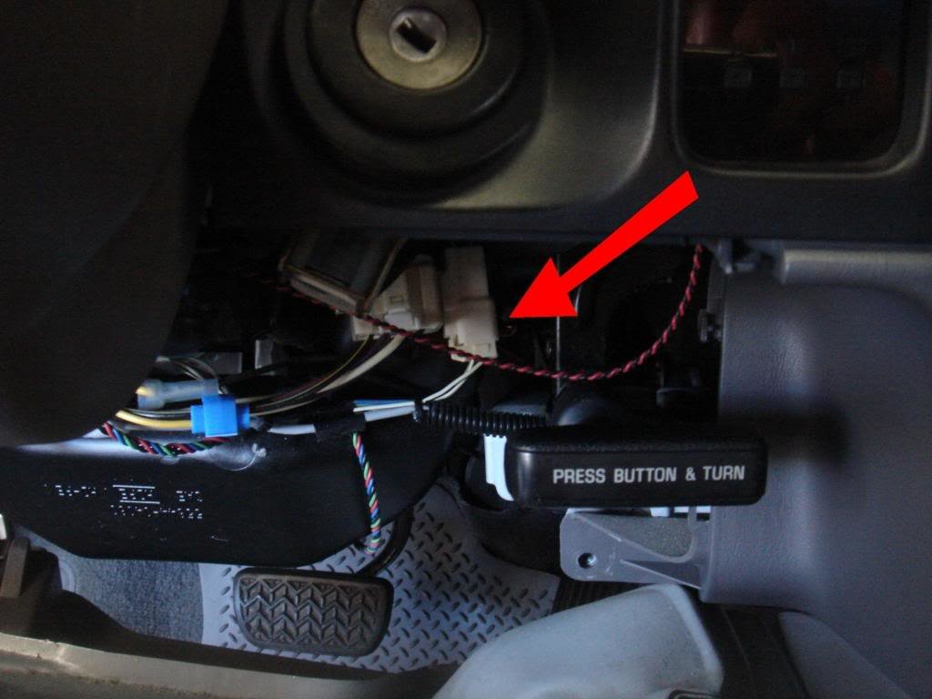

    Step 1.
    Remove the panel under the steering wheel column. You'll need a phillips and a socket wrench.
    Step 2.
    Find this clip and harness. Should be positioned directly below the ignition and near the parking brake.
    Step 3.

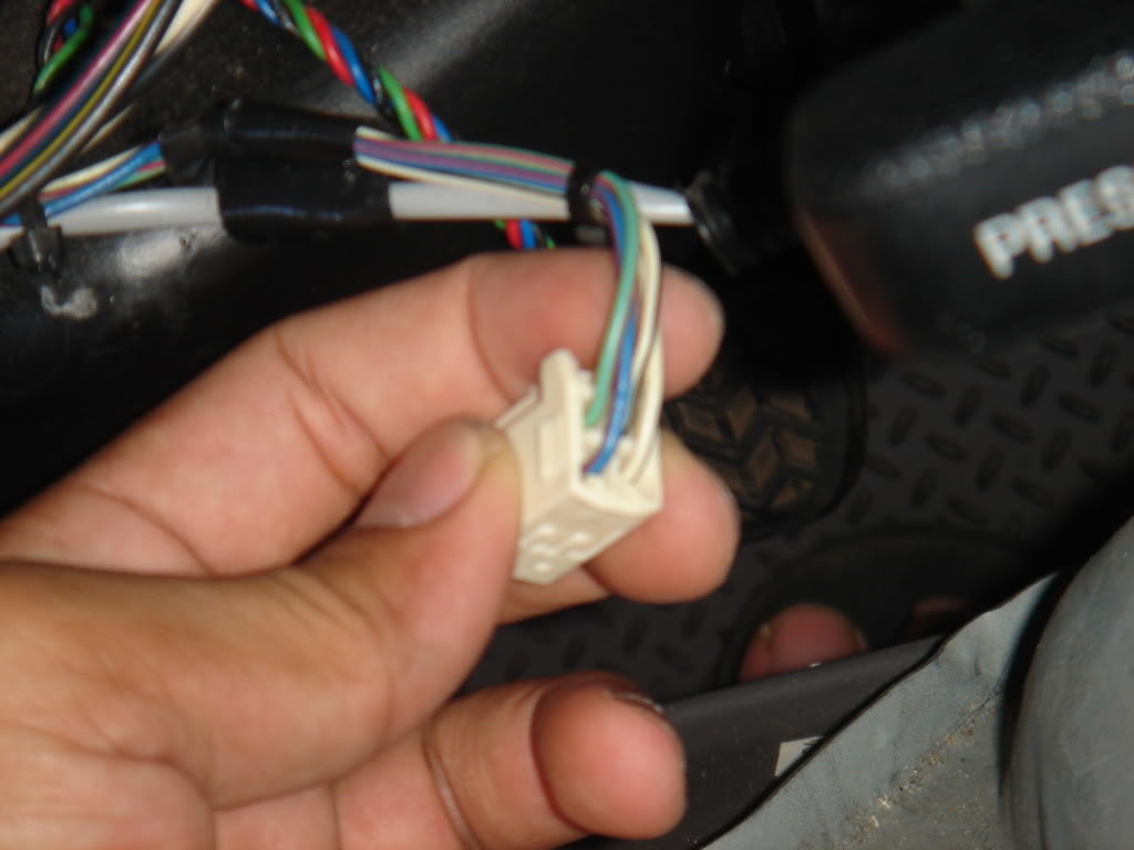

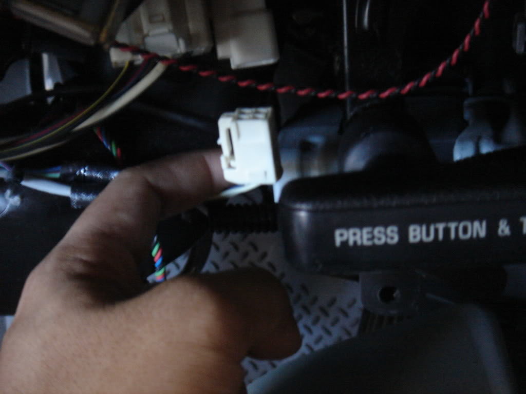

    Remove the clip from the housing like so. Leave the clip unattached.
    Here's a closer shot of the wires...
    Step 4.
    Replace the panel. Should you happen to miss the sound of your annoying buzzer, you can easily replace the clip at anytime.
    I believe the green wire w/ red stripe is for the actual buzzer, but i still haven't found out what the other 3 wires are for. I've had mine off for a while now and everything else still works fine. Only sometimes i forget to pull my keys out of the ignition. :facepalm:

    4 wires could be: 1)ground 2) key in "sensor" 3) door open "sensor" 4)buzzer
