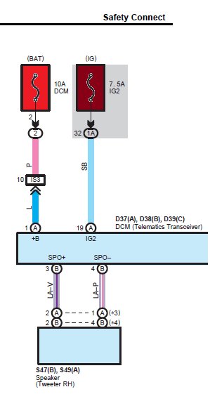

    Try searching for "DCM fuse" (the fuse is in the Fuse Box under the hood, labeled 'DCM').

    There's no "dedicated" fuse for the DCM.:burp:
    Edit: My bad:facepalm:, there is.

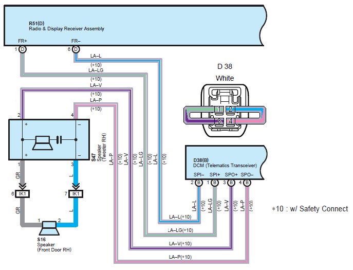

    Does anyone know where I can find the truck's 3G/LTE module?
    Also, you loose the Right Hand tweeter AND microphone if juice is removed.:burp:

    Possible use recovery of tweeter
    I don't have the connector (D38) part number to find the mating side or the terminals (pins) it uses.

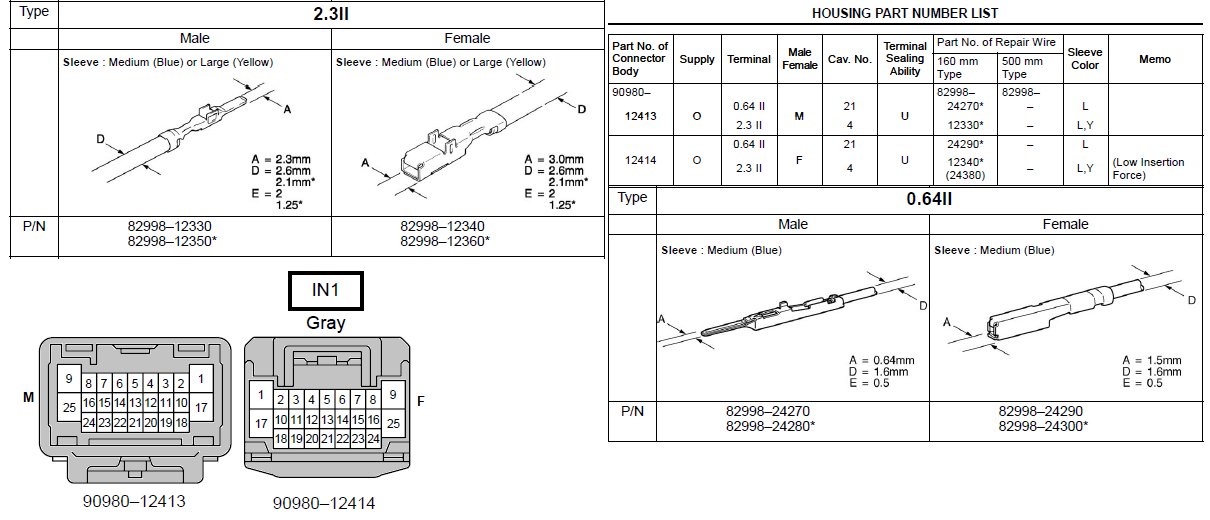

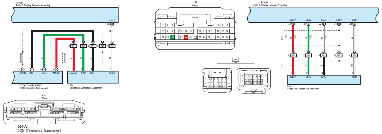

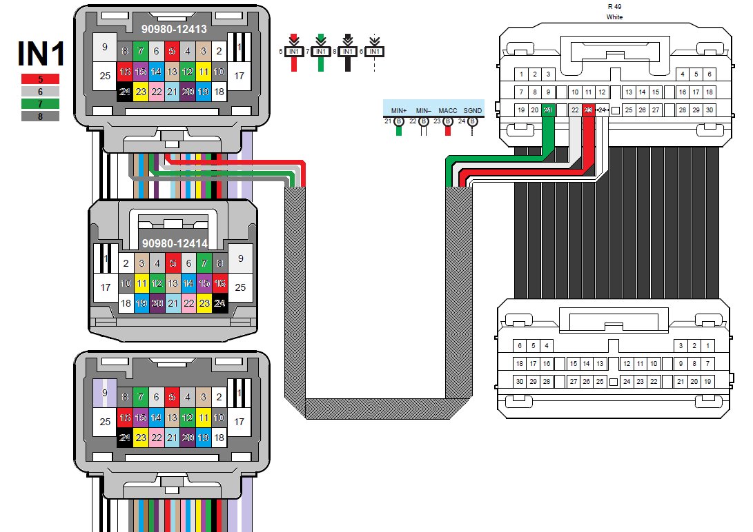

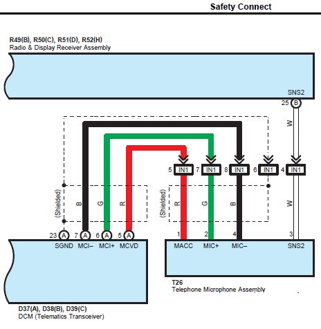

    For the microphone:
    With the smallest Posi-taps, you could recover the microphone also. From IN1, which as the driver's side "sail panel", you'd add the Posi-taps to the wires and run them to R49 at the head unit. I don't have the part numbers for the terminals it requires. They might be 025.

    Another option to "recover" the microphone:
    T-harness on IN1 to add missing wires to R49 at Head Unit. Still need the terminal part #'s for it.(R49)
    Spoke with Andrew, from Anytimerearcamera, to see the possibility of getting one made. At least the mating part from the head unit with unterminated wire ends to IN1.

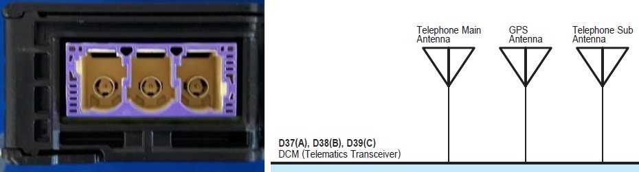

    Another way to stop info gathering would be to disconnect the antenna connections to the DCM.
    If vehicle has Nav Module, it has it's own connection to GPS antenna.

    If you have the wiring diagrams then yes, it’s fairly simple to see what is affected by pulling fuses or snipping wires.
