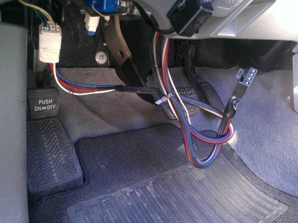

    Hey, new to this forum. I feel dumb for asking but looked for over half an hour and could not find where this wiring harness connected back into. Seemed to have come lose after getting wrapped up on my e-brake pedal. It's been off for a couple of months due to me not knowing where it plugs into & to be honest there's nothing that I've noticed to not be working aside from my Temperature/Compass display, but thought maybe one of you guru's might know! Thanks in advance for any help along the way :)

    Looks like trailer brake wire harness.

    for trailer brake lights if your towing a trailer? because i've towed a trailer since this has been unhooked & the break/signal lights look fine.

    Thanks Chris. Actually found that thread while browsing the forums earlier so if i can find my soldering gun i'ma tackle that later today! Now if we can just find an expert on tacoma wiring haha. This thing is going to drive me nuts :p

    x2. for the trailer brakes, not the lights.

    What do the wires that trace up behind the dash go to?
    Leaning towards the trailer brakes myself as that is not a stock Toyota connector to my knowledge.
