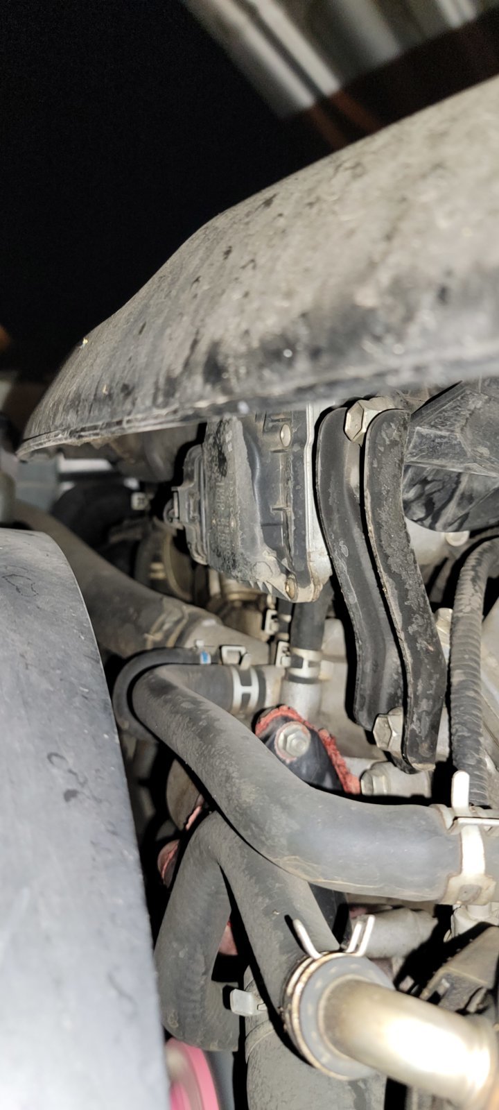

    Ok haven't had a lot of time to look at this leak, but.. from what I found from a Google search that got me to this thread...
    https://www.tacomaworld.com/threads/losing-coolant-cant-find-the-leak.478074/page-2
    The first pic with the pink build up on the water pump... remember that.
    After more browsing Google and possible leak locations I decided to go look at it tonight with a flash light, thinking if something gets wet I could see wet "reflection" better with a flash light. While looking around I noticed my thermostat housing covered in pink build up, just like in that pic before. So, I think I've found my leak... of course I'm going to look deeper and check the water pump weep hole. But I think im on to something here.

    I inclined to believe that the pink crud isn't RTV of some sort. From what I've read, these are put together with none of that from the factory. Since I've been the only owner of this truck and know that the thermostat housing hasn't been touched at all for the life of this truck, im betting on the leak being there.
    I've only had to add a few ounces of coolant, so I'm still driving it for now. I'll get it broke down next week on my days off and fix that particular spot, and probably go ahead and do a flush and refill while I'm at it.

    Just a suggestion - wipe off the old crust on the housing with a damp rag and see if the crust re/appears.
    If it does = you found your leak
