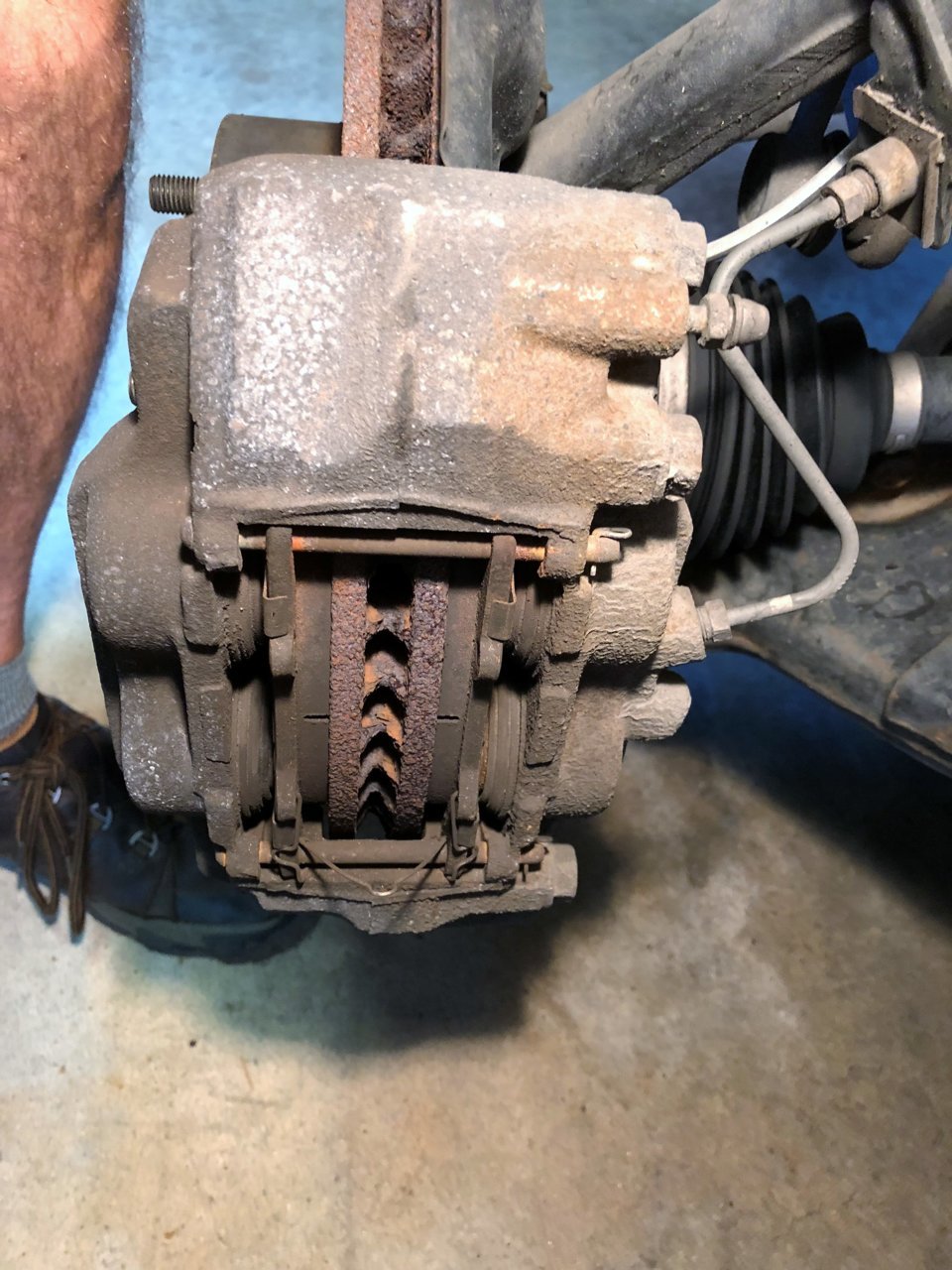

    Had a couple days for open window driving and noticed a rhythmic squeak from front driver side wheel. Can only hear it when drifting along a sound reflecting source, like the trees in my driveway. Sounded like brake pad, maybe touching a high point on disk. No noticeable pull, no noticeable slowing of the drift. But clearly there.
    Jacked it up using a tried and true scissor jack out of a long departed 1971 Datsun 240Z that was much handier than the jack under my pup's platform in the Access area of my 2010 SR5

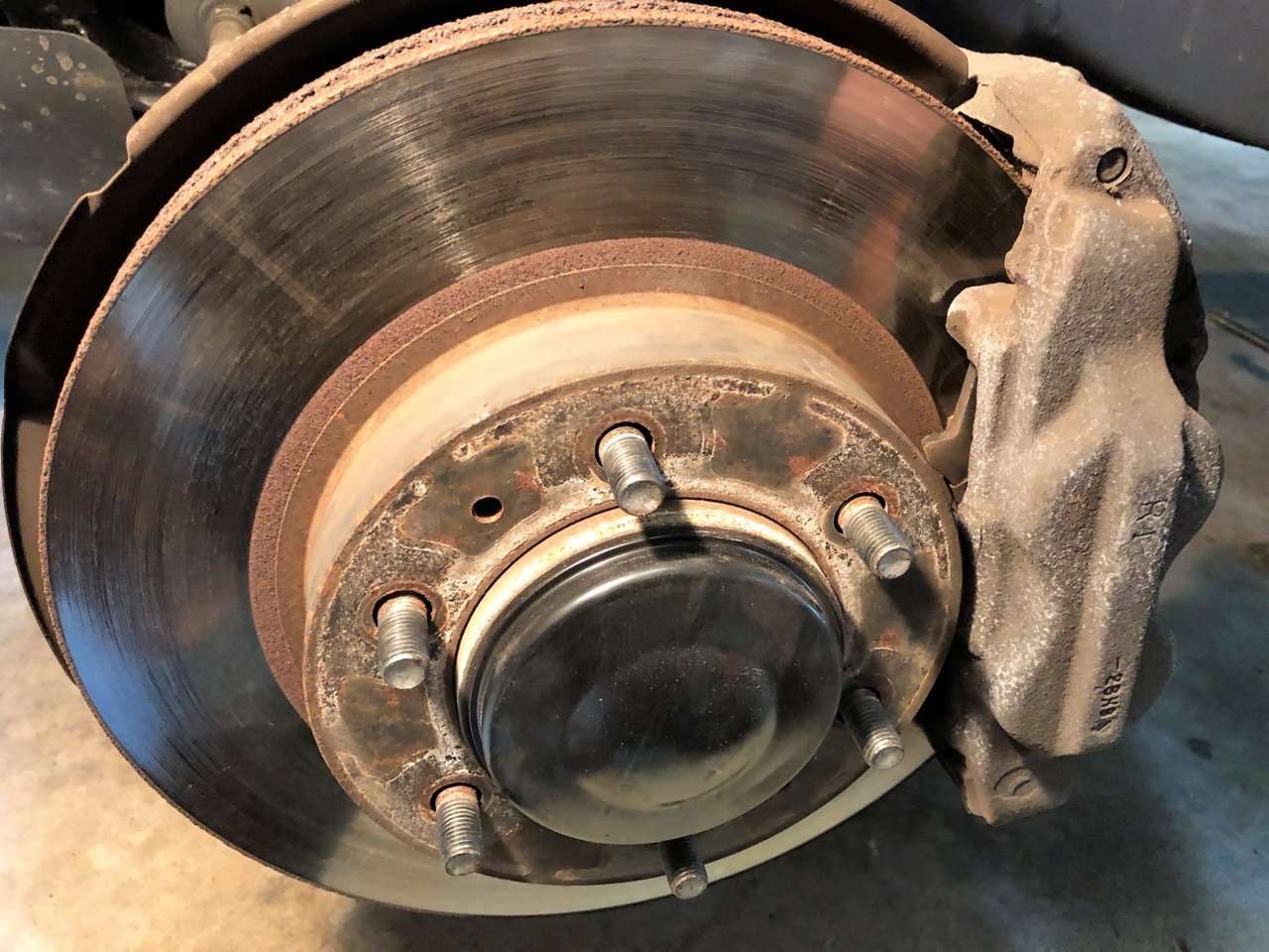

    Found the tire turned with noticeable drag on the brakes, pretty much all the way around, though there was an obvious tighter spot, I assume where there is a high spot. Wouldn't squeak, probably because I wasn't spinning it fast enough.
    Pads look fine, disk looks fine, no undue wear on either.
    I know there is no actual mechanical force to retract the pistons/pads, but general turning, disk flex on steering (front tires/wheels at least), possible high-spots should back the pads off to allow easy turning. But, how easy?
    I don't do this kind of thing, so I am not sure if I am being overly sensitive, or if there is a possible problem with the pistons being corroded and not easily returning after braking. I also carry all my limited brake job experience from pre-ABS, so again, not sure.
    Anyone recently done their pads, or pulled the caliper off, or removed, polished, lubed, and returned the pistons. Anyone see anything that I don't?
    Thanks for any assist

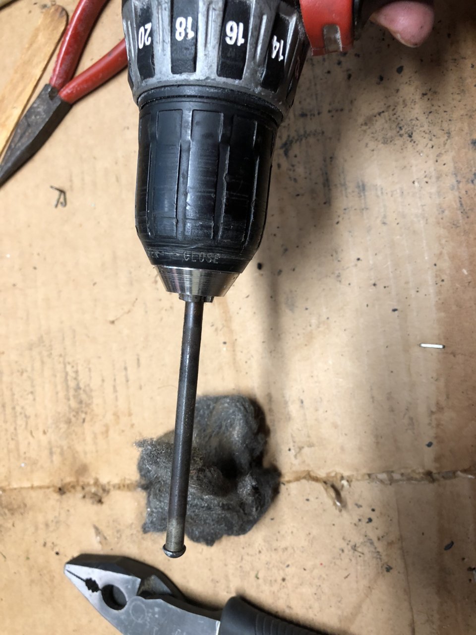

    Well, thanks for the guidance. I pulled the pins, it was not hard, I pulled them with my fingers. Since I had them out, I put them in my drill, and spun them in steel wool to polish them and remove the rust.
    Then I greased them with brake component grease to stave off the next 100k miles worth of rust, slipped them back on and verified they were free.
    Unfortunately, that did nothing to resolve my brakes dragging. So, It occurred to me that the last thing I did before jacking the truck up to inspect these brakes was to apply the brakes. Maybe I should coast into my garage and use the emergency brake (on the rear drums) so that the front disk brakes are in their normal driving state. I suspect it might be better/free-er spinning. As it is, with the wheel jacked up I can spin the tire/wheel about one rotation before it slows to a stop. I'll try my next idea and let you know what I find.
    Thanks again

    I just did my brakes (again) this weekend. New rotors/pads. My pads look about as close to the rotors as yours do but i don't get any noticeable rubbing noise.

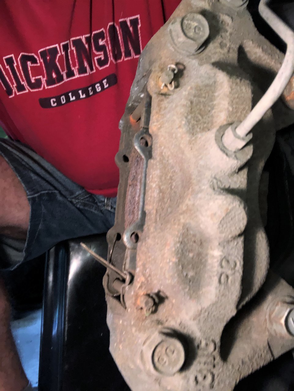

    Looking at your pictures from about 2700 miles away, while being a little buzzed and lit..... I would suggest new pads, rotors, calipers and bleeding the system...and you might as well look at the rear brakes.
    That caliper looks like its off of a 30+ year old vehicle thats been sitting in a field for 10yrs....
