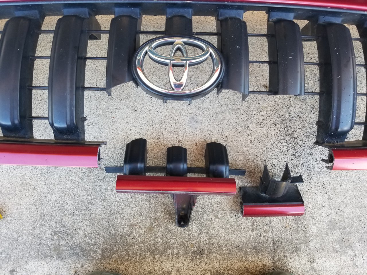

    Ended up cutting the grill. Too much work to try and stuff the solenoid box under the hood, so out came the hacksaw: had to cut a little extra to make room for the plug.
    Finished product with working turn signals (and winch).

    Only reason I did that was so I didn't have to futz with relocating the solenoid box. I believe the x20's have a removable box. If that's the case, you just need to get some longer wire and find a spot for the box. The size of the winches themselves are pretty much the same.

    Mine is an XBull, there are some pics of my location for the controller back earlier in this thread. I also had to clock the lever for the engage to clear grill. Easy to do.

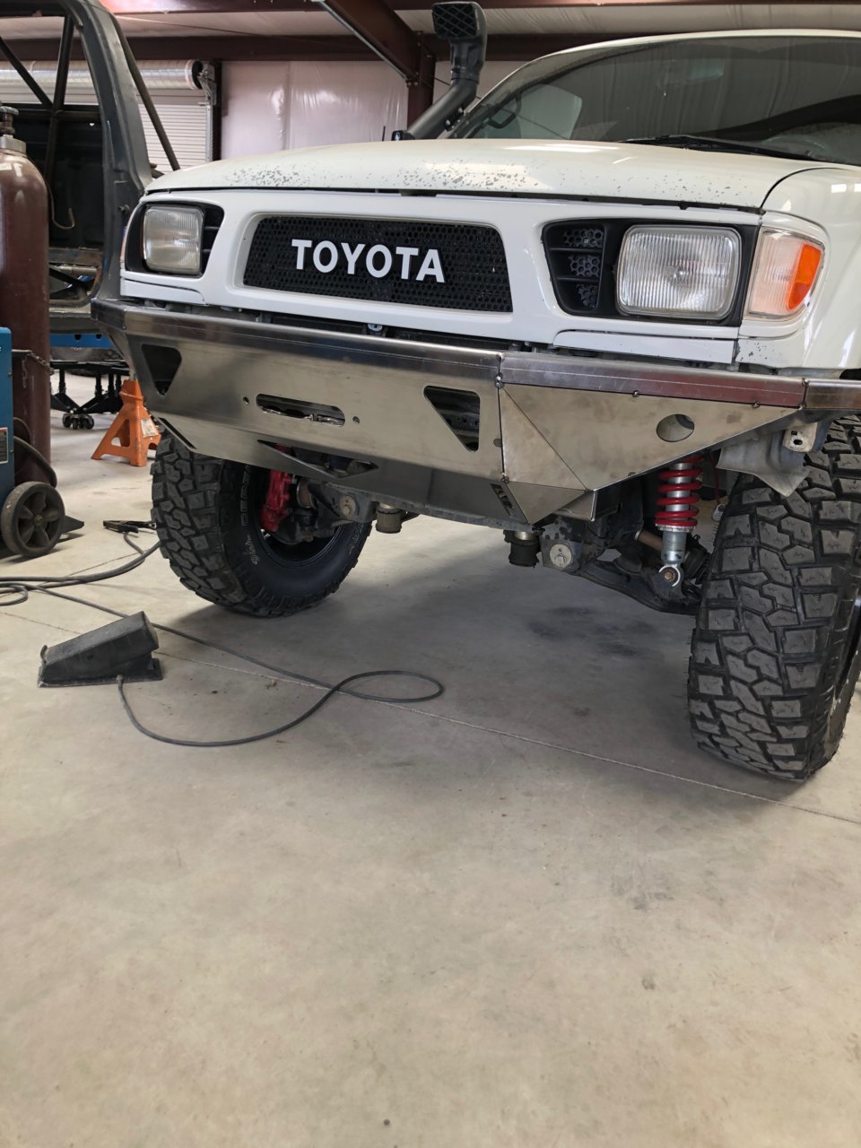

    Was sent to me earlier today from the welder 570F2188-E514-4FD4-9766-939D26670774.jpg
