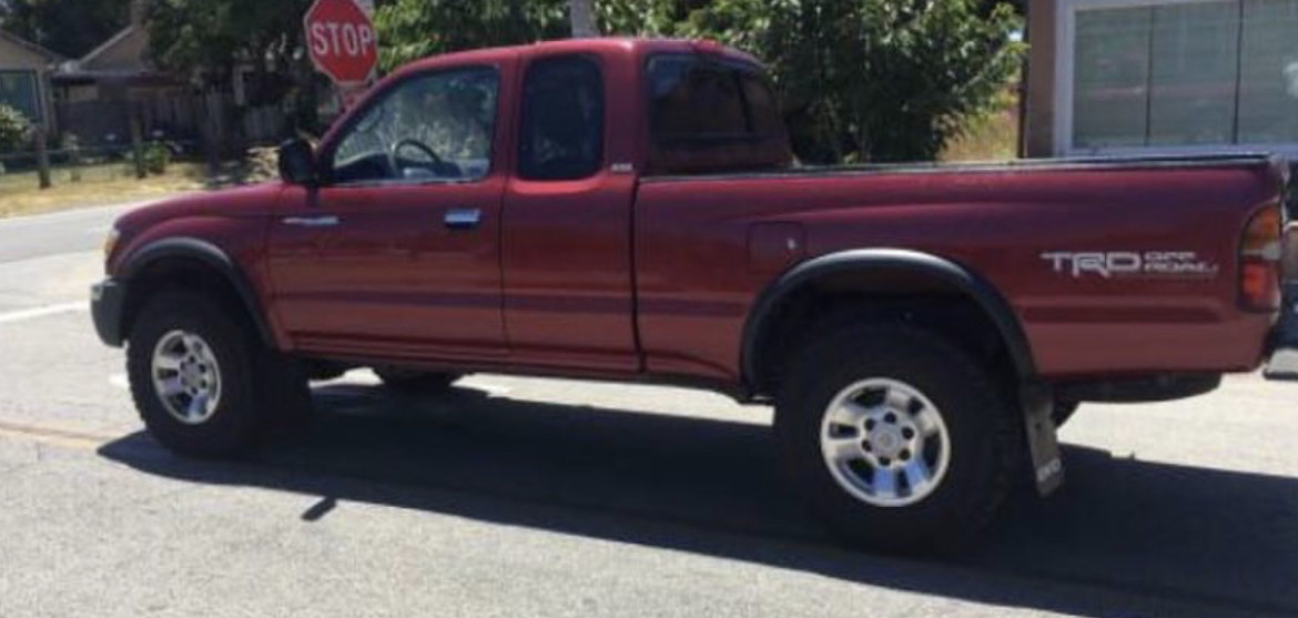

    I am going to build a front and rear bumper along with sliders, I have no experience working with metal in this way.
    I have no tools but a plan. I've done all the research now it's time to start making moves.
    Plan: buy everything nessesary, practice welding, metal working, tube bending etc... Then build.
    Before:

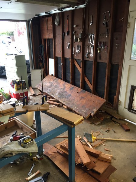

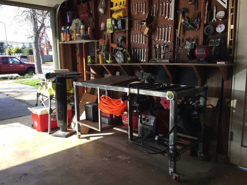

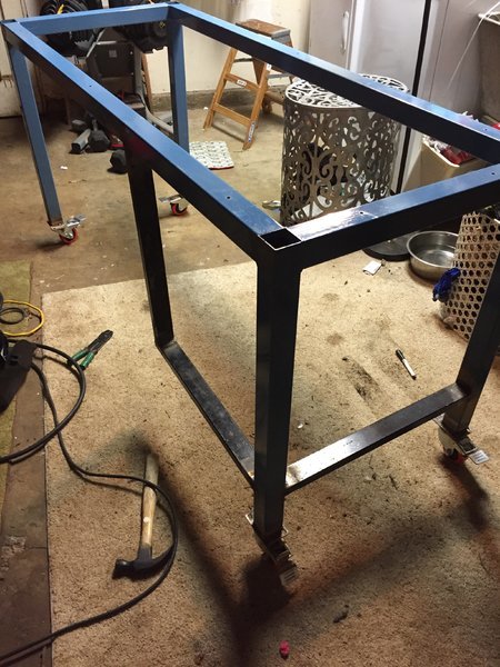

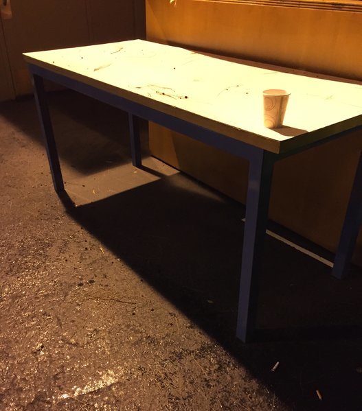

    Just a quick update for the build needed to make some space to work. I saw this old table with a metal frame outside my work. Got the ok and took it. IMG_3017.jpg
    Removed the top, Bought some nice wheels with locks.
    Found some scrap tubing and begun framing.
    Needed more room in the garage so demolished the outdated tool bench
    Found some more scrap metal and continued framing. Added slates on the right side so I can use C clamps. the left side will house a wood top salvaged from the previous desk that will slide back and forth. Cleaned up and organized and boom!
    Just need to cut and fit the wood top. Stoked on the final result. Everything is there welder, air compressor, grinder and misc tools even got hooks for my masks. The work bench can roll where it needs to go. A power strip is located behind the air compressor. So I guess gotta run one extension cord for all the tools. This little project was perfect for learning my settings on the mig.
    Next step, tube notcher purchase. Also debating making sliders before the bumper. Just looks easier and more cuts allowing for more practice.

    Just a hint welding and a wood top don`t mix well!!

    What do you mean wood is an excellent conductor! No welding no will take part on the wood side, and I don't need it to look fancy so it ok if it gets fried.
