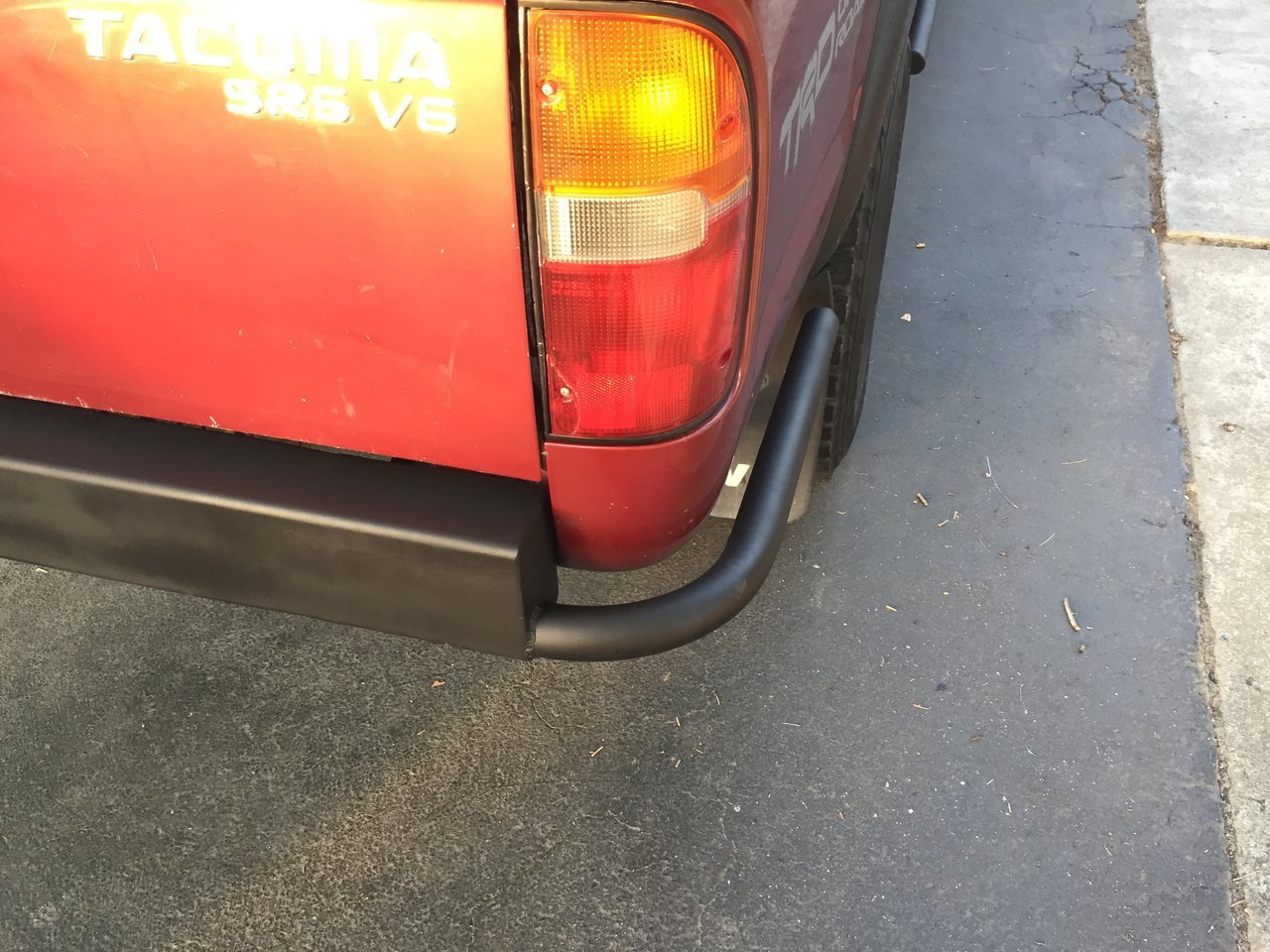

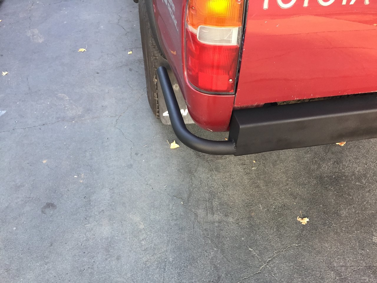

    Finished the first part of the rear bumper, just kept it simple, inspiration came from
    @Box Rocket
    Adding a OME lift kit with light racing uca's, also picked up SCS F5's and purchasing new tires.

    I want to make something like that!

    It was pretty straight forward, I kept the stock bumper mounts and reinforced them .

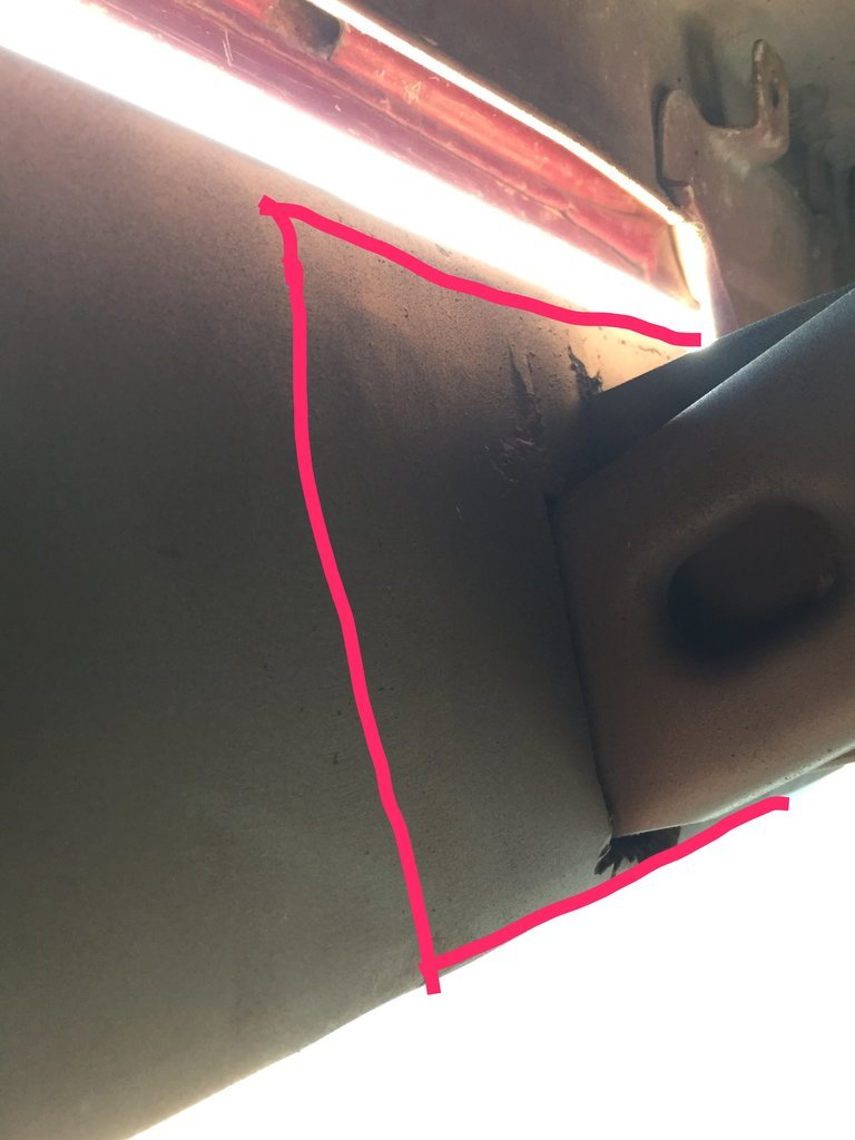

    Can you post some pictures of the mounts.

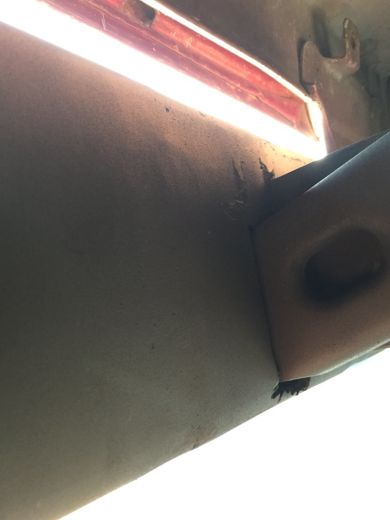

    Sure, just to explain the process, I removed the original mounts from stock bumper, and bolted them to the frame. Cut two big sections out of the 3x5 tube where the mounts are located and sat the mounts inside the 3x5 against tubing. There is big offset so, I slowly trimmed the mount till I got the fit I wanted. Then laid some tacks, removed the 3x5 with mounts attached. Reinforced with 3/16, took the pieces I cut out of the 3x5 and cut holes for the mounts and enclosed the end of the mounts inside the 3x5.

    @Dan8906 It's not pretty, but I wanted to get the bumper on before school started up again. I'll go back and clean it up when I add the swing out. Plus no one will see the backside of the bumper ahah
    Here you can see the mount insert and it goes all the way to the back wall. So a good portion of it was cut out you can see a little blending. IMG_0182.jpg
